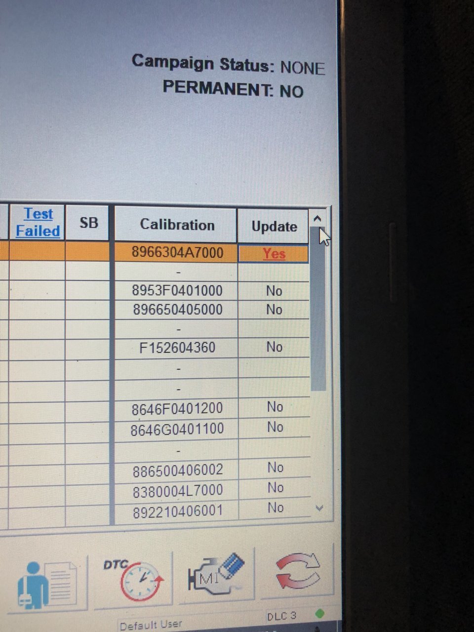

    Hey y'all. Anyone in Utah can forget Mark Miller Toyota. I took my truck in and they say it's operating normally. I even pointed out that my ECU calibration is listed as needing an update. They called Toyota service and they told the dealership to absolutely not do it because this update is for automatic transmissions only. I asked again why the TSB has manual transmission ECUs listed as needing the update and they said they can't answer that.
    The incompetence on the part of the Toyota engineering staff is beyond frustrating.

    I took mine to Toyota of North Hills in Pittsburgh. They didn't do the update the first time because it says AT only. I had my rep call the service guy to the desk and showed him the manual calibration ID's and that they mis labeled AT only. He was like " I didn't even read back that far", which is fair since it says AT only. So he said he was there the next day and to bring it in and he would do it. Sure enough he did and I have the paperwork to support just cant upload at work.
    On the drive ability aspect of the the update. The power band is much improved and gives the gear changes a much smoother transition. Almost feels like a different gearbox when you drive it for the first time. There are still a few little lugs/surges on hills, but that could be my rear differential (not quite sure). Overall, I love the update and i'm glad I did it.

    I had a long chat with the tech advisor. He told me he did the healthcheck and it shows I have 04A70, which I pointed out in the TSB shows as needing updated to 04A71. He says he saw that and called Toyota technical support and they said that he shouldn’t install it. He could not elaborate as to why manual ECUs are listed in an AT update. The dealership was nice and even gave me a loaner car to use while they checked it out. Part of me understands why they can’t do it. It’s Toyota’s fault. Not the service department’s fault.
