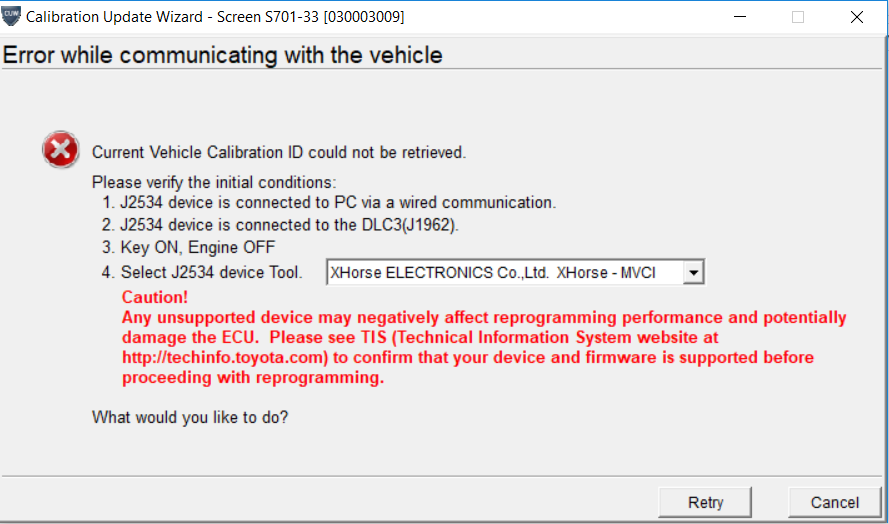

    The only time I received that error was when I had me key to the accessory setting and not the "on" setting. Other possibility is that the cable is not fully set someplace in the connection (or possibly damaged in the middle).

    That's due to the cable you're using. I ordered a Mini VCI cable and it didn't have all the functionality that was necessary. I got communication errors with a few of the functions that I tested out before attempting the update. I still want to do some more testing on it though.
    Anyways, I ended up using a Tactrix cable to do the deed.

    I got this error on my first try because TS was looking for a different default cable. Once I picked the Tactrix interface from the drop down, I had no issues. The setting stayed for the next use.
    I'm guessing that it doesn't like your cable for writing to the ECU?

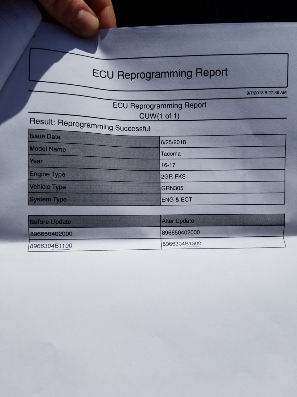

    *I had already posted a successful update earlier but forgot to thank everyone.
    THANKS EVERYONE!
    Here's some additional data that may or may not help others
    I have both the MINI-VCI and the Tactrix cable
    Already had TS 10.30.029 and the MINI-VCI working
    Upgraded to the TS 12.20.024 linked earlier in this thread and TS still worked as it should using the MINI-VCI. No comm errors
    Didn't have the nerve to be a guinea pig and ordered the Tactrix cable
    Updated from 04B12 to 04B13 with TS 12.20.024 installed, the Tactrix cable and the provided .cuw file with zero issues
    Both cables work fine and communicate through TS
    In TS, under Setup, VIM Select... the two different cables show as follows:
    OpenPort 2.0 J2534 ISO/CAN/VPW/PWM (Tactrix)
    XHorse - MVCI (MINI-VCI)
    All running on an older Dell laptop, Windows 7 Pro SP1, 32bit. This laptop was wiped and purpose built for just this, it only has TS installed
