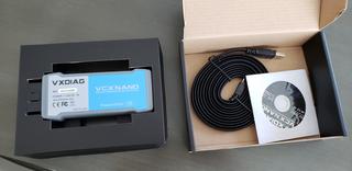

    This arrived today. Will give it a shot this weekend and report my results.
