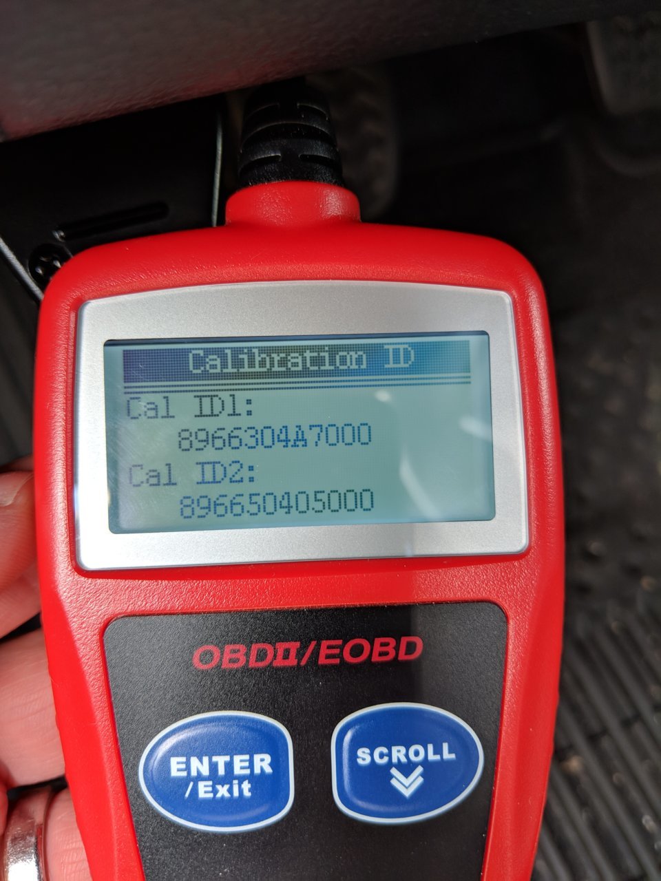

    what build date was this corrected on for the '18s?

    Mine was built in May '18 and had the old calibration (8966304A7000).

    I've read through a ton of this thread, but haven't seen an actual pdf of the tsb for the manual. Does anyone have one?

    The only TSBs state automatic. One of them has manual calibration codes in it. That is where all the confusion comes from.
    That being said, the update installs on the truck fine and it did several improvements (depending on how old the truck is determines how noticeable).

    The TSB itself is attached to the OP. If you open the CUW files in this thread in MS Notepad, you can see the ECU numbers in the header data.
