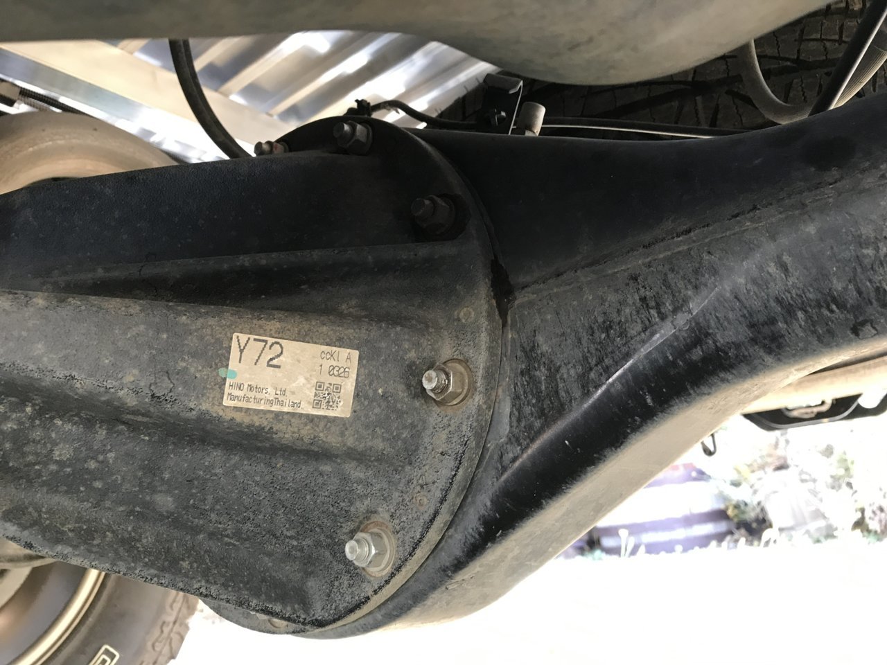

    After a lot of pushing last week I got the TSB. To be honest I’m not noticing a difference.
    I also had a question about my diff seeping oil. 50B8B73F-74C6-4CD3-BD79-66F7CFBCE25B.jpg
    They said this was normal!
    I’m at 12,000 miles. For the hell of it I replaced the transmission fluid with MT-90. The weird thing was that I only got 2qts out and it took 2 and a 1/2 to fill.

    that's a good thing that you're not noticing any or much difference after the TSB. your stuff was pretty good to begin with, then.
    your diff being low 1/2 qt is common. at least around here those are the reports from users who speak up. mine was also about 3/4 qt low when i put in some Amsoil.
    the truth about that diff seep is that you'd likely get different responses from different SA's or dealers. keep an eye on it, and if you have other dealers local and convenient maybe hit one of them up and start fresh. don't mention another dealer would do anything, just see what they say and maybe you'll get it taken care of.
