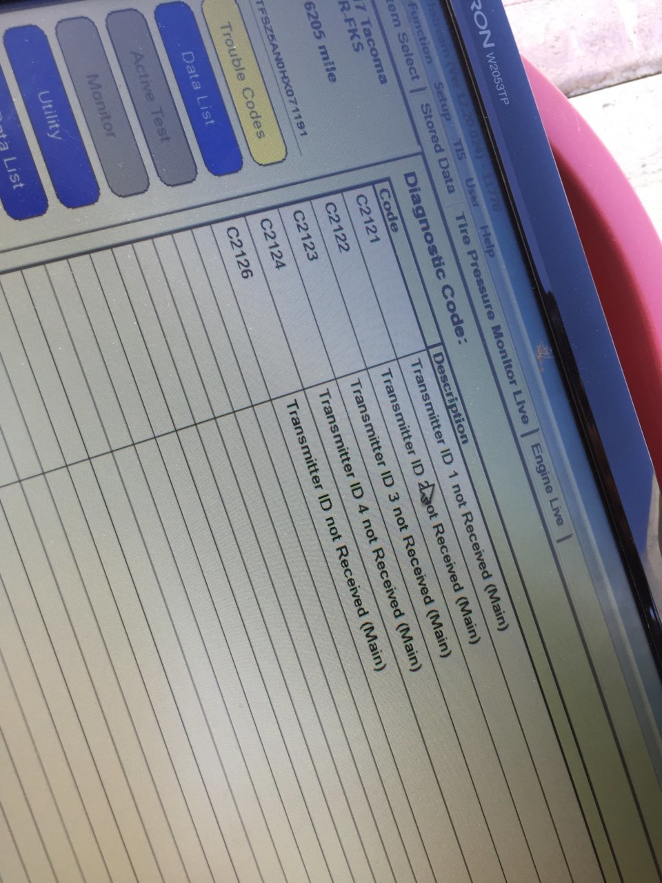

    actual install time was less than 3 min. About 2 min worth of pre install checks. Very easy. Took me longer to get all my hardware setup, including buying a used laptop with a non-functioning screen, Tactrix cable, VGA cable to run between a monitor and the laptop and extension cable plus surge protector.

    Yeah. I waited a week for the laptop to arrive and came with a worn out LCD screen with the white screen of doom. Luckily I had my old Desktop monitor and plugged in just long enough to get the update installed.
    Our garage was full junk so I ran the extension cord with a surge protector from the garage to the driveway. I had the the laptop sitting on the driver seat and the monitor laying flat on top of a laundry basket so I could see what I was doing standing directly over it. You can see part of it in this pic.
