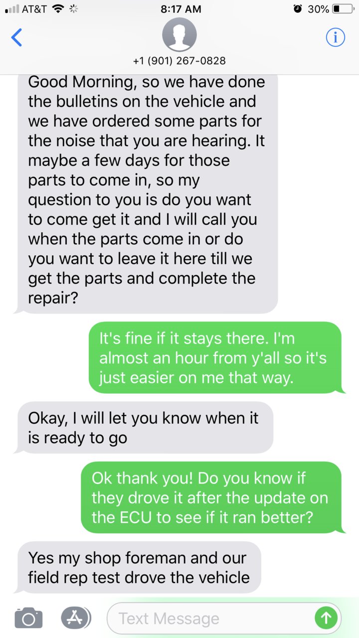

    Well they say mines done. Just waiting on parts for other issues.

    Do you care to share what the tech told you?
