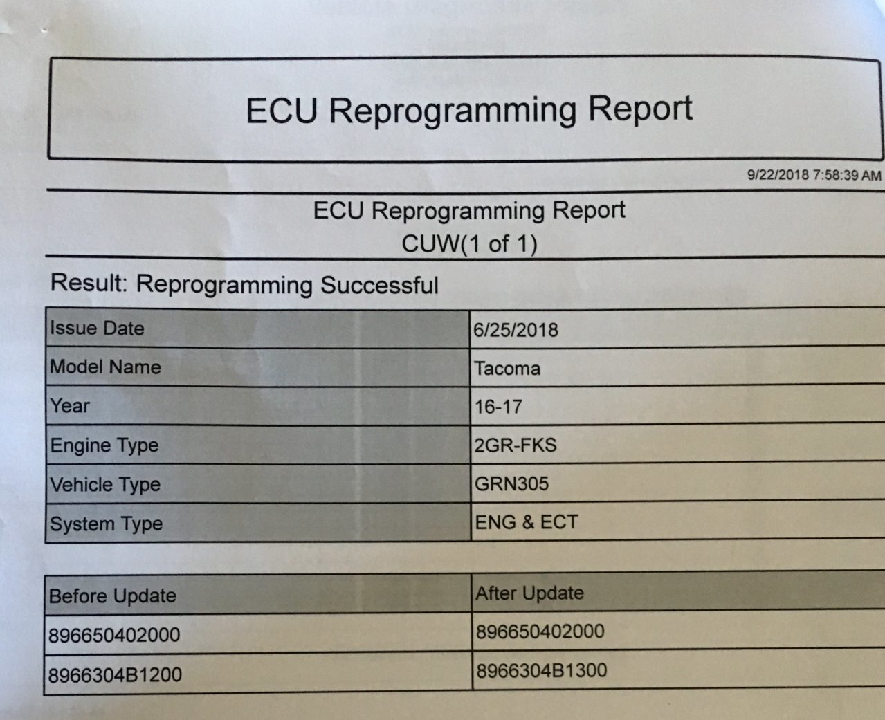

    Well... They did it!!! Simply told them there was a ECU update and gave them the existing and replacement calibration ID numbers and said it could be found running a health check through TS. After it was ready they even said they added 40mph surging symptoms to the report so that Toyota would pay for it. I am blown away!!!
    First impressions on the drive home were great. Much smoother acceleration after shifting with more throttle response. Smoother shifting in general especially noticeable from 1st to 2nd. Really does drive like a different truck. Wasn't sure believed all the hype but wow. Was considering OVT but for my needs...no reason.

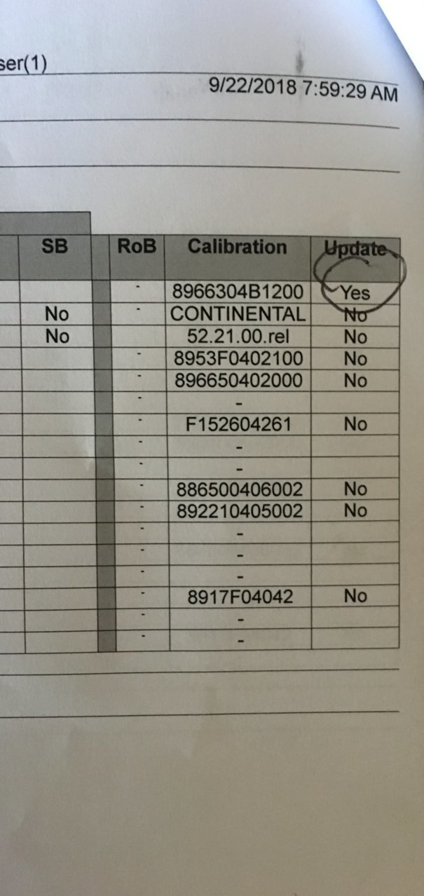

    Just got back from Toyota of Naperville for my 10k service and mentioned an ECU update. Told them I felt a surge between 1st and 2nd and there should be an update if they hook it up to TS. They did the update, albeit with a different TSB number than what I've seen here with no questions asked nor road test.
    Happy to report the 1st to 2nd shift is much smoother, the bucking in low RPMs in nearly eliminated and driving is generally more pleasant. If anyone in the Chicagoland area needs it done, I suggest going here.
    MOC221_ and tonered[OP] like this.

    Anybody able to get a look at the docs for 125-18? Could be they got their poop in a group and put out a new TSB, that’s the highest 2018 TSB number I’ve seen mentioned anywhere.
    tonered[OP] likes this.

    Nice work. Thanks for posting all the pics.
    Agreed. Hopefully someone has TIS access to pull it.
