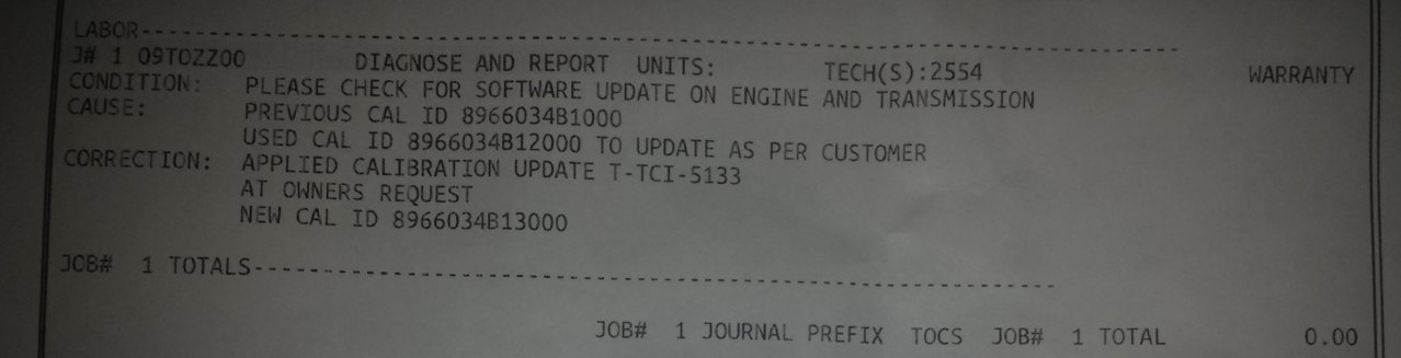

  15. Sep 23, 2018 at 2:05 PM
    #1915
    shiftz
    shiftz Active Member
    Dec 16, 2015
    #172410
    25
    GTA
    '19 DCSB 6MT Sport
    Wording used by Canadian dealer in case it helps...
    specter208, Apaci7, Taquitoma and 3 others like this.

    K
    Do you think you could get a hold of the PDF file for TCI-5133
  17. Sep 23, 2018 at 6:31 PM
    #1917
    shiftz
    Dec 16, 2015
    #172410
    25
    GTA
    '19 DCSB 6MT Sport
    shakerhood likes this.
