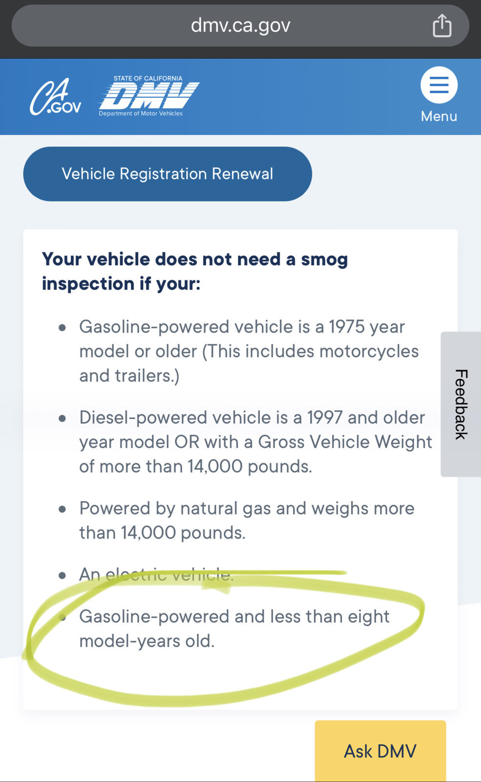

    I think our trucks aren’t old enough yet to warrant smog checks in CA. Soon.
