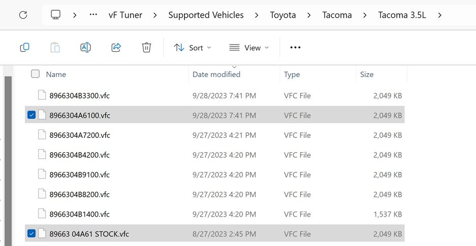

    The software wasn't/isn't "faulty". At the time the OP/OTT went through this ordeal, the "stock" files in the VFT directory contained custom encryption to limit other software companies from stealing VFT's work/mapping. This additional encryption alters the checksum/CVN. This encryption and non-OEM CVN was unknown to VFT users at that time. We would not have sent the OP to retest if we had known about the encryption/non-OEM CVN.
    We were very involved with VFT to bring the "new files" to software so this would not lead to widespread issues where folks would have to resort to the measures taken by the OP to pass their inspection. The files in the VFT directory dated after 9/27/2023 (at the time of this posting) are what we dub "true stock". Meaning they are stock files that will report the appropriate OEM CVN.
    Any tune, or rather any single change made to the files will alter the CVN and thus will be flagged. There is no legal way of getting around this. If your location is checking Cal ID/CVN, you must return to a 100% "true stock" file to pass emissions in your area.

    @JustDSM - Do the new STOCK filenames include STOCK within the filename or not?

    The naming convention used for the file name isn't of any importance honestly (aside from it correctly identifying the appropriate Cal ID). The files dated on or after 9/27/2023 (or others that he may add after) would be what you'll need to flash to go back to "true stock".

    Again, any single change to the OEM calibration will change the check sum/CVN. There's no hiding or getting around that. Example: If you changed nothing else but raising your idle speed by 1RPM at -40deg C, your CVN is now different. If your location checks CVN, you will fail with just that change.
    The 2G VFT files do not contain the encryption that the 3G files had, so flashing back to stock via VFT on a 2G is a non-issue.

    Were you able to demonstrate a successful flash back to stock with a proper cvn?

    Yes sir, using the files dated 9/27/2023 or later.

    so essentially any tune done after 9/27 should be able to be flashed back to stock and pass emissions...theoretically?
