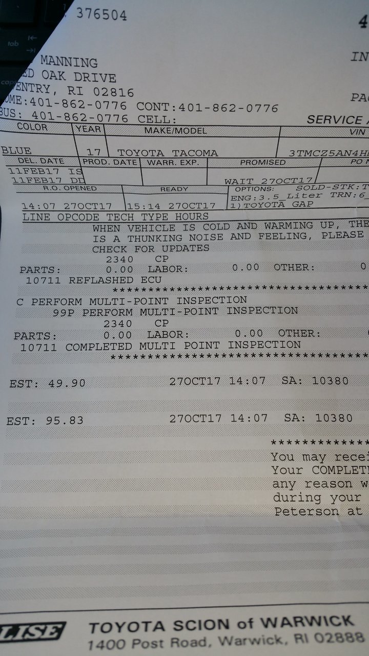

    Mind posting an image of your last R.O. or receipt from the dealer describing said ECU update?

    There's no description, which is why I was hoping someone might have the details.

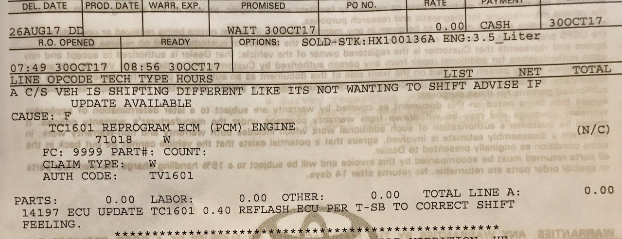

    i actually went in yesterday for some weird shifting problems, they reset my ecu and updated it, but my question is, is this the new one?ecu picture.jpg
    it feels alot better now and holds its shifts nicely.

    Is this really a new update? Or is it 04B03?

    That definitely looks like the TCM update. Especially since its paired with a transmission complaint issue. I think their software has it grouped or coded with an 'ECU' code in the description.
