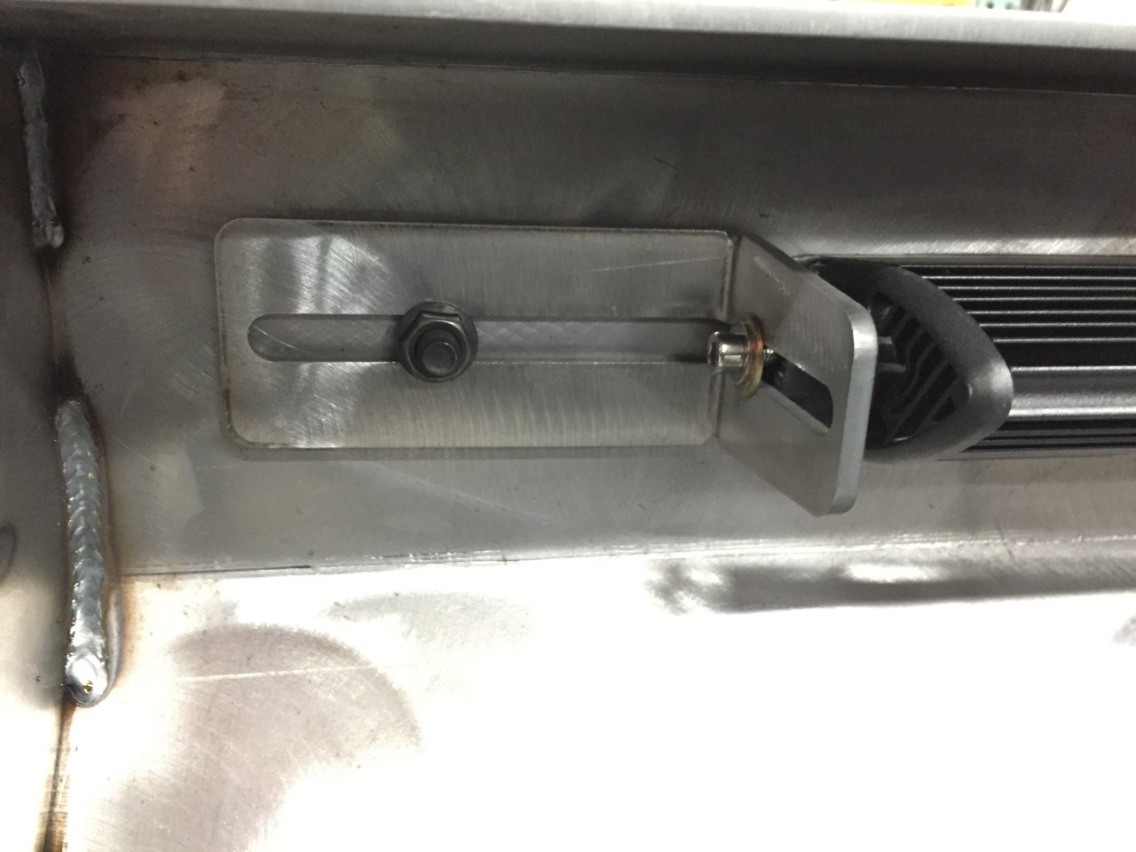

    Im excited to see the swing out. So far so good. Hey @At The Helm is there a reason you do the bolt on light bar mounts instead of welding a mount into the bumper on the front bumpers?

    Definitely. The reason I do bolt on light bar mounts is because no two brands ‘20 inch’ light bar has exactly the same width between the mounting points. My mounts are with adjustable to give you flexibility, no bending tabs or shimming them to fit like other bumpers.

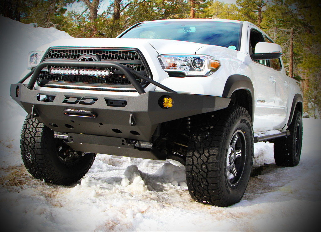

    Demellos great but for some reason they don’t go low to protect the bar the bumper mounts to. Look at pictures. It goes skidplate, bar, bumper. Literally every other bumper company protects it except demello

    We don't bring the bumper down because we want to leave room for all manufactures skid plates. Some come up higher than others. Most fit with ours but there are some that come really close to ours to fill that gap. We run budbuilts and you can see in this picture where it almost touches. I think at one point we hit the bud built skid and it rubbed. 2016tacomacover_zpsgd5qmaup_adf32a309aae088102fe0a202746c2fcfc2f7261.jpg

    Wasn't bashing on Demello its just a different design, @JDEMELLO didn't even think about the skid thing but it makes sense. And let's not discuss All Pooh here.
