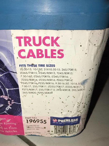

    1: Dealer told me not to put snow chains on but where I'm going requires snow chains. Will this be okay?
    2: The snow chains has a list of various sizes. The closest one being 275/60/17. I'm assuming since it's adjustable it accommodates various sizes. Will I be able to adjust it to fit the stock P265/65R/17 tires?

    The picture of the box, purchased for last vehicle but it hasn't even been used so I don't want to go out and buy another if possible.

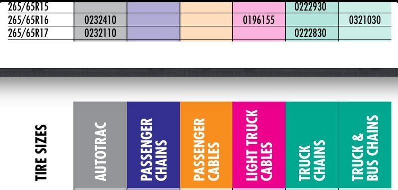

    My googlefu is weak today. Can't find the full fit list for that part #. But this is the current list that fits that size.
    It's always a good idea to try them out. Make sure they actually fit. Do it on a nice clean driveway instead of on the side of a snow covered road.

    Found it. It does not list a LT cable part # for that size.

    According to the list Walmart has for Peerless, it won't work.
    I'd suggest going to the Autotrac. If you aren't expecting to use them on a regular basis, they are good. Self adjusting and take up less space. Just give them a good wash when you get home.
    Still check fitment of whatever you use before you actually need to put them on.

    5100's
    Those chains will fit. 265/70R16 is the same as 265/65R17.
