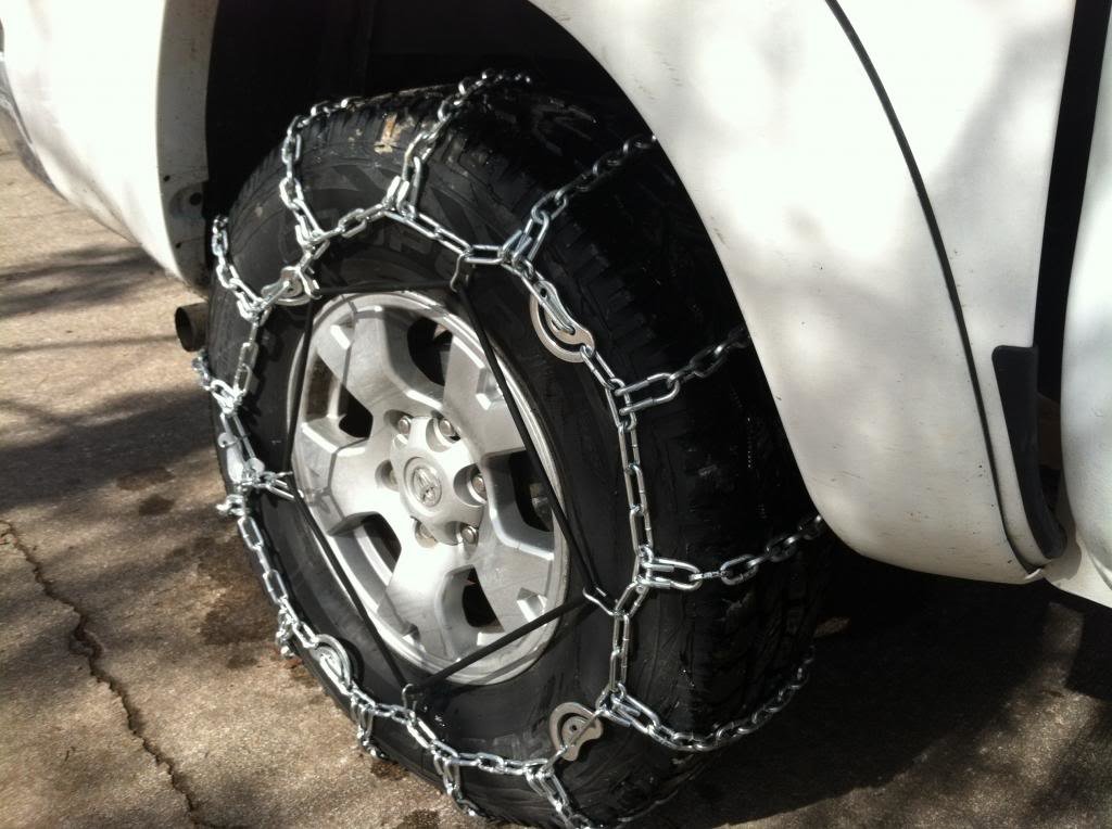

    This company is good to work with.
    http://www.tirechain.com/
    I chose these. Some chains require more fender clearance, but these are designed to work in cases where the tires are closer to the fenders.
    http://www.tirechain.com/square_alloy_cross_chain.htm
    I hear good things about these. But they are not recommended for mud and I wanted the option to chain up in muddy terrain as well.
    http://www.tirechain.com/DIAMONDSTYLECARCHAINS.htm
    Cables don't suck. In fact in many cases they work much better than chains. Here in N GA we don't get a lot of snow. When we do it is often 2-4" and is as likely to be ice as much as snow. The problem is that they only clear major roads. Not enough equipment to get back roads where I live. We just wait a few days for it to melt. In the mean time steep hills are impassable without chains/cables and you'll have long stretches of clear pavement where sun hits it and long stretches of icy conditions in the shade. Nothing worse than snow that partially melts in the day and re freezes at night. If you're driving in mixed pavement and ice cables do far better when you have to drive on pavement. And in 4" of snow or less do just as well as chains.
    I have cables that get used more often. I have the chains for hunting trips to western mountain states and those rare deep snows in the south. Driving on dirt roads that have frozen and then thawed is as muddy as you'll get. Chains in this mud does far better than even the most aggressive mud tire.
