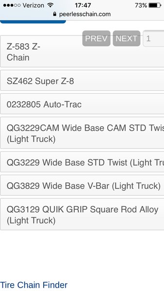

    Anyone know anywhere to get 285/70/17 ? I got some CHains from 4wheelers but they were like 140.
    Question 2 I've been reading chains are bad for 4x4 and cables should be used in the rear wheels ? What if chains are the only avail for tire size? And last Do u continue to use 4hi with chains ? Or go on 2w

    You want chains or cables? All these Peerless models fit that size. Then go find them on Amazon.

    Which brings me to my next question! And thanks a lot guys! Is chains bad for 4x4 or it doesn't matter? I read it's bad for 4x4 and cables should be used instead ?

    I use cables because of their snugness around the tire. Chains have lots of play across the bands. Could potentially rub the wheel well.

    Probably chains then lemme look em up thanks! And do you still run 4hi when on chains or just do 2wd?

    Opinion alert:
    YMMV
    If I need chains, I am slow and in 4wd. Chains mainly serve the purpose of stopping. Going is much easier without chains.
    Cables are easier to use but much less aggressive. They may work for what you want.
    Some vehicle manufacturers have specified the requirement of "S" class chains. Like my Subaru. They are cables. I cannot use chains on the Subaru without damage.
    I have only used chains recently on the T100, not the Tacoma. I chain the back and cable the front because of clearance concerns. I cannot chain the front without damage, so I use cables.
    I do not leave any loose chains to flop around.
