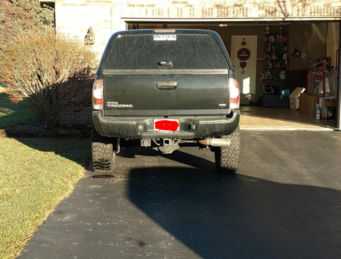

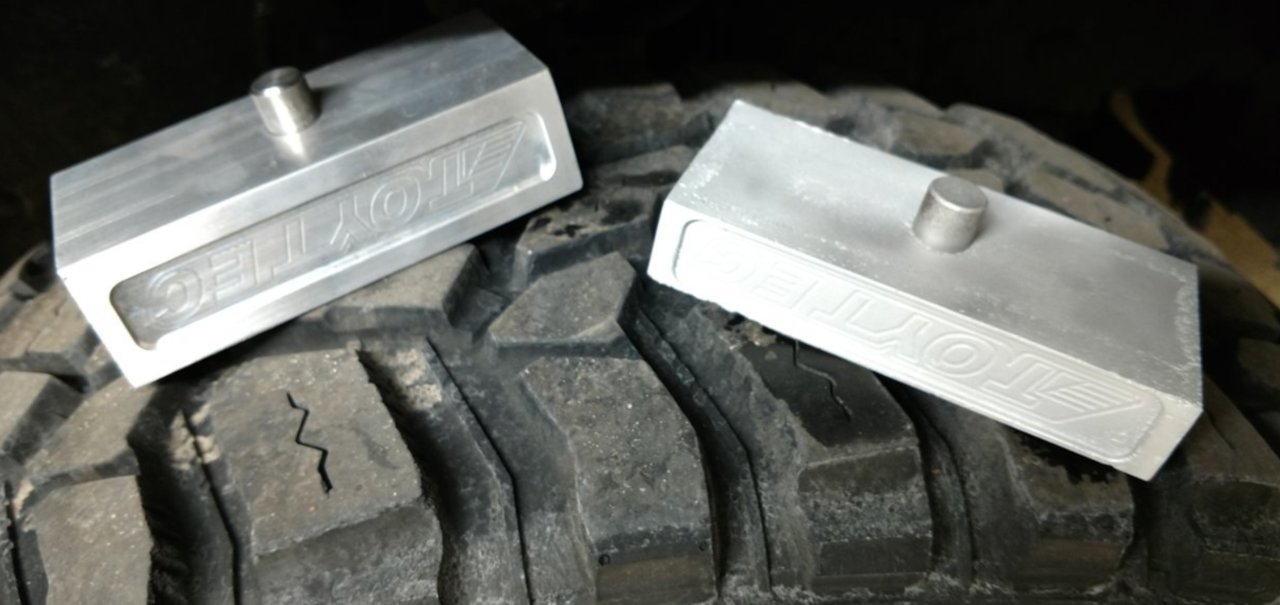

    My Taco had the lean, 1/2" to the driver's side when measured at the rear wheel well. I have CS047Rs with 1" spacers I added after the leaf packs settled a bit. After some time I noticed the lean and my OCD kicked in. I added the 1/4" spacer to the top of the front driver's side coil over and it didn't seem to do much, never understood why people think a 1/4" spacer would fix the infamous Taco Lean...... I ended up buying a set of 1-1/2" spacers and swapped out the 1" spacer I had on the drivers side. I have an extra set of 1" and 1-1/2" spacers if anyone is interested check out my listing https://www.tacomaworld.com/threads/welcome-to-capn-skidmarks-taco-stand.560203/#post-19623064
