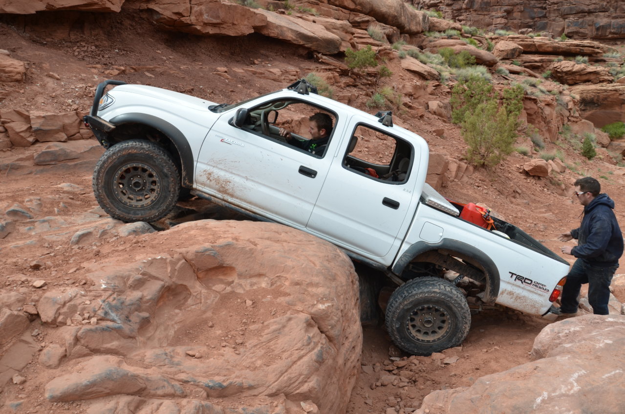

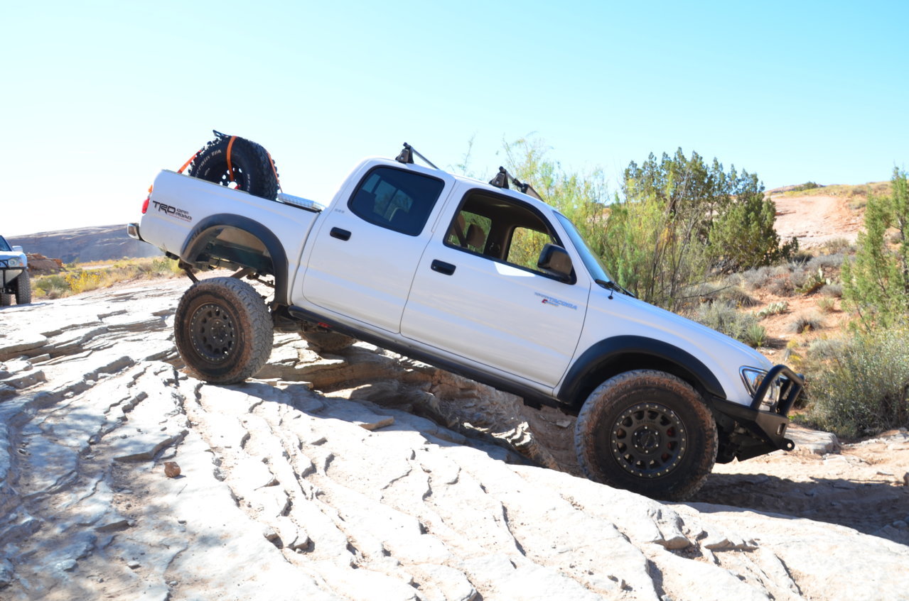

    Here is the truck on its first trip to Moab when she sat on 255 85 16's. In my opinion that is the perfect size tire if you are running an ifs or mid travel ifs setup. No rubbing and the narrower tires did great in snow, I could fly through bumpy sections and hit the bump stops all day long without any rubbing.

    Some more from the first Moab tripDSC_2713.jpg Car wash tub]
    DSC_2884.jpg Kanes Creek, put the first little dent in her on that rock off the driver rear.
    Bit long of a wheel base for 255's, I humbly admit it took a tug from above to get up.DSC_2892.jpg

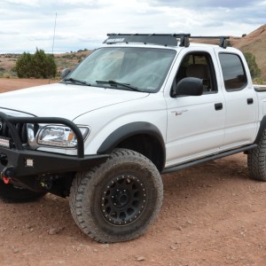

    255's tuck nicely and required minimum work to the fenders. Going to 35's was a cumbersome step, I'll dig up some current photos and take some as she sits now. DSC_3066.jpg

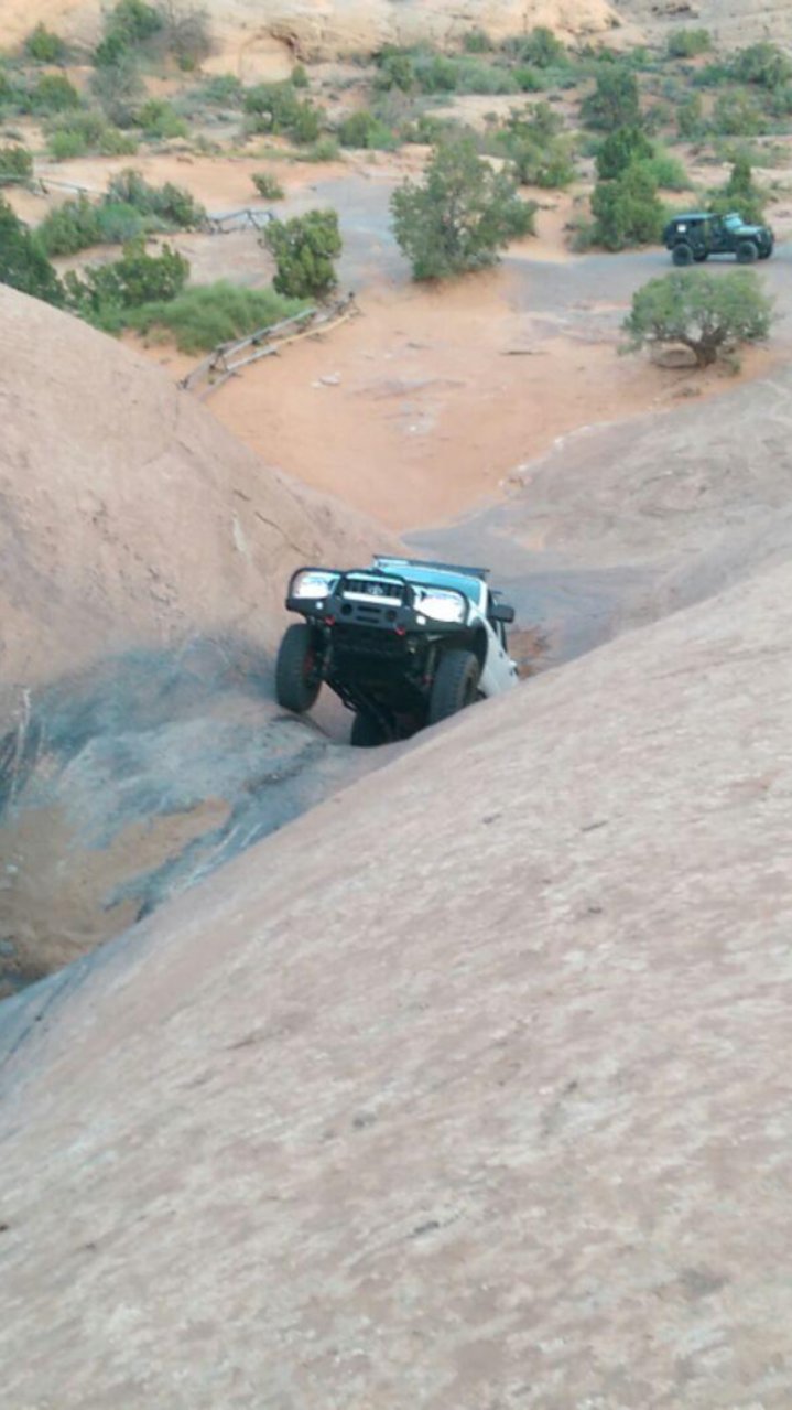

    Older picture on the escalator
    This one is a more current picture with the 35's trying the ledge on Kane's again. Need a front locker, but that will wait until after the SAS.IMG_2927.jpg

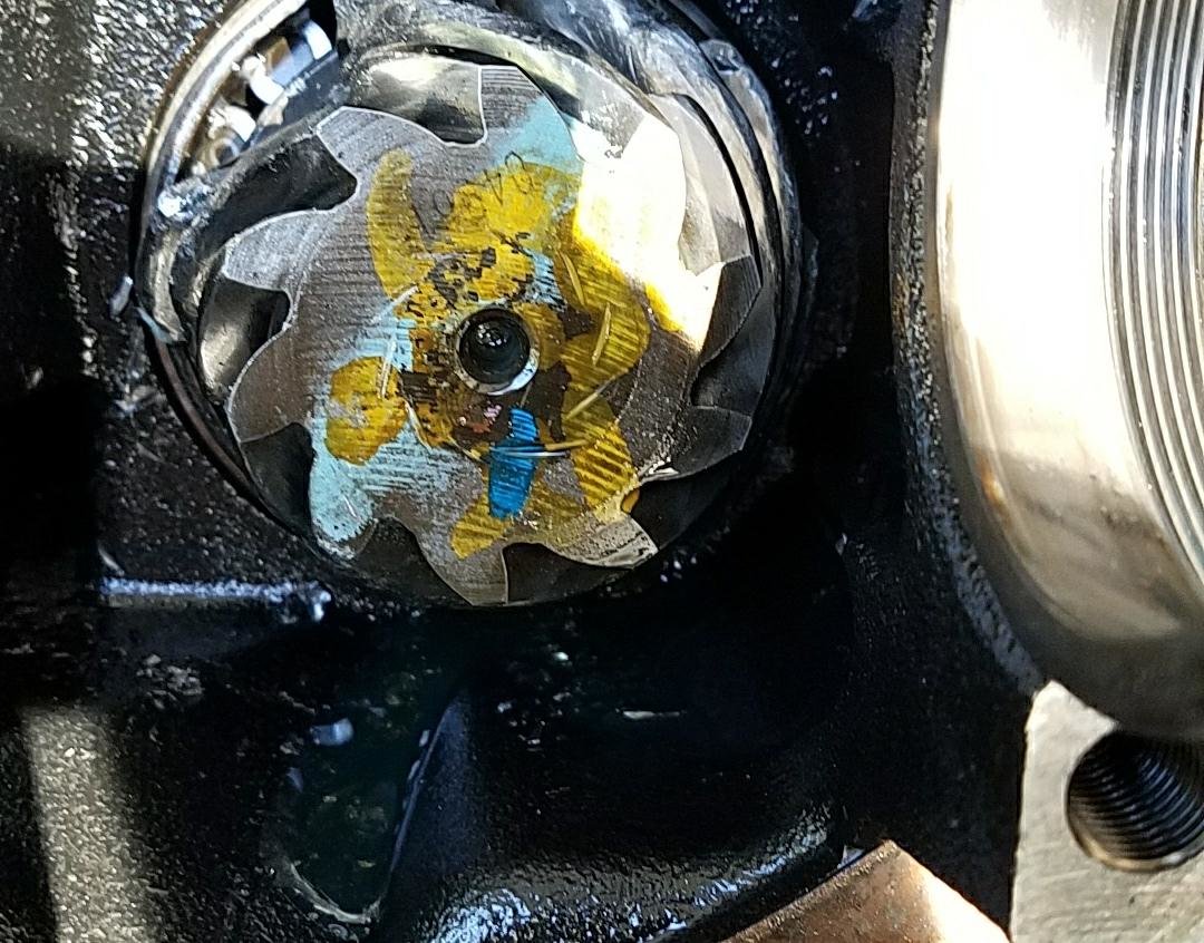

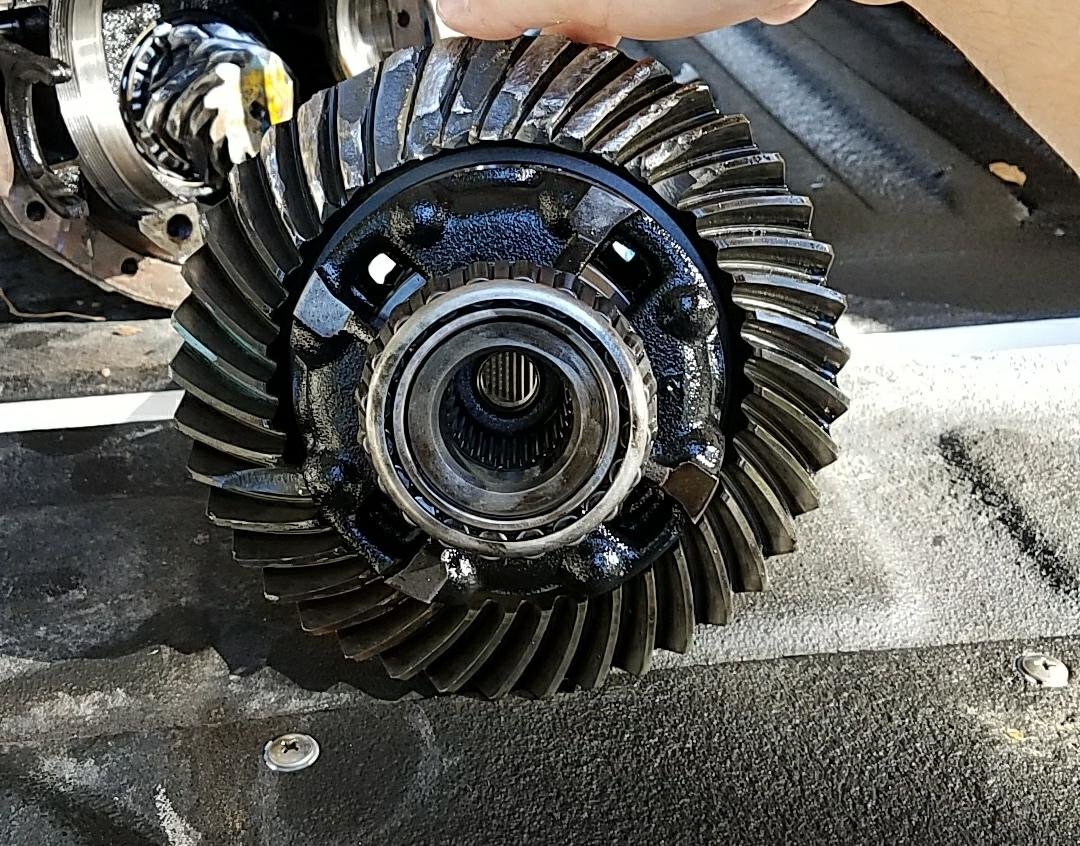

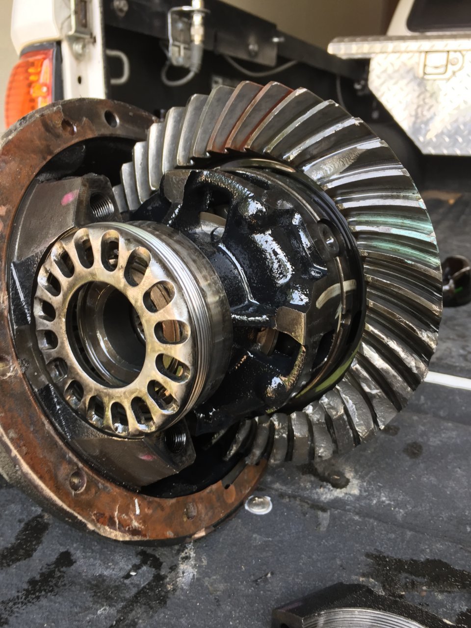

    IMG_3050.jpg IMG_3027.jpg IMG_3049.jpg Here is a little ring and pinion carnage from a run last August down near Colorado Springs. Super Charger + 35's = KABOOM! Whoops. Found the weak link hence the 9.5 that will be going up front. A rear axle build is also in inevitable, have not decided if that will be a ford 9 or a another 9.5. I don't trust 30spline in the rear, and I could go 32 spline but then I am limited to 4:88 gearing.

    Not soon enough, not to jinx myself but i have yet to snap a cv but managed to explode the rear end!
    Im actually headed to diamond / fror friday to get the caster set on my axle and finish it out with rcv shafts. Need a cross member to support the t case after crawl box install too.

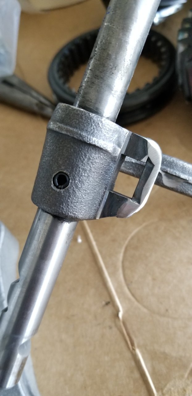

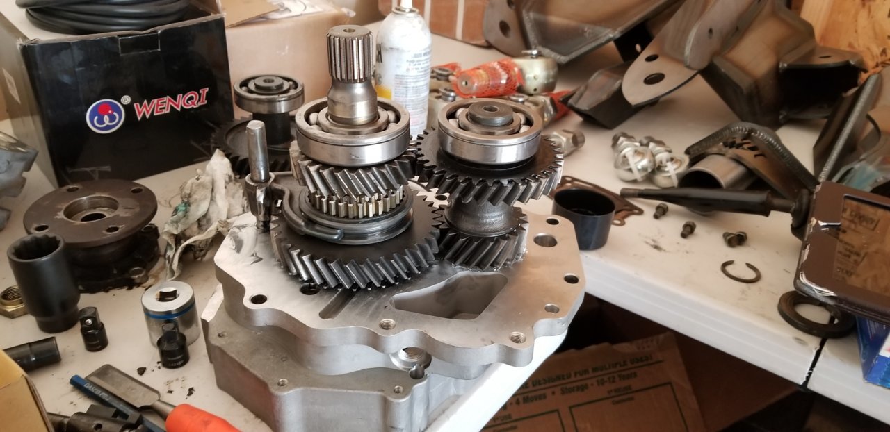

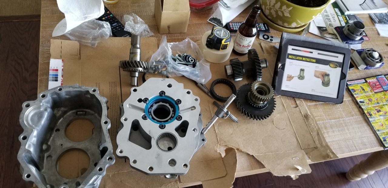

    Here are some progress pics of the tcase build.
    Welded keystock in shift fork to keep it in hi / lo option only.
    Parts on the dining room table, just asking for trouble there.

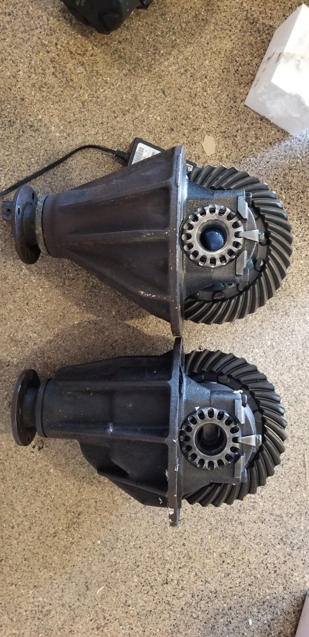

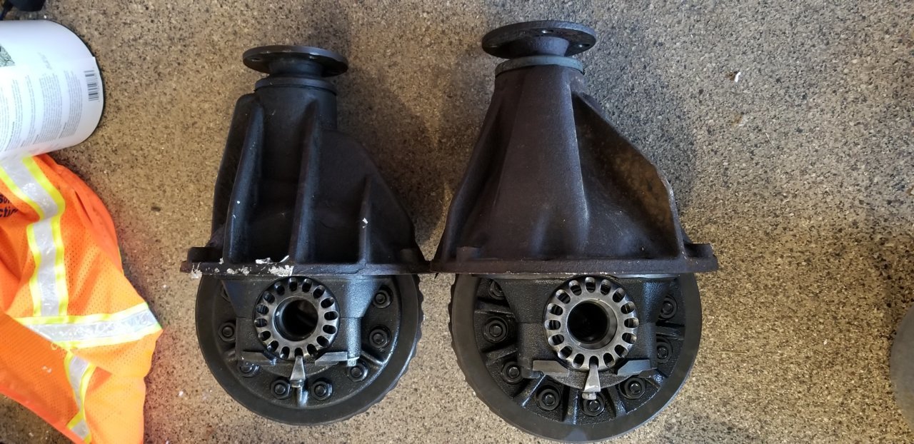

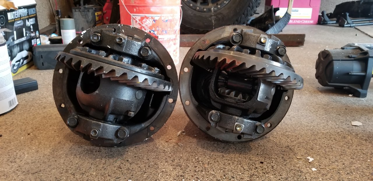

    In case anyone was curious to see the differences of the landcruiser 9.5's side by side. 20180624_141325.jpgtop is out of a 80 series, and the bottom is the older 9.5. 20180624_140608.jpg80 series on the right has a thicker ring gear, 41 count, ill have to count again but i think the one on the left is a 37 tooth with 9 on the pinion giving both a 4:11 ratio.20180624_140521.jpgthe plate the ring gear is bolted to is more substantial with more ribs on it compared to the older 9.5 both have 12 bolts though.
    Need to figure out which ill install in the diamond, not sure if it matters much as i dont plan on putting a load bolt in it.
    Ill snap a picture of the 9.5 next to the 8" i ha e for comparison.

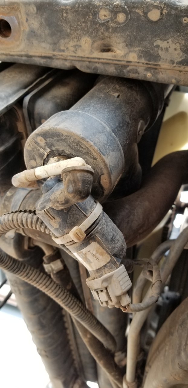

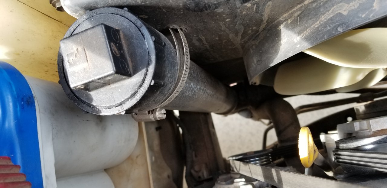

    can you get me a pic of the washer reservoir you made? I just crunched mine stabbing my v8 in.
  20. Aug 5, 2018 at 8:01 AM
    #20
    Een
    Een [OP] Well-Known Member
    Sep 4, 2016
    #196429
    71
    Ian
    Castle rock, co
    2004 DBL Cab Tacoma trd

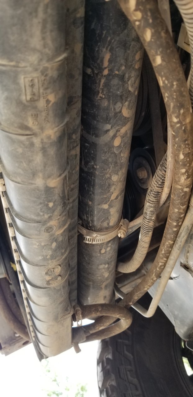

    Super charged, urd 2.1 pulley, 7th injector, sway away coilovers w/ all pro uca's in front, all pro leaf and shackles in rear with fox 2.0 Relentless Offroad DIY aluminum front bumper, all pro sliders 315's on 16" method wheels
    Super simple... abs plastic with a screw on cap to fill (make sure to drill a pinhole in it or it will create a vacuum and not work)20180804_160447.jpg
    Re used all the pump parts and attached them to a 3 way t fitting so there was a low spot.
    Off the t is another piece of abs with a sealed end for more fluid storage... keeps it nice and warm tucked up next to the radiator.
    I dod this so the reservior wasnt hanging down below the bumper. Can't take credit for it, saw it on here but forgot where.
