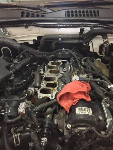

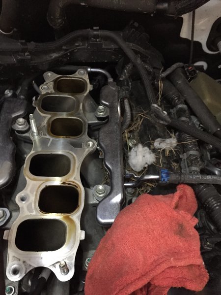

    I live in a very generic suburban cookie cutter neighborhood. Since the weather here in N. FL has become bearable I've been riding the Harley. The Taco sat for 10 days. Today I fired it up to find a CEL and a Trac light. Noticeable misfire on accel, noticeable rough idle. A quick underhood inspection and I found a nest under the intake runners made of leaves and the shit you use to make fake spiderwebs on your bushes for Halloween. Thanks suburbia. I thought about what the dealer would charge me for a repair, (shudder). Then I thought about doing it myself, and I dug in.
    My laptop said I had a proprietary code for a bank 3 injector fail. (Thank you Google) As well as a generic P0302.
    Pictures to follow.

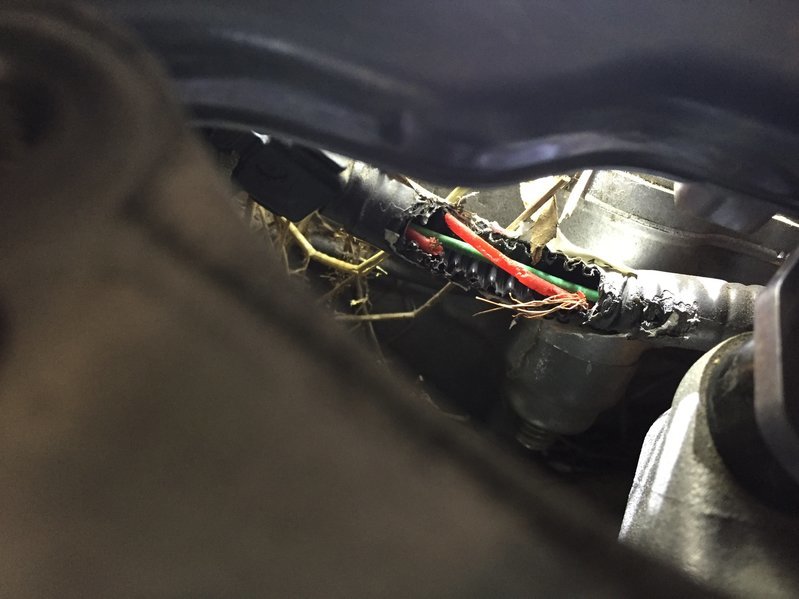

    I don't have "pack rat" coverage. And I've turned wrenches for $ a few times so I'm on my own here. A new harness was $48 so I ordered it already.

    It's almost just a pigtail. Drivers side injector connector. It's about 10" long with a main connector and 3 injector connectors. I repaired the old one just in case the parts man lied to me. Because that never happens.

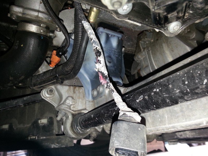

    Had that happen to my Audi. $2200 and almost two months later I had a new wiring harness and firewall insulation from Germany. Needless to say I did an insurance claim...... I have tons of rat traps/zappers and fully sealed my garage after that.

    Something about Audi's wiring attracts mice. Thought my oil level sensor was bad. Bought a new one, took off the panels under the car to replace, and found a mouse had chewed through the wires. Luckily it was an easy splice and not near as bad as yours or OPs sounds, but of course Audi would let me return an "electronic" part even though I never took it out of the box.
