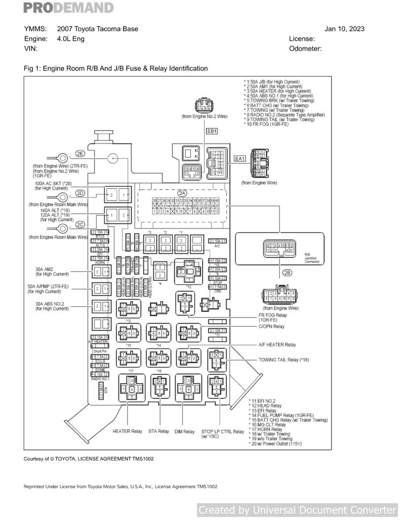

    The EFI No 2 fuse power's quite a few things.
    MAF Sensor
    Purge VSV
    ACIS VSV
    B1S2 & B2S2 O2 Heaters
    Control side of the AF Heater Relay
    EVAP Vent Valve

    The only wire off that fuse that goes through the interior is the one going to the Vent Valve in the Leak Detection Pump at the rear of the truck, that goes through connector IB1 Pin 3 (Blue/White) located behind the left kick panel.
    All the other wires go though the underhood junction connector (2A & 2B), 2B is easy to access but 2A is under the fuse box and nearly impossible to get to.
    TnShooter likes this.

    If you can get us pictures on the connectors, and location, we might be able to help more.
    Take some pictures of the location of the connector, and then a close up of the connector. Try to get us a view of the wires and colors.
    That will help us more.

    Thanks to your help progress is being made. I have isolated the short to fuse box connector 2A pin 15.
    Now to disassemble the fuse box enough to trace.
    It feels mighty good to be able to make progress thanks to your assistance.

    I have the fuse box apart. Pin 15 is a blue and white wire I belive it is going to the leak detection pump vent valve. I have disconnected 1B1 connector in LH kick panel still shows short to ground at pin 15. Will start tracing wire as soon as I finish some honey do requests.
