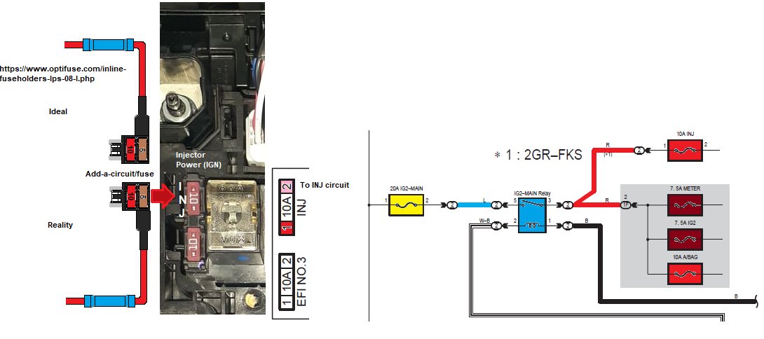

    Quick question on this topic. Does it matter which way the add a fuse is plugged in as long as the INJ fuse is on the bottom? A local shop got me all freaked out I could fry some wires if I plug it in the wrong way.

    Technically, there IS a right and wrong way. The good thing is that either way works just fine, without risk of frying wires.
    The difference is that when plugged in the right way there is no additional current going thru the INJ fuse, but plugged in the wrong way there is. Think of it as adding the extra fuse to either the battery side or load side of the INJ fuse.
    For a small added load like grill lights, I don't think it matters.

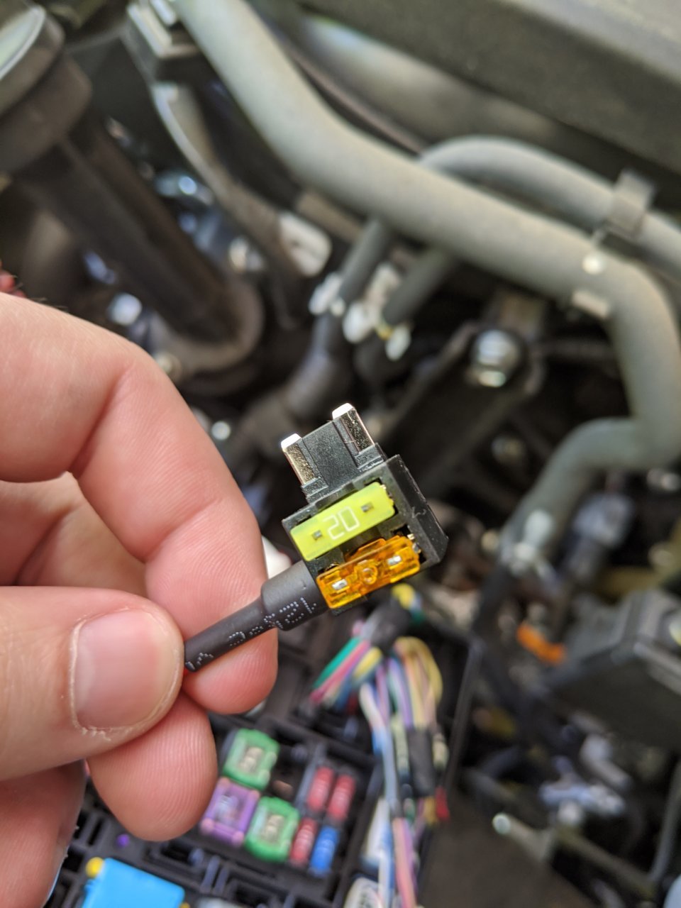

    Quick question, I'm out here installing my lights, I also have a 20a fuse like the guy above me has and when I connect everything my lights just come on and stay on. I just cranked it up and turned it off. Lights are still on.. like there is constant power. Any ideas?

    Fuses upside down perhaps? I just read up. Yellow is my 20amp INJ and the Orange is the 5am they came with.

    Ok.... So I guess I just needed to talk to myself. I figured it out. I was using the 20a D INJ fuse when I should have been going up in the box and finding the REAL 10a INJ. Works just fine now.. jeez. I shouldn't have drank all that beer last night.
