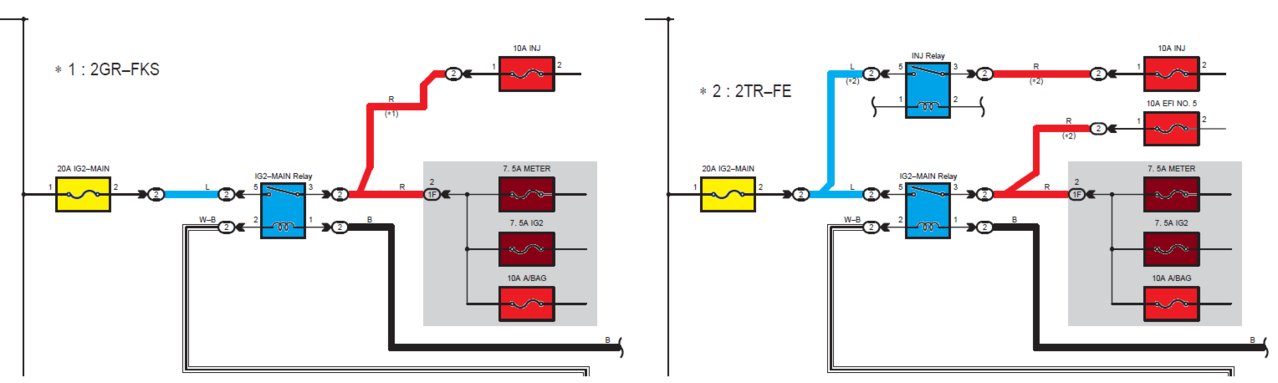

    So I have had my raptor lights piggy backed on my inj fuse for about 3 weeks. I go out to my truck (night time) and the damn raptor lights are on.... I also hear a droning noise towards the rear possibly fuel pump? Wining away. Anyone else experience this?

    I have a 2016 sr and I tapped into the INJ fuse like you but i went inside my house and looked out my window a hour or so later and the lights where on buy the time i went out side they was off is there another fuse I can tap into

    Literally same thing happens to me but more frequently. I ran outside to see if I could notice anything and I heard my fuel pump or some kind of pressure check/ test running in the rear near the fuel tank... Once that noise stopped the lights shut off

    @Fishingeek603
    @McHugh83
    So, here's WHY yours works differently. :facepalm:
    According to the schematic provided by @caribe makaira in post #14, the 3.5 L V6 and the 2.7 L 4 cyl are different.
    I had to really look for it, but it's there. Look for the *1 and *2 sub-notes. :notsure:

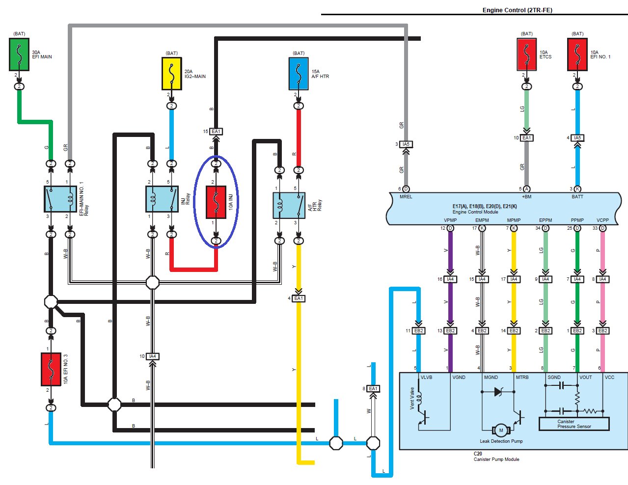

    La raison est:
    The 4banger INJ relay gets active due to its tie with the pump leak function. So when you use the 10A ING fuse for say the grill lamps, they'll be ON until the system leak runs its course.
    Engine module has 2 fuses that always have juice. Not tied to IGN.

    Referring to Caribe's schematics in post #45, the one on the left is for a V6, and the one on the right is for a 4 cylinder.
    It "looks" like either of the 3 fuses in the gray box should work for a 4 cylinder.
    I won't bet on it, but it may be worth trying. :notsure:
