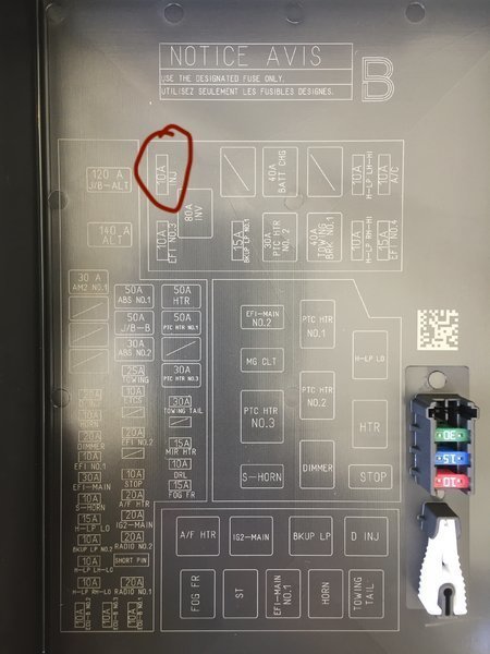

    Yes, exactly what caribe shows in the post I linked.

    Great thank you. So I can just move the swap a fuse over to that one with the same fuses I have in it already? Sorry I’m not electrically inclined

    I believe the low beam is fused at 10amps which matches your picture of the fuse cover. So you can swap the add a fuse to INJ and move the INJ 10 amp to the low beam. Assuming that is where you have it right now.
    note it only fits one way on INJ due to space constraints.

    Thank you so much man. Works perfectly
