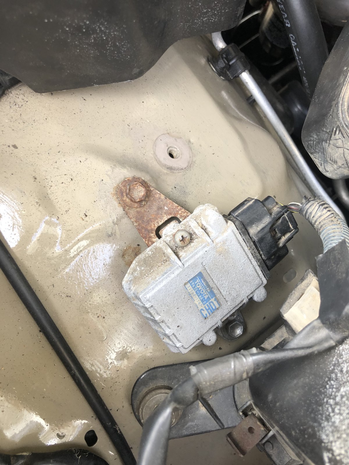

    anyway you can bench test the old ignitor?
    U seem to have much better Multimeter skills than myself!
    btw, would love to see a pix of this ignitor and where located
  9. Dec 30, 2023 at 7:35 PM
    #29
    Raspberry
    Raspberry [OP] Well-Known Member
    Jun 15, 2022
    #399496
    55
    Andrew
    1995 Tacoma 4x4
    Full restoration
    I don’t know how I would test the igniter, though I’m sure there’s a video or something I could find.
    The igniter is located on the fender behind the air box and under the cruise control box.
    The ground was pretty rusted when I took this photo last week, but I already took care of that and cleaned up the grounds. No difference though

    I thought leaking caps in the ecu was a early 90s problem, but that cap in your pic looks to be leaking on the board....not good, as someone else mentioned that goo can damage the traces disabling certain functions of the ecu. If you cant find a replacement ecu for a reasonable price there is a guy in Texas that repairs Toyota/Lexus ecu,s . Relentless Motorsports tx (972) 779-6862 have seen this guy mentioned in other forums never heard anything negative. Also this not your issue but try to keep your case grounds clean, mounting points between ignitor case and fender, ecu case to firewall retention clip.
    Another quick note, that ignitor is very common to 4cly toyotas and older lexus v8,s have two of them also on corollas and camrys, plentiful in junk yards, nice to have a spare for troubleshooting. Hope you get things resolved
