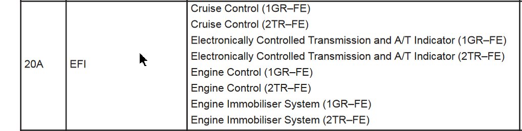

    Also need to find what circuits run off of that fuses .Toyota kind of trippy were that one fuse connects to several circuits . Your manual should tell you . Hopefully its not an intermittent short .Very hard to trace . Good luck

    hemitruk and b_r_o like this.
