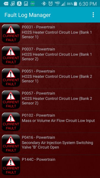

    Here is a screen shot of the torque app...since that fuse looks like it regulates more then one part/system, it has me chasing my tail.
    Note this screen shot is after the fuse blows.
    Just weird that it only does it from a dead stop to WOT.Screenshot_2016-03-05-18-31-00.jpg

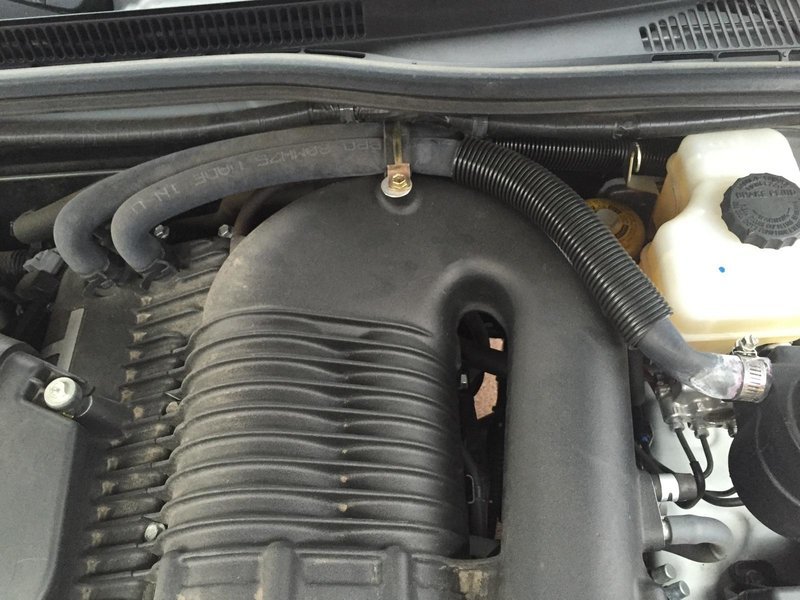

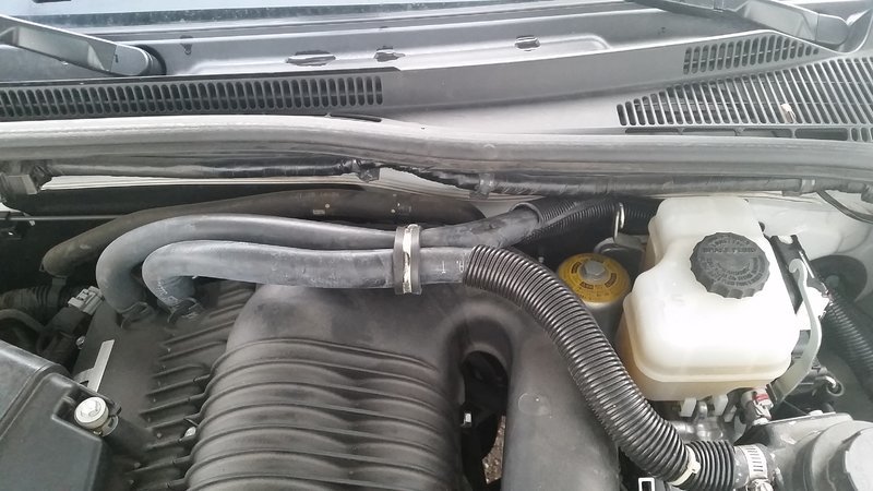

  13. Mar 7, 2016 at 4:51 PM
    Matt2013
    Matt2013 [OP] Member
    Mar 8, 2015
    #150401
    8
    2013 TRD DC Taco
    Before and after pics. Supercharger hose clamp rubbed through my main wire harness on the firewall.
    After
    Before
  14. Mar 7, 2016 at 5:41 PM
    nd4spdbh
    nd4spdbh Well-Known Member
    Oct 7, 2013
    #114055
    14,555
    SoCal
    13 DCSB TRD OR v6 Auto
    ^ if that was the fix, you need to open up that loom and repair the messed up wires.

    :thumbsup: Good job. Suprised they routed the hoses like that originally in the first place.
  18. Mar 8, 2016 at 2:25 AM
    #18
    memario1214
    memario1214 Hotshot Offroad Moderator Vendor
    Oct 1, 2009
    #23628
    20,137
    Colton
    Missoula, MT
    SOLD - 05 Dub Cab TRD Sport 4x4, CURRENT - '21 Tundra MGM Limited
    I especially like the kinked coolant hose in the second photo... :facepalm:
