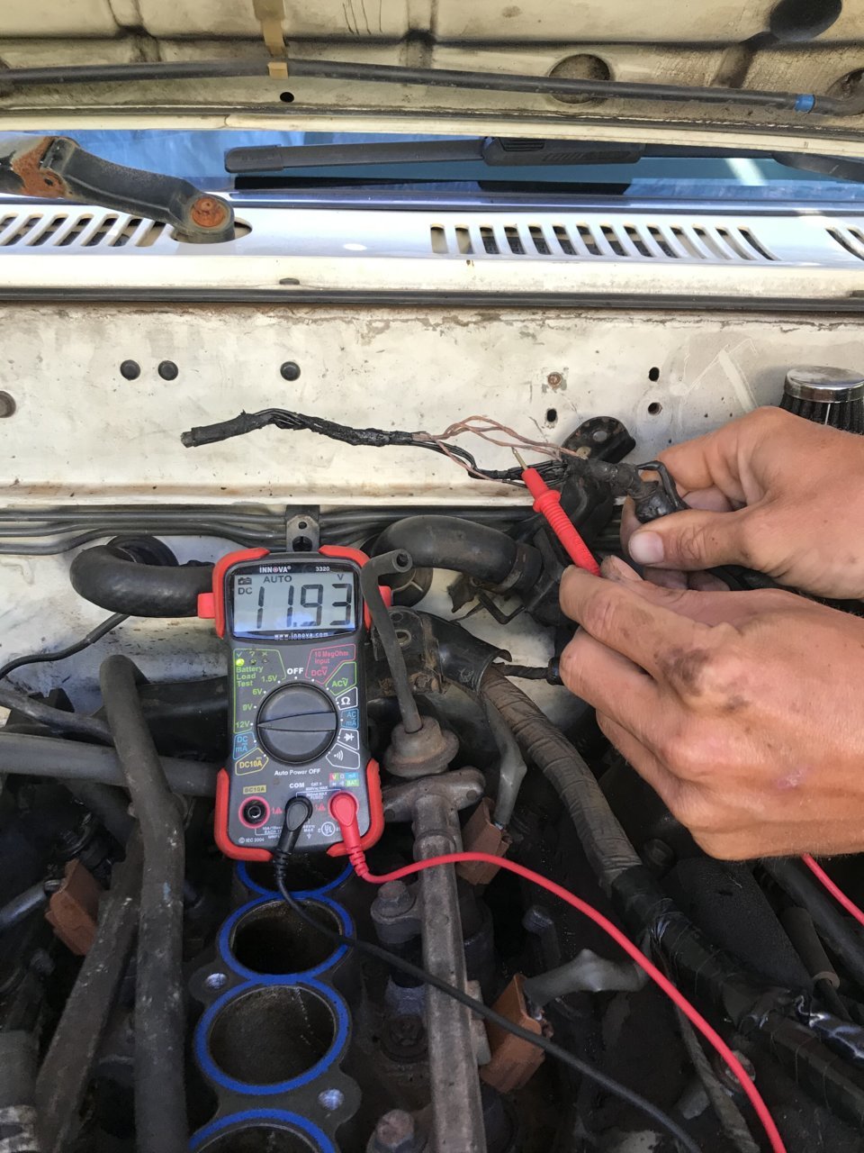

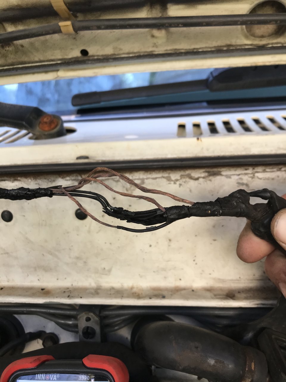

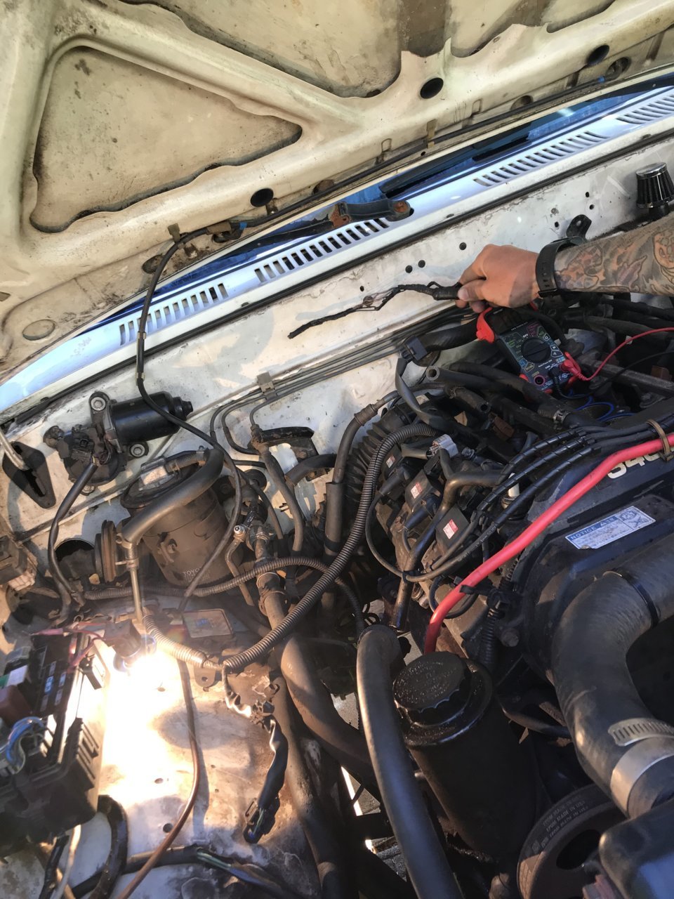

    Truck was running great for about 3 weeks to a month, did some wheeling yesterday and handled fine, on my way home though the problem returned. Pulled the charger off first thing this morning and found a old harness that looked like bbq. Did a MM test and saw the wires all had 12v and was all copper. Put the headlight back in efi fuse slot, ignition on, touched wires to a bolt on fire wall and boom! Light on, take wires off ground, light off. Makes sense why pulling the charger off the first time immediately stopped the short and after some time the wire just found it’s way back to a ground. Will upload some pics. Thanks all for the help and replies

    Custom Wiring That looks to have just been cut off unless you cut the wires.
    Then overtime Rubbed till they shorted at least it seems to have had some circuit protection to prevent a visit from the fire company.
