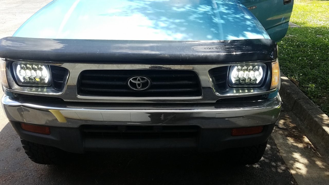

    Got my new headlights installed. I'll get pics of exhaust next oil change. Other than the rear hanger being 3 inches too short to actually hang on the mounting point (got some ghetto rigged jank shit atm) its a solid setup well worth the price. My exhaust leaks now are limited to the even more apparent manifold cracks. Been reading some horror stories on the LCE header cracking at the 4 way collector so I may not go that route.
    The headlights and harness I bought from Amazon. Superb light output compared to shitty sealed beam.
    SPL 105W Brightest 5''x7''/7''x'6'' Projector Osram Led Headlights with DRL for Jeep Wrangler YJ Cherokee XJ H6054 H5054 H6054LL 69822 6052 6053 Toyota pickup(Black Pair) https://www.amazon.com/dp/B073QR6BVC/ref=cm_sw_r_cp_apa_i8qlBbZZD0F51
    2-Headlight H4 Headlamp Light Bulb Ceramic Socket Plugs Relay Wiring Harness Kit https://www.amazon.com/dp/B06XHSFLTZ/ref=cm_sw_r_cp_apa_V8qlBbTSW5SW1
    The headlights come with a little harness. Chuck that fucker into the woodline. Slap the new lights into the stock light brackets. Use the secondary harness. I made a grounding point for the 2 relays with a section cut off from a metal hose clamp.
    Plugged the driver side headlight plug into the passthrough portion and added power/ negative to the color coded doohickey.

    Those headlights are frightening. You use those on the highway?

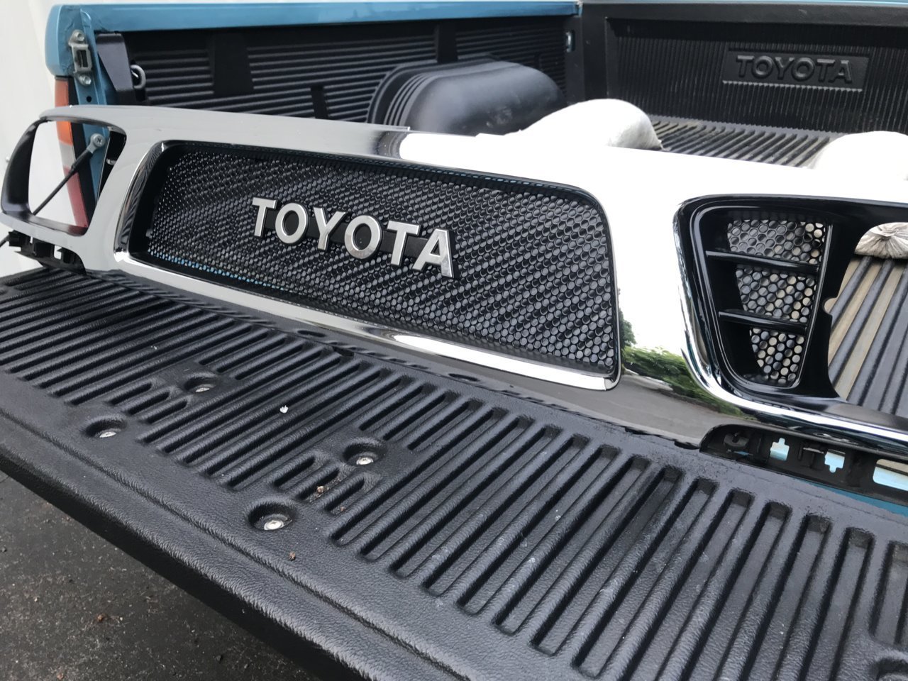

    Found his build post. Its a land cruiser badge with mesh grille, im wondering how he made it fit and stay thou, thats my question.

    Lots of ways, when I did it to my last taco I used Auto Goop

    Sweet, the satoshi look on the 1st gens definitely adds a lot. I found that the 1990 4runner emblem fit the grill a bit better, it uses 3 fasteners to attach to the grill. I just did mine recently on the 95.5

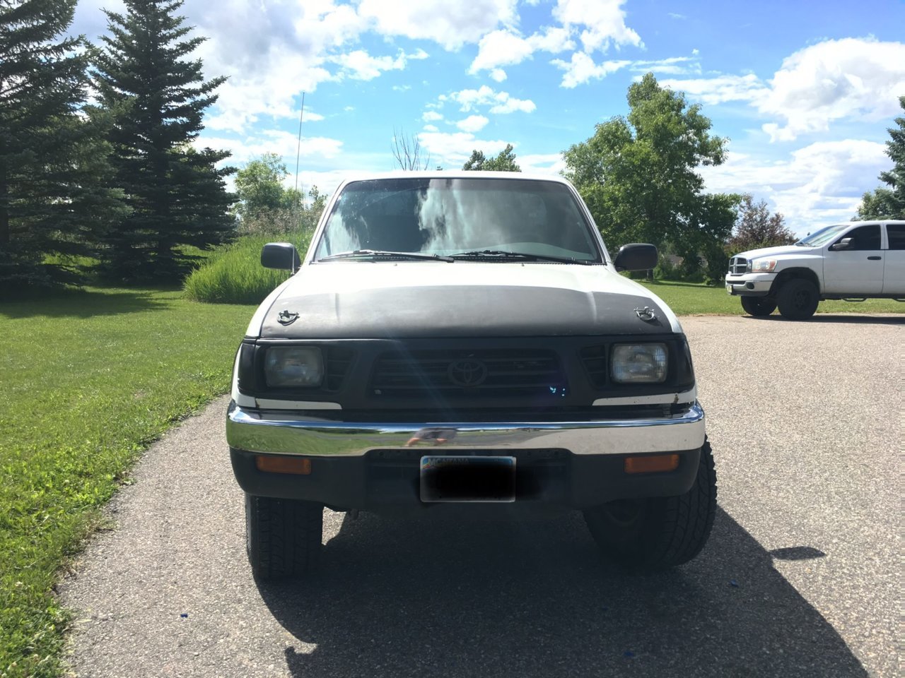

    i think ill probably start with a new grille, heres what i have right now.
    dont even ask about the bedliner hood lol. A new hood is next on the list as well.

    Got my lettering from http://cruiserparts.net/
    It’s stuck on there with 3M double sided tape. It’s held on for the last 15k Miles, so I’m hopeful.

    I found the 4runner emblem on ebay, they are around from time to time. Emblem was about $35, mesh was $75 from @HomerTaco, and $5 in spray paint. Definitely time consuming though, probably took me about 3 hours.
