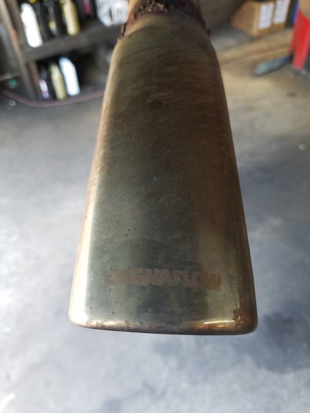

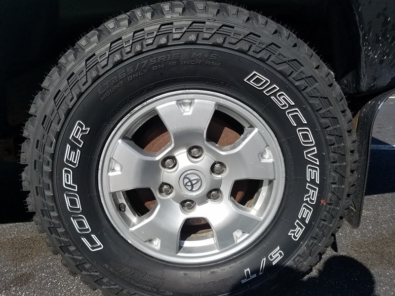

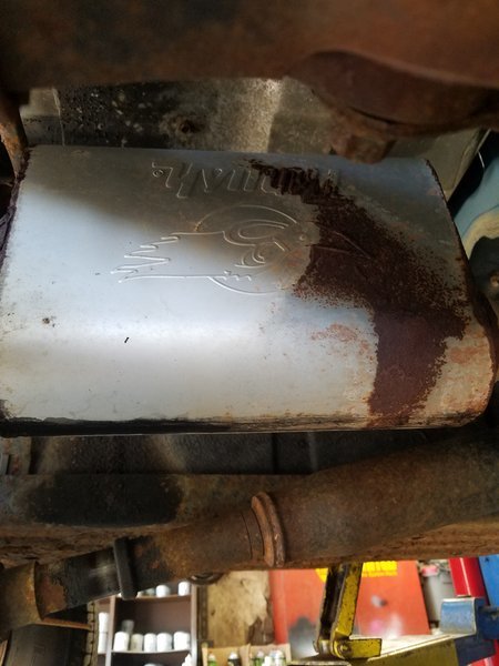

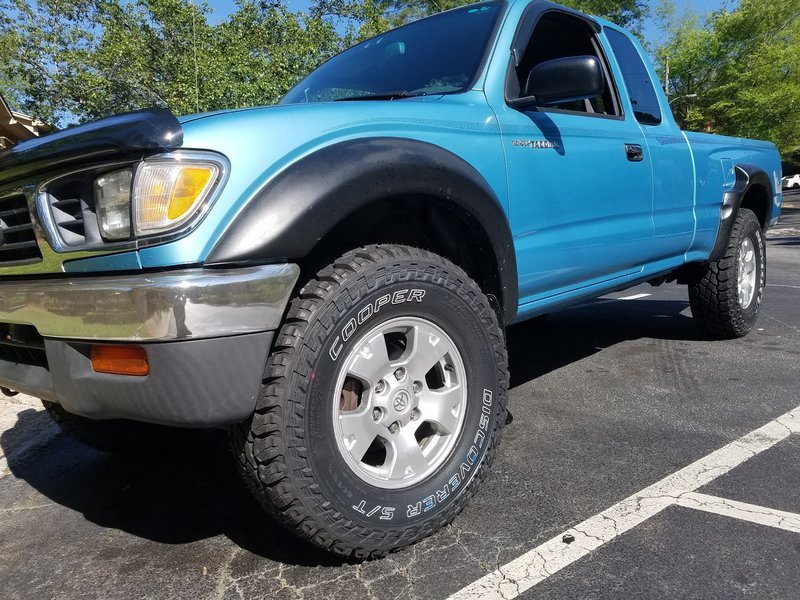

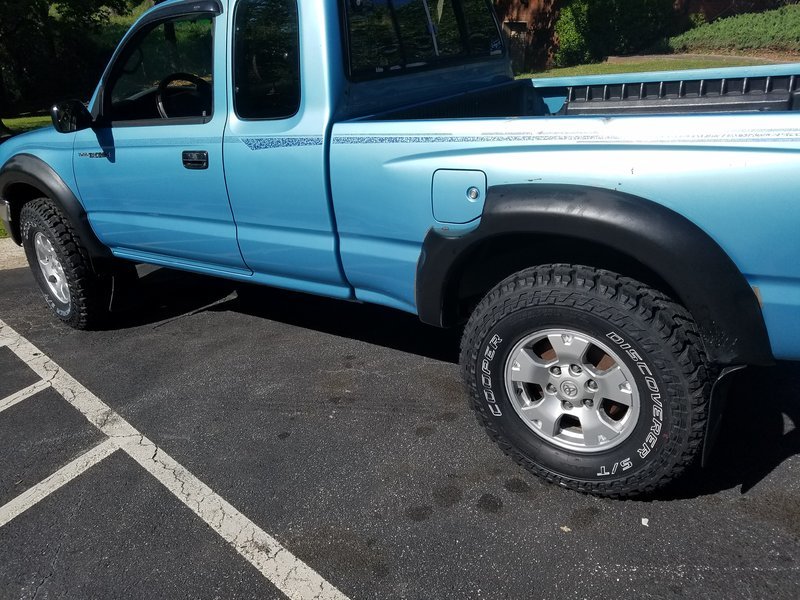

    BANG. New tires. Got the ST MAXX in the standard 265/75/16. Truck feels sooooo much better. Found out I have an aftermarket exhaust lol. Rusty but it works ^_^. 20170426_170743[1].jpg

    lol forgot the rusty exhaust pics
