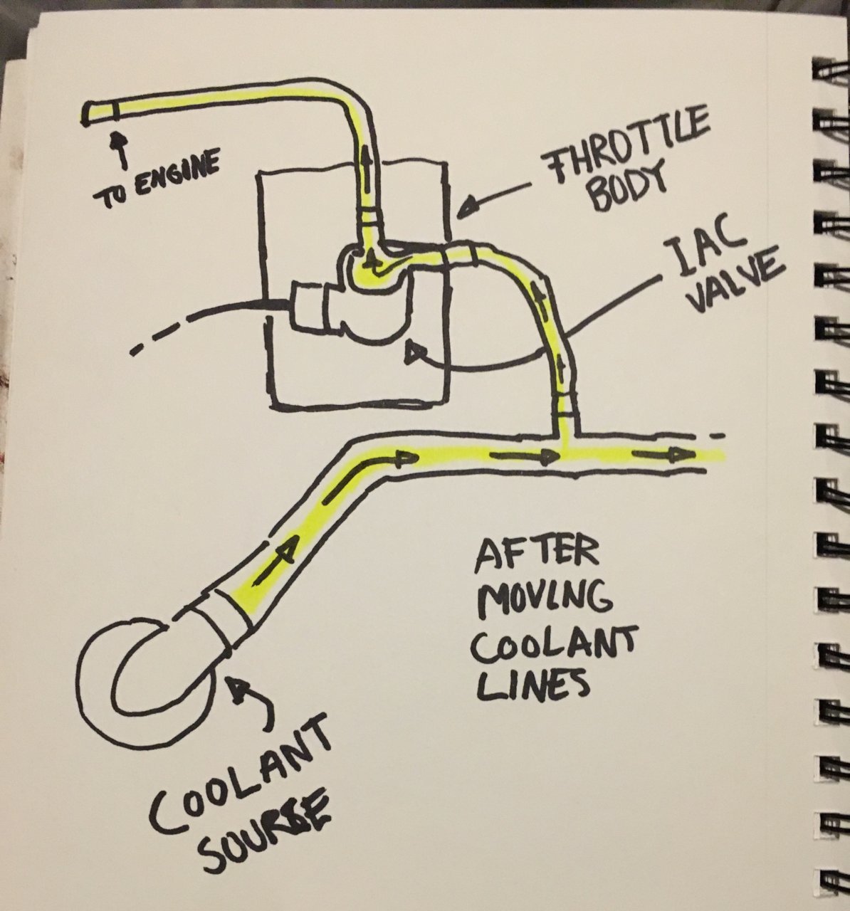

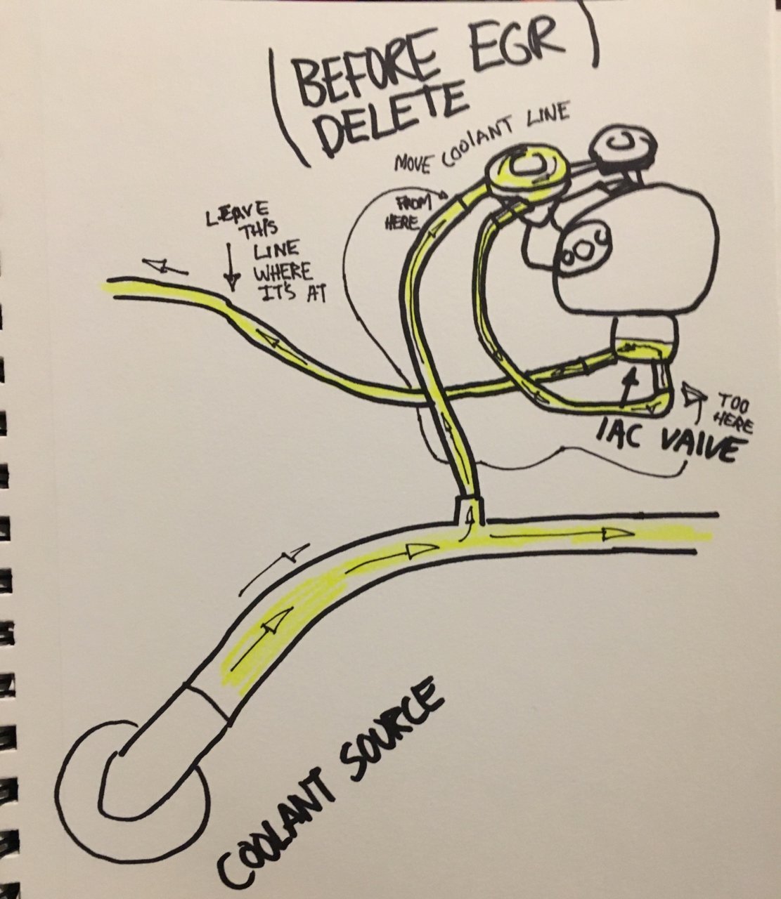

    572BD495-9ADA-4A03-8543-39030117572C.jpg B0617B84-5D8B-47B4-9129-9256887644CD.jpg I figured it out.
    The coolant runs into the bottom of the IAC valve and out the other side. It’s just a small loop off the main coolant line.
    So after deleting the EGR valve I recreated that loop. Instead of running the coolant Through the EGR I ran it straight to the IAC valve.
    You can also hook the lines together, or cap them off, But than your bypassing the IAC valve.
