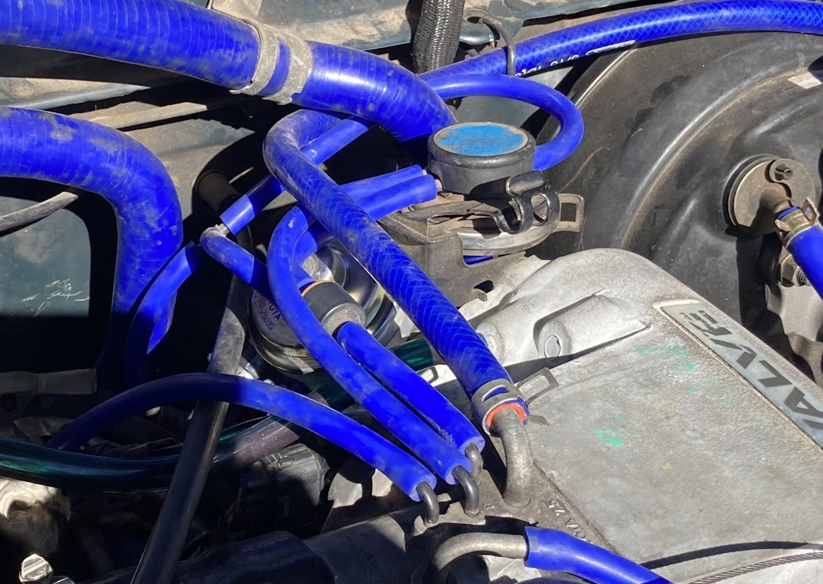

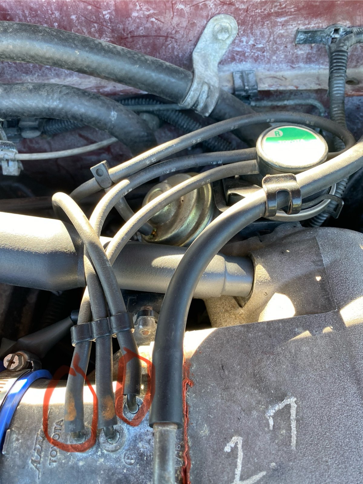

    In the two pics below I circled the hoses in question. Going left to right the first & third ones are crossed. Does that make a difference?

    Far left and right are rolled per what I have on my 96 2.7l. Not sure what the ramification would be. I’d swap them.

    I did. Thanks. Not sure when that happened. I just had the EGR system reinstalled by Toyota dealer here.

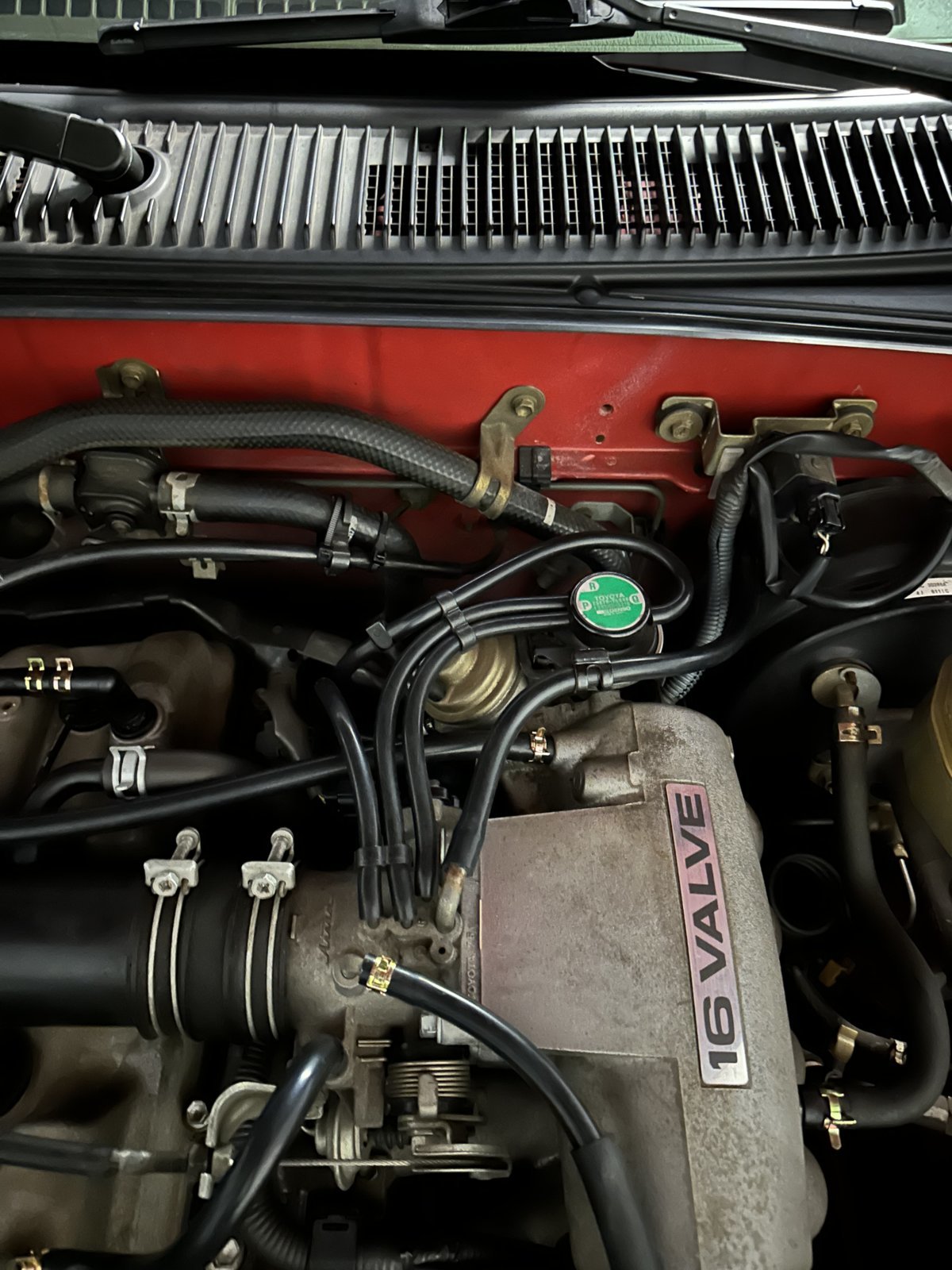

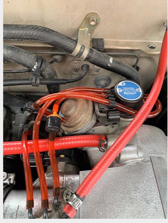

    What is that you have spliced into your hose coming off the R port?

    Looks like a check valve or filter. I don’t have one of those on mine. Only thing I’ve done there from stock ‘96 was replace the lines.

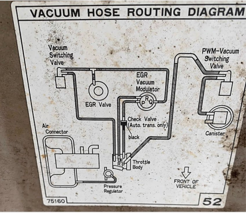

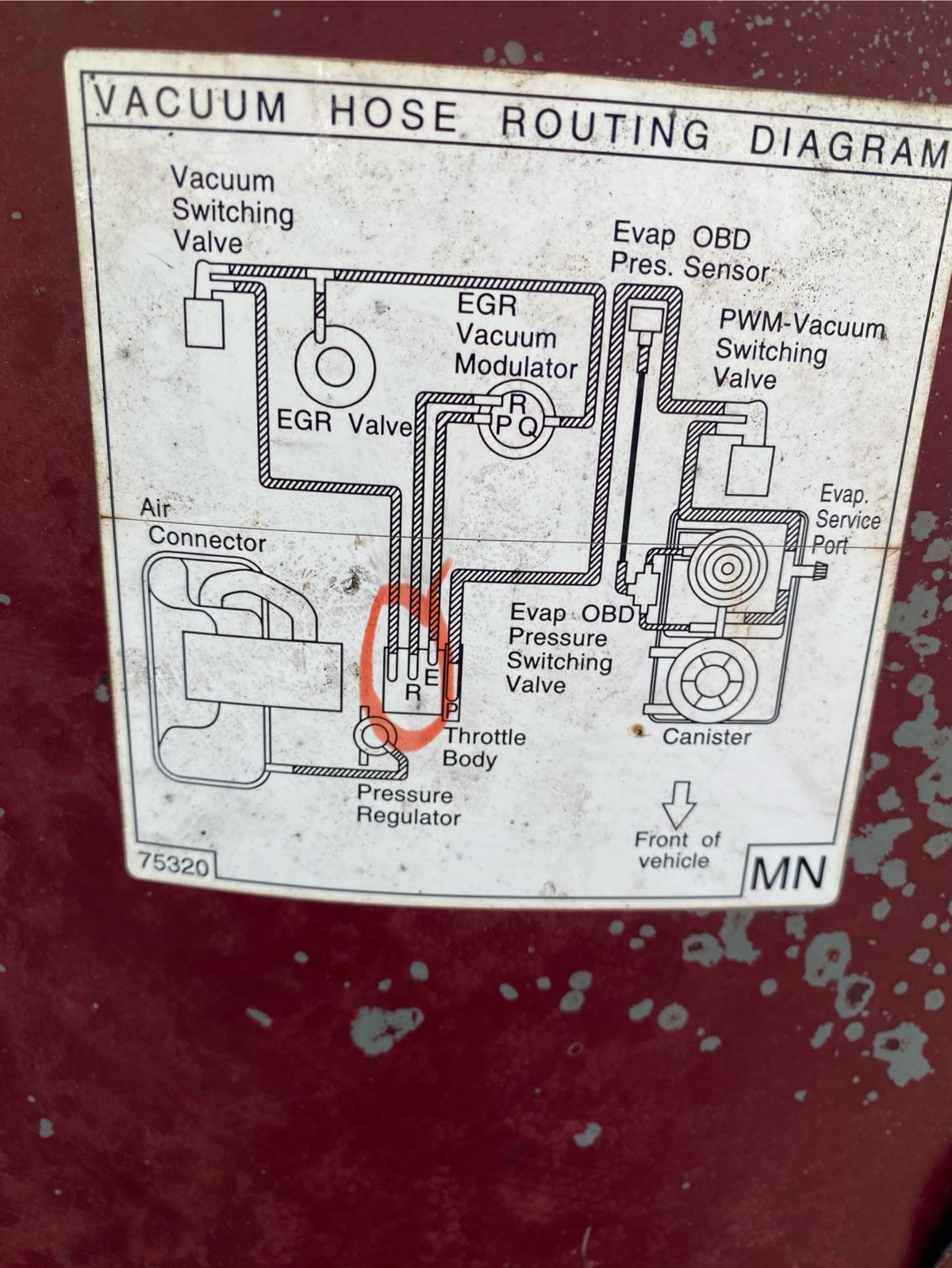

    Does anyone know if this is the same vaccum routing diagram for a 2.4 on a 2001 ?

    I believe old silvers is a 2.4, what he pictured.

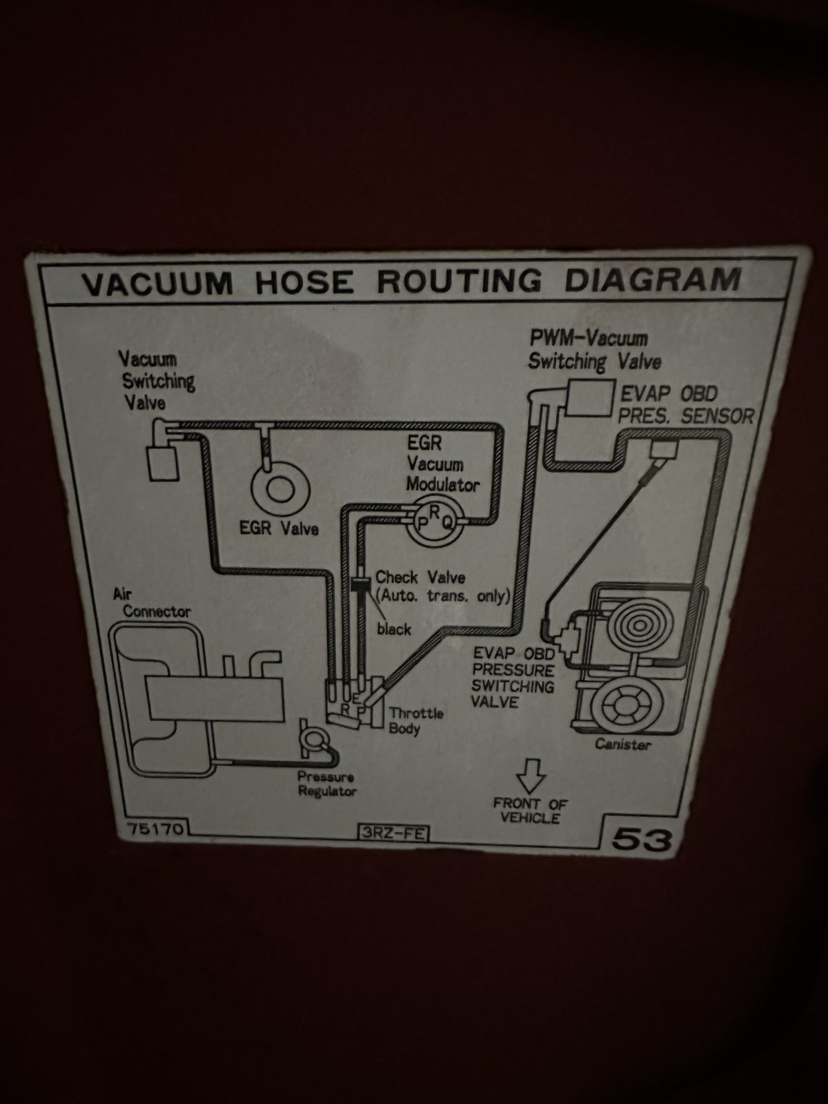

    96 2.4L here:

    AAAHHHH
    after revwng all 3 posted vacuum routing hood labels
    that 'check valve' only present on automatic trannys
