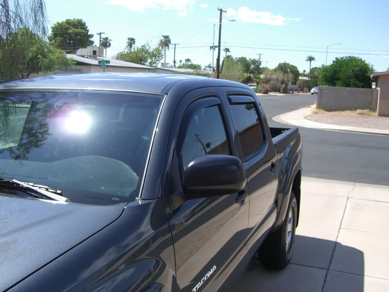

    Just got my set of 4 for my 2010 double cab.The fronts fit in perfectly but the backs with the tape will not fit in the window channel snug for the tape to stick........even with the window up.I've got the windows up with a bunch of match books wedged up in there so the tape will grab but i'm afraid eventually,like maybe right away after the match books are removed,when someone puts the back window(s) down they will just blow off with the wind.In short the rear visors are not thick enough to fit snug in the channel(s).Any suggestions on a remedy?

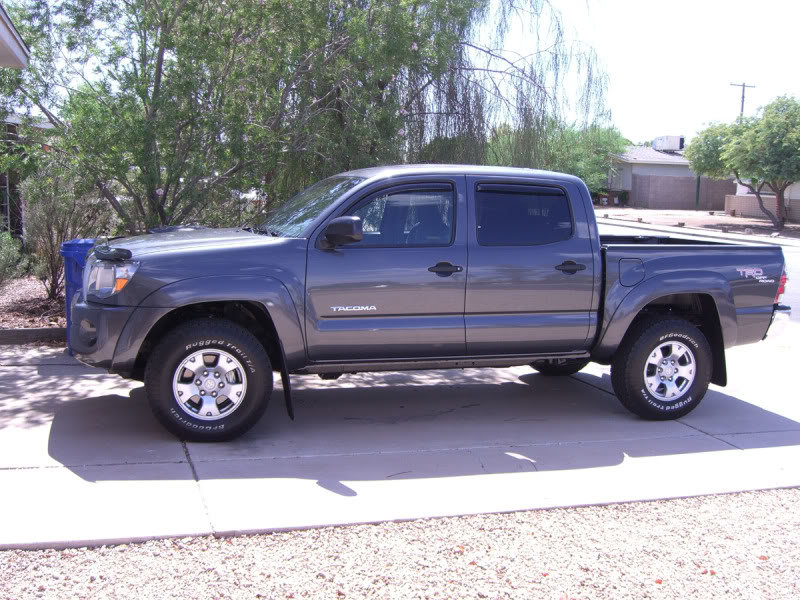

    The 3M tape did the trick.I had to double up,2 layers of tape one on top of the other,to fill the gap in the channel for it to grab correctly.Maybe 2010 Tacos have a wider channel then the previous years.Anyhoo......they are on tight now.
