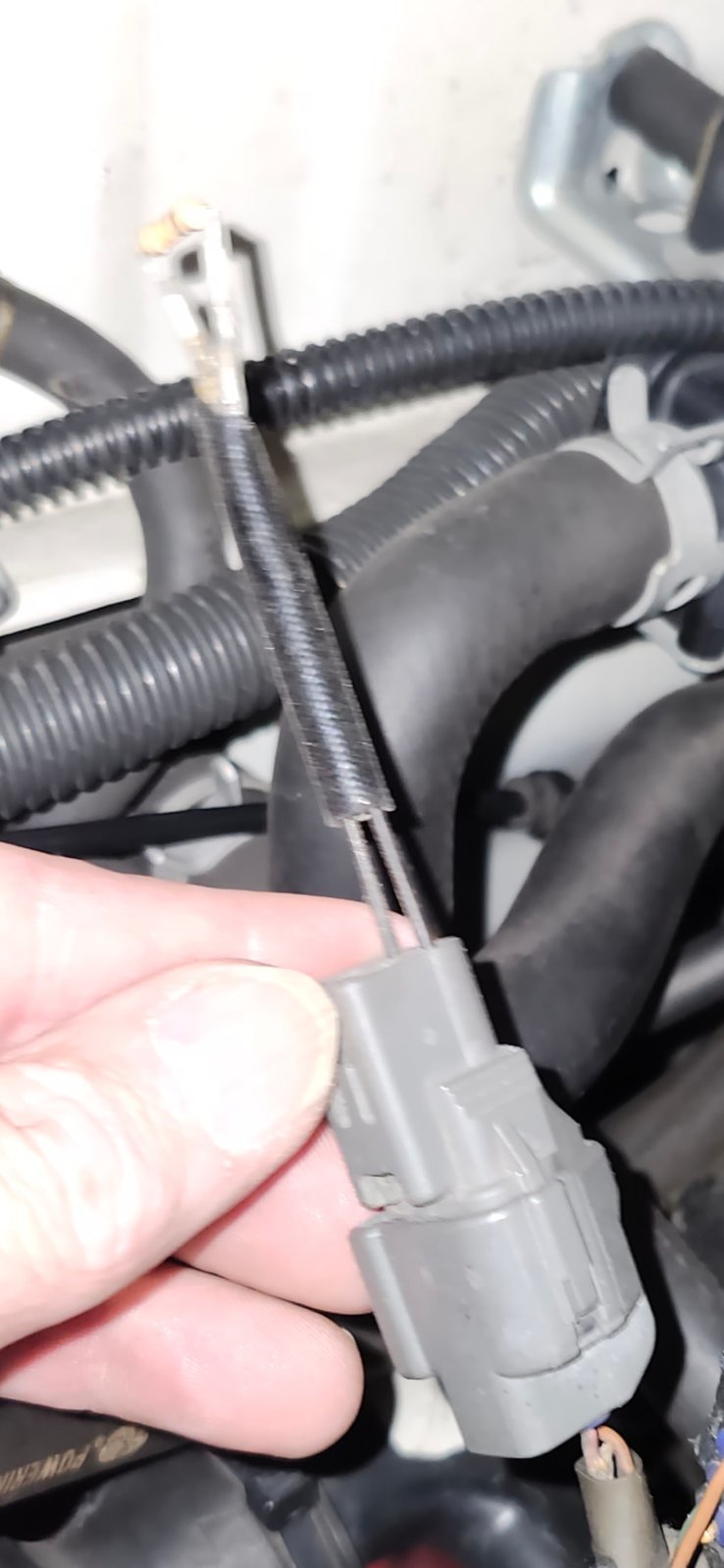

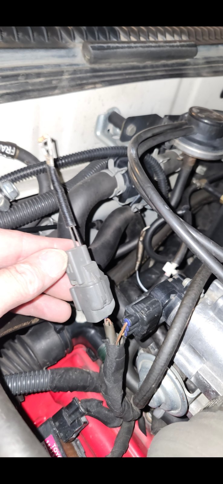

    Just did emissions and passed with flying colors.
    I deleted the egr valve and egr exhaust tube and unplugged all the vacuum lines and block off plates.
    I connected 10k resistor I got from LCE and soldered it into the wire harness after cutting the harness a few inch back.
    Easy easy and No fault codes
