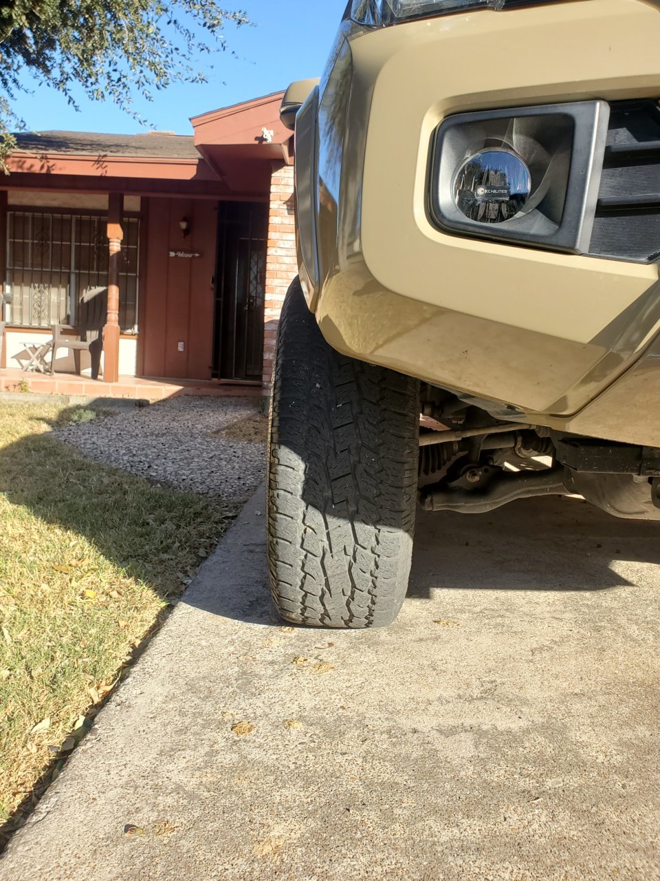

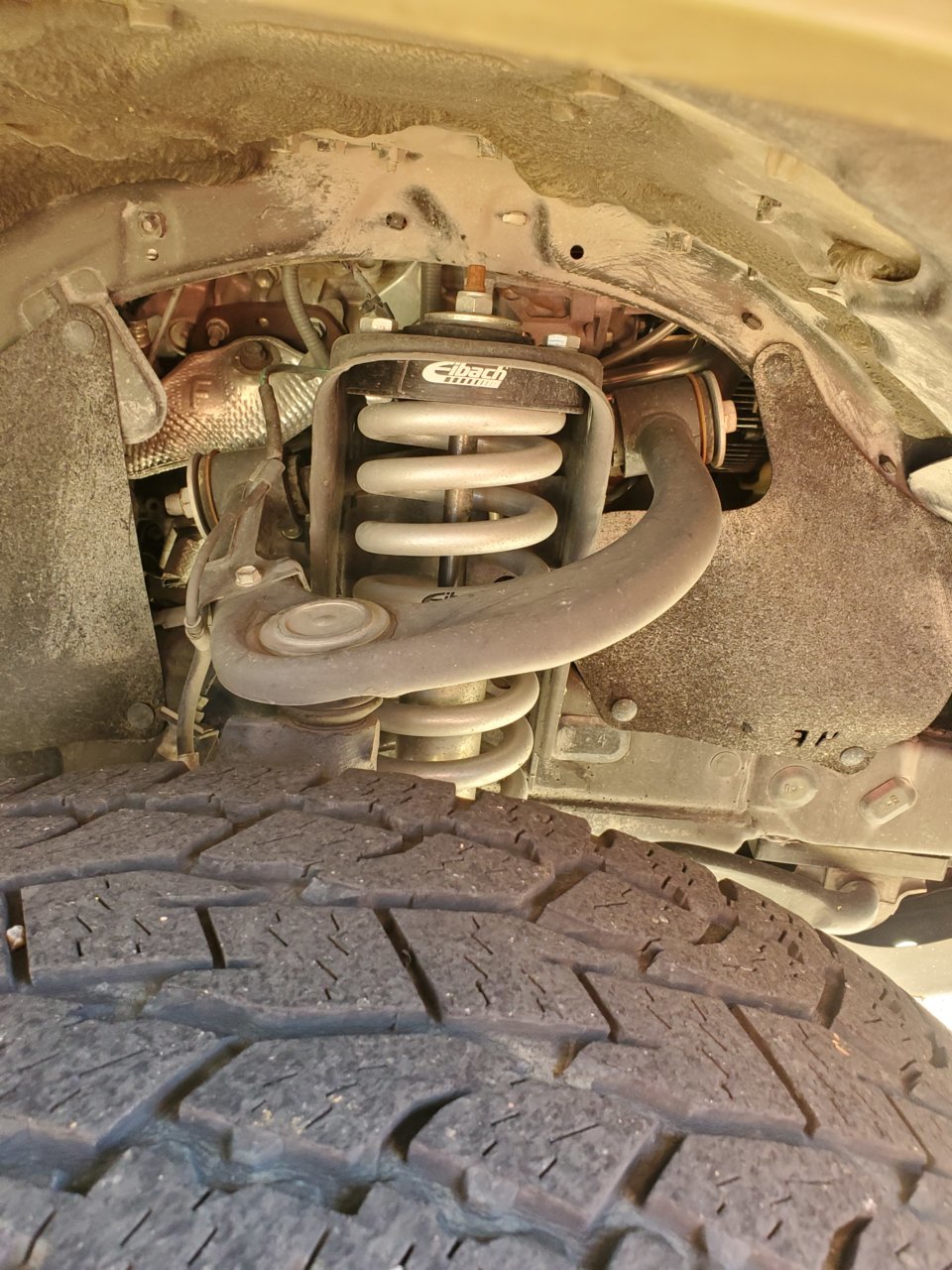

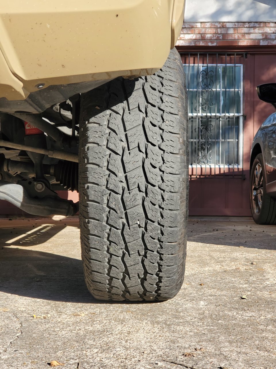

    Hey TW. I got the eibach 2.5 kit installed on my 3rd Gen Sport. Drives and looks great. I'm not sure if I'm just paranoid, but it seems that my front tires have a slight lean to them. (Slanted inward from top to bottom) I'm not sure if the angles of the bumper make it look that way, or if there is a slight angle. I made no changes to ride height from kit, and they do say UCAs are not needed.
    I just had tires rotated, and seems that the ouside of tire looks a little more worn than inside,, could be due to turning but not sure. I want to move up a tire size once these wear out, so want to to sure they can be aligned correctly first,first, I don't burn through black new set of tires. Any feedback would be appreciated!!
    (Pictures it really hard to capture what I see from certain angles)

    You need an alignment

    Did you get an alignment after lift install? You are changing the geometry of your suspension

    Yup, got it aligned, drives fine just sometimes I look at it seem like the tires are ever so slightly Slanted. Like this > \ /

    Had it aligned after intall.

    They clearly have negative camber, needs to be realigned. Make sure to get before and after readouts.
