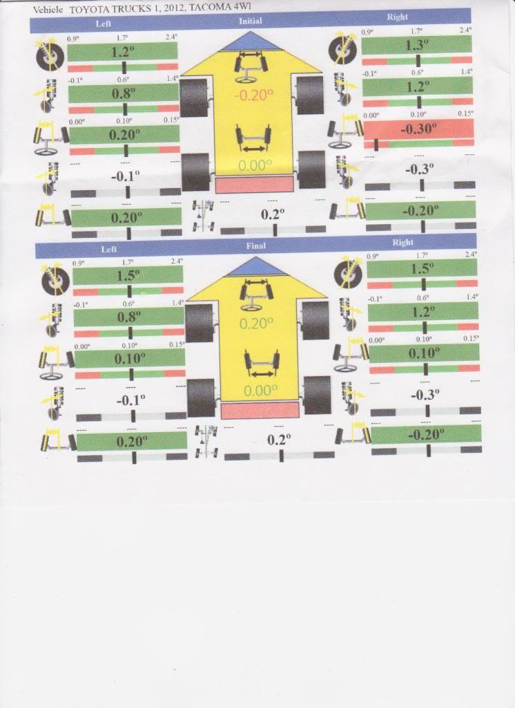

    Got the alignment done today feels pretty good to me. I've included the printout from the shop. I don't know much about alignments but everything is within spec. they said the only thing that was really out was the toe:confused:. How does it look to all of you?

    British Columbia
    Should be 2.4 - 2.9 caster , 0 camber , 0 toe
    Do you have stock UCA's ?

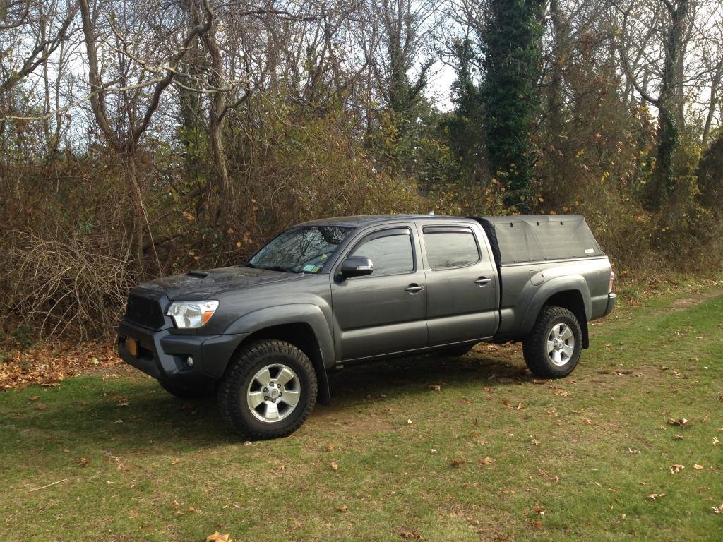

    Here's how she sits today

    Looks good! ^^^
