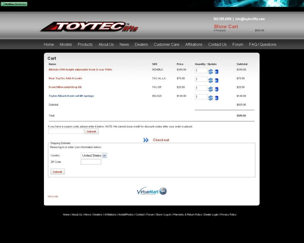

    I Hate to Thread jack but I have question?
    I'm buying some 5100's and Eibach springs with an AAL with 5100's on the back. My question is what should it set the 5100's at my truck sits pretty much level right now because I have a shell on.
    Also I'm getting 33/12.5x15 Duratracks with a 10" rim with a -44mm offset and 3.74" backspacing and I want them to fit nicely with little to no rubbing.
    Here is my cart I'm debating the Dif drop kit but if I don't need it then I don't need it. also I'm going to get the bushing/washer kit it's just not in the cart in the photo.
  15. Sep 9, 2010 at 12:44 PM
    roxspin72
    roxspin72 Enjoying my addiction
    Feb 9, 2008
    #4659
    1,829
    NC
    Speedway Blue, TRD, 4X4,
    Oh Yeah!!!
    5100's up front set to zero with Eibachs. I love the ride, smoother than the 5100's set to 2.5 w/stock coils. I dig the new stance too.
    I am only running TSB 4 leaf pack in the rear, no add-a-leaf. If you run an AAL I would recommend at least the .85 setting.
