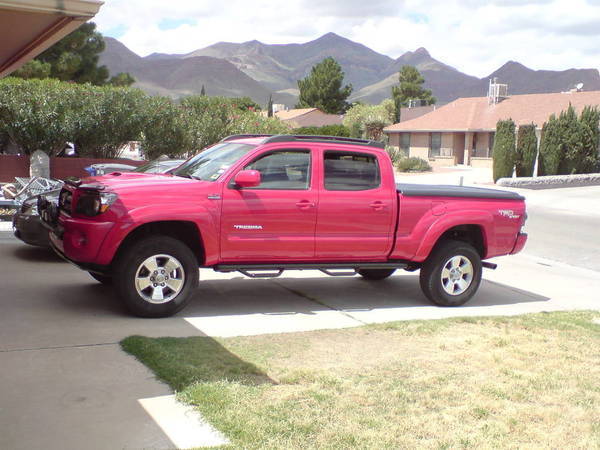

    ViperJay
    ViperJay These are the voyages...
    Oct 29, 2010
    #45416
    312
    El Paso, TX
    05 Radiant Red DCLB Sport 4x4
    URD CAI, DTLT Headers, Vibrant Ultra Quiet Resonator, Aero 2540i muffler, NST Pulleys, URD MAF Calibrator, Icon 2.5 Coilovers , Bilstein 5100s in rear with All Pro 3" Leaf pack, Total Chaos UCAs, 2 Kicker 12" CVT Subwoofers w/Kicker ZX350.2 Amp, JVC KD-AVX77 stereo, ARE Camper Shell, 1 20" LED bar and 2 7" LED bars in front, 4 KC 6" HID Slimlites mounted on Bajarack roof rack, sliders, Cobra 29 XLR CB Radio, Icom IC-207H UHF/VHF Radio, Bed Lighting, Fog light mod, Projector Retrofit Headlights HID 5000k, HID fog lights 4300k, BHLM, LED taillights and turn signals, Glassworks front fenders, Blue Sea Fuse Box, Mil-Spec Battery Terminals, Odyssey PC2150 battery, Satoshi Grill, All-Pro Front Bumper
    This is with 5100s at 2.5 and a 2" AAL. Eibachs and new UCAs are going on next month
    Note this was right after installation thats why the rear looks higher, its level now.
    I think with the Eibachs and 5100s @ .85 the lift will still be 2.5
