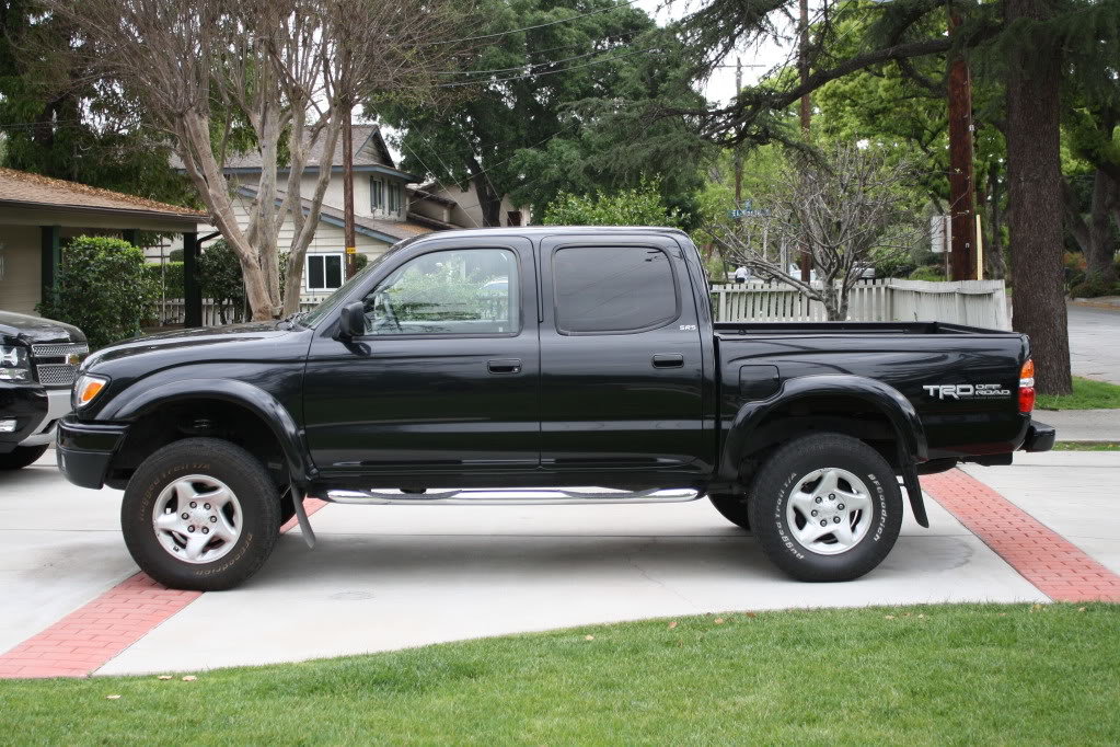

    this is my deciding factor, i really want to put eibachs on my 5100's but i do most city driving and a fair amount of off roading maybe once a month. Would this be a good setup for me or is there a smoother setup for city driving besides the expensive kings?

    Well damn bro', looks great, nice stance....;)
