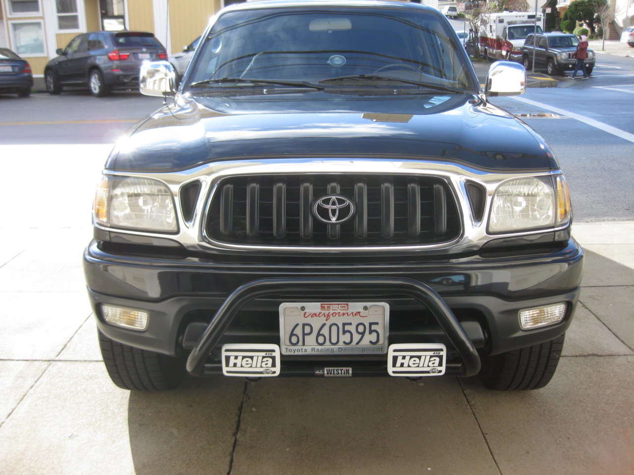

    Mine never had Taco Lean, front or back. I've been lucky because I know it does exist having read of so many here. Granted, I never lifted nor replaced the original springs.
