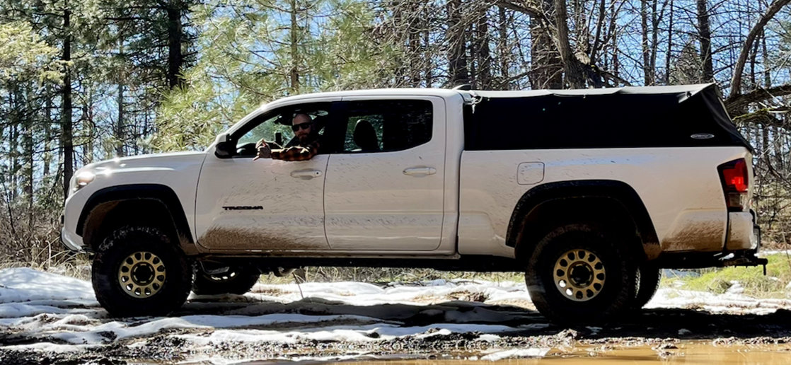

    How much weight are you carrying behind that softopper?
  12. Mar 22, 2021 at 4:06 PM
    71tattooguy
    71tattooguy Well-Known Member
    Dec 19, 2018
    #276275
    5,880
    Dino
    Petaluma , Ca (707)
    2019 DCLB TRD OFF- ROAD
    Kings 2.5” front and rears from Accutune / ICON RXT LEAF PACK black badges doors and tailgate / method 315 / 255/85/16 Yokohama G003 / magnaflow exhaust , axle dump / meso int delete kit / meso led map lights / dome lights / wheelers front super bumps / accutune Flip kit with spacer and new bumps / Cali raised fog light pods / Cali raised ditch lights / RCI FULL SKIDS / SLIDERS / RCI rear bumper / rigid backup lights / tuned on 4.88’s
    In this pic not much. Maybe 100 pounds
    530Taco[QUOTED] likes this.
