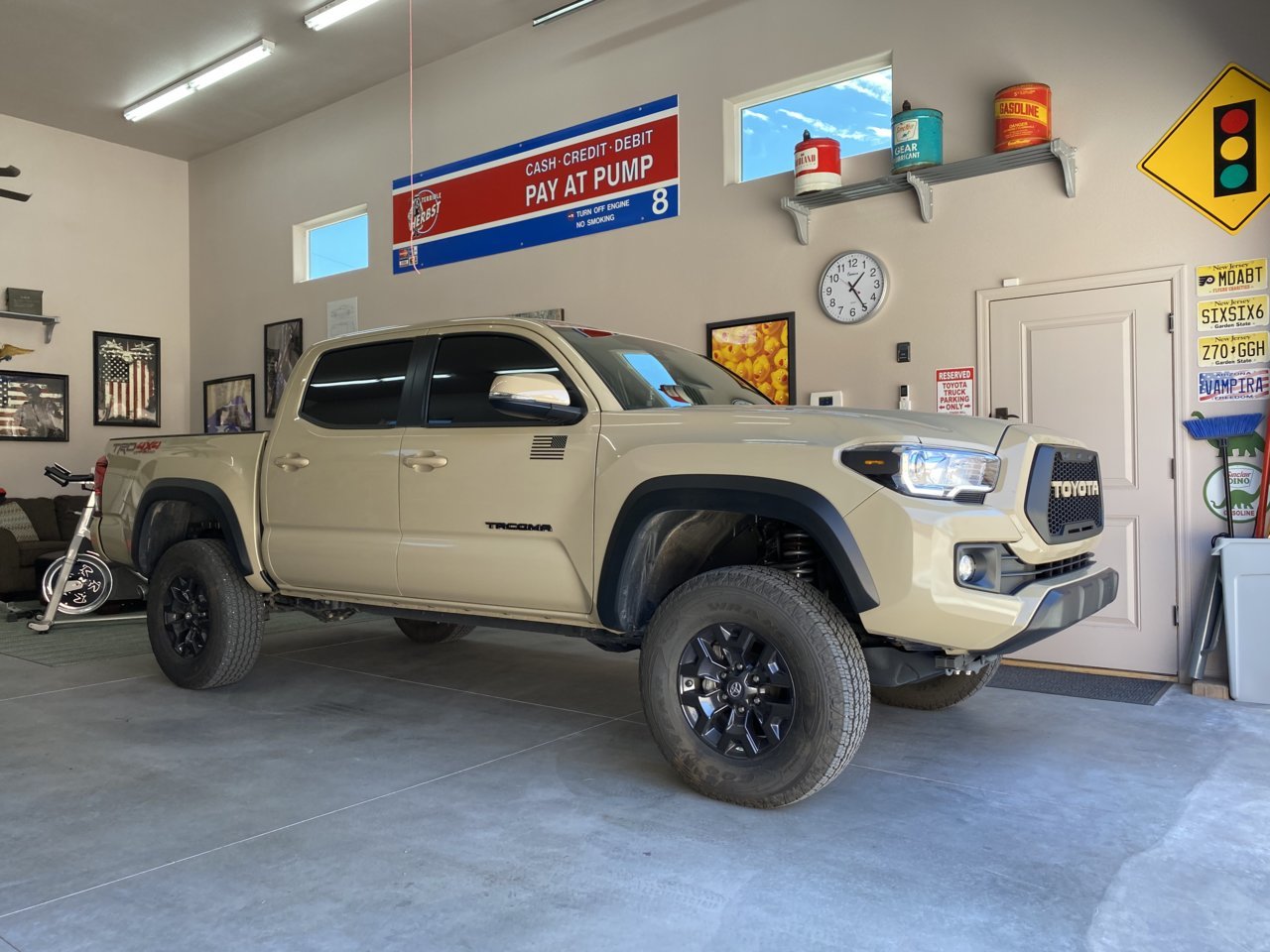

    2019 Quicksand TRD OR
    Got my kit installed today!
    2nd clip on the front, wheelers 2” aal in the rear. The installer left the overload leaf in even though I said he could remove it. Glad he left it in because the truck sits with a little rake still, which is what I was hoping for.
    I only drove about 7 miles home with the kit on from the shop, and its a night and day difference in ride from the stock suspension to me. Rides so much smoother, eats up bumps better, and I dont feel body roll in turns. If youre on the fence about this kit I would highly recommend it. Ive had a smile on my face since I picked it up and thats what its all about!
    Wheels and tires are stock currently. Will have a new setup on order this week or next.

    Looks great!
    Ninejuanjuan[QUOTED] likes this.

    That looks great!

    I did not measure. I didnt take any pre-lift measurements to go off of, but if you guys would like I could give it a try in measuring it today. Id say I got atleast 2.5” of lift, as my husbands’s 4runner is lifted 3inches and I am about half an inch lower than the 4runner currently.
