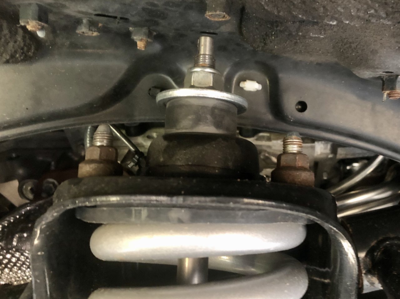

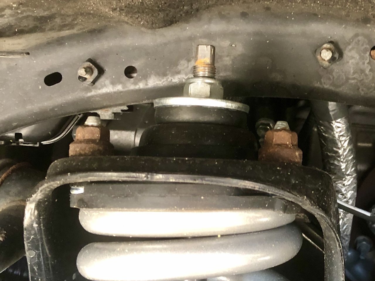

    Under side bushing is missing from strut mount, we see this a lot and I honestly don't know how a shop can miss this when doing the assembly.
    For those getting these installed, check for inconsistencies from one side to another before leaving the shop

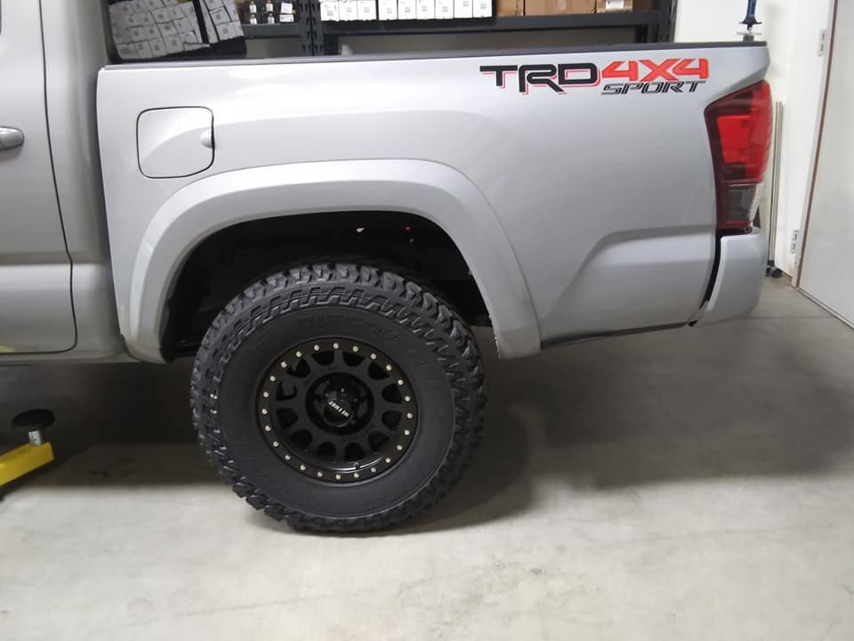

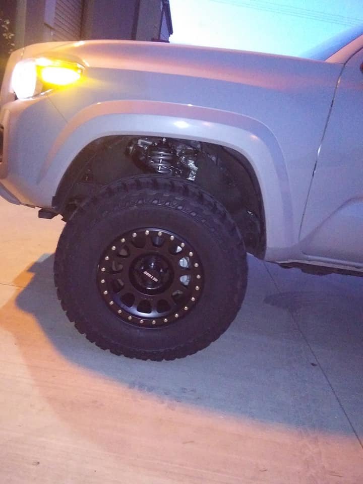

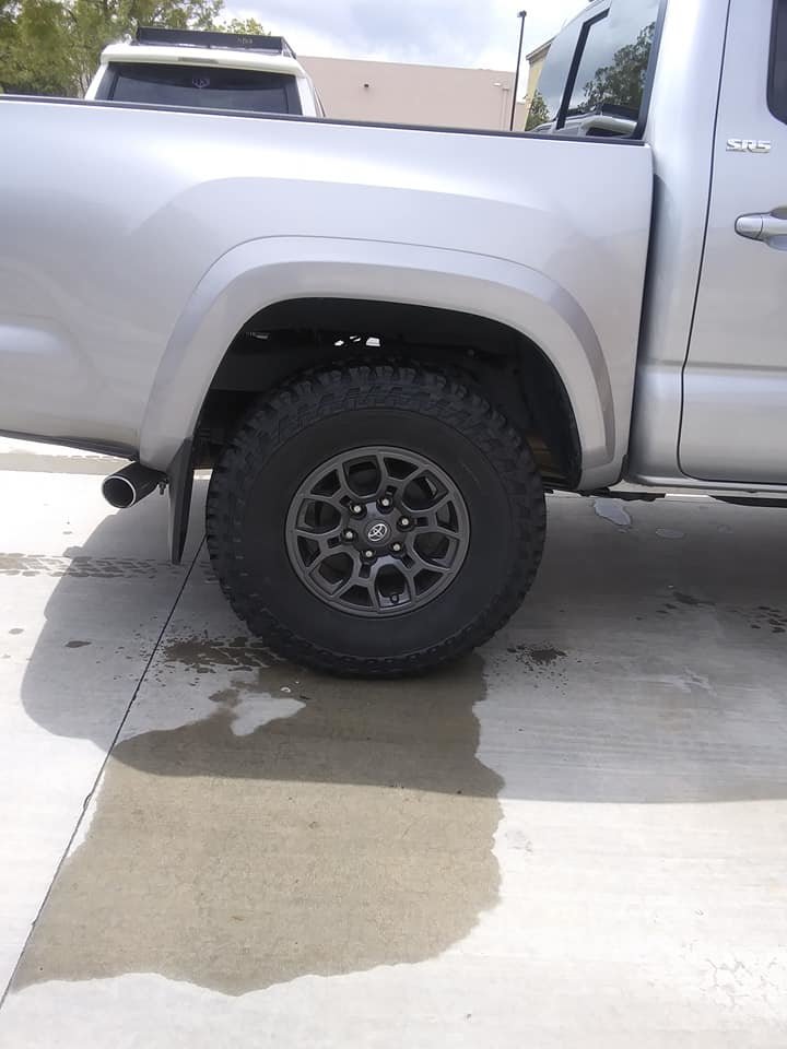

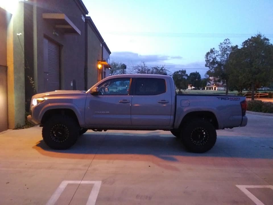

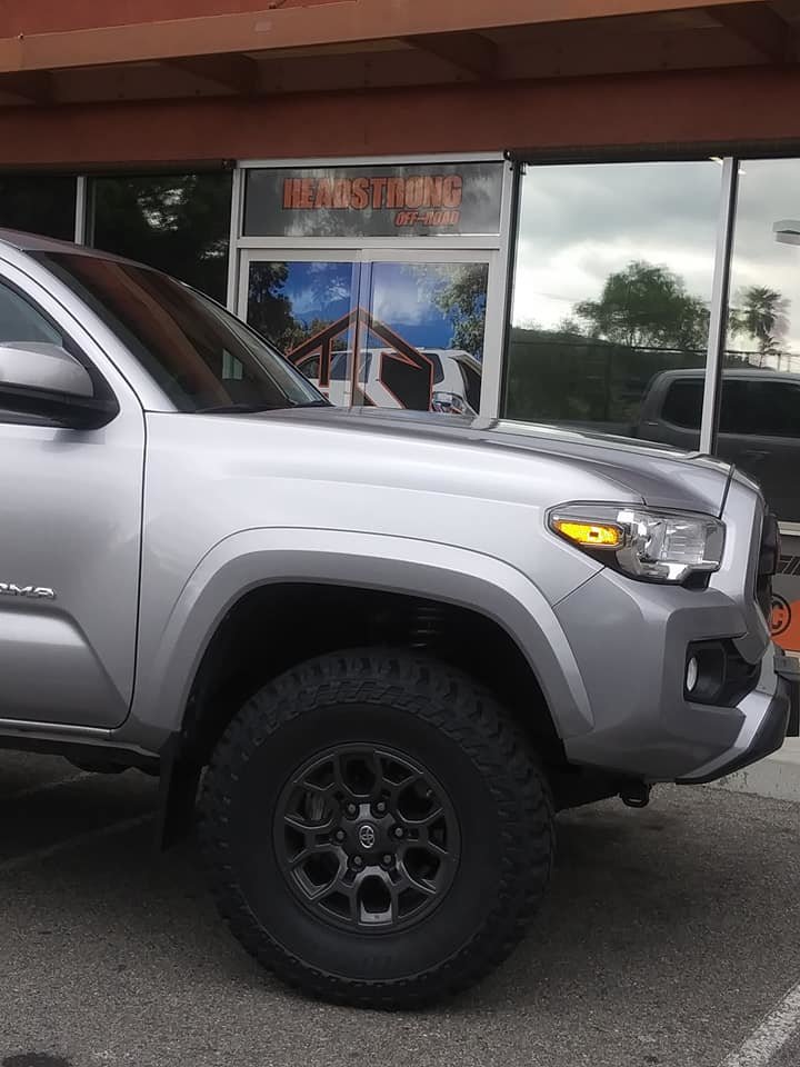

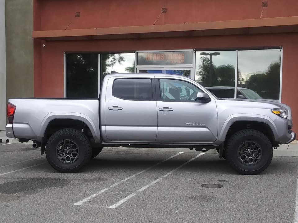

    This weekend we did two installs of the pro kits. One on a 2019 TRD Sport and one on @aust 2018 SR5. Each are a 4x4 v6 auto and both had around 1/2 tank of fuel.
    Each did the Eibachs at the 1st notch setting and the supplied HS 1/4" top plate spacer on the drivers side and the newly redesigned HS 3-leaf add-a-leaf https://www.tacomaworld.com/threads/now-available-all-new-redesigned-hs-3-leaf-aal.658544/
    The pre-lift measurements on the 2019 Sport were:
    Drivers side 20 3/4
    Passengers side front 20 7/8
    Drivers side rear 21 3/4
    Passengers side rear 21 3/4
    94386705_10219898958416779_5606988657132_82566dd68cc60562db746042d86c6895f069a55e.jpg
    93888725_10219898959376803_8307361168813_6467dd3822f9d27cf97a92b27c8233853bb2672d.jpg
    The after-lift measurements were
    Drivers side 22 1/2
    Passengers side front 22 1/2
    Drivers side rear 23 1/2
    Passengers side rear 23 1/2
    Net Lift:
    Drivers side 1 3/4"
    Passengers side front 1 5/8"
    Drivers side rear 1 3/4"
    Passengers side rear 1 3/4"
    94392733_10219898956176723_8884280340156_2c479065fa48699f89f1afb79f7923b012017c26.jpg
    93422722_10219898955776713_8419361701006_f61e751bd3832206a4d9e0e82a45f0ed8bc11f27.jpg
    94025668_10219898957976768_4272222253006_672b49471891426356d81b48b6d14572f4eabae4.jpg

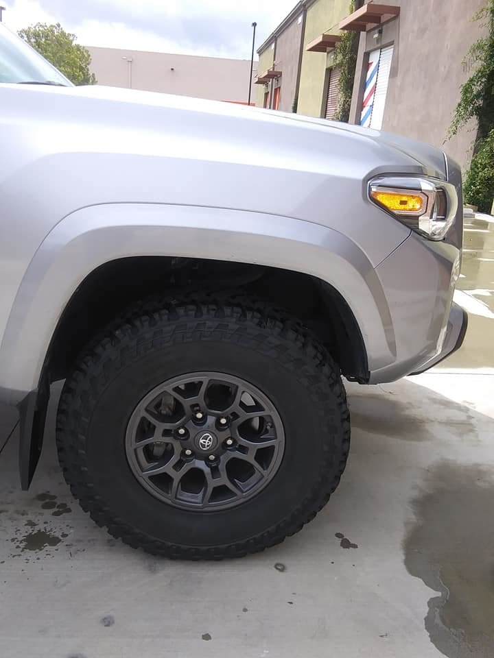

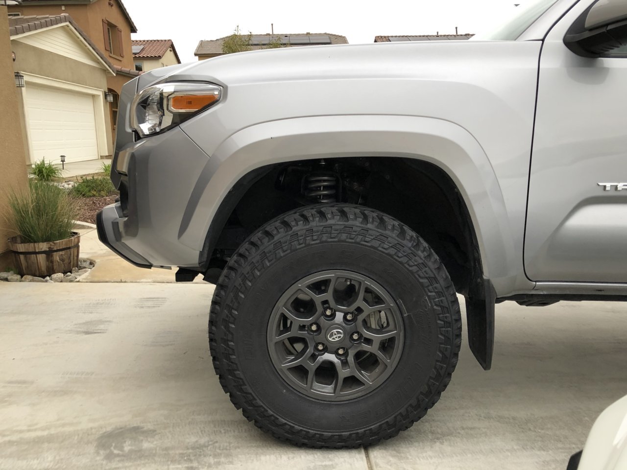

    The pre-lift measurements on the 2018 SR5 were:
    Drivers side 20 1/2
    Passengers side front 20 3/4
    Drivers side rear 21 1/4
    Passengers side rear 21 5/8
    93665875_10219898951816614_5876793889871_dc27d6d1685de58c088e9be5b830b8853d1d74eb.jpg
    94268156_10219898952296626_6940668047984_e97bac1880fed59d2990c6465f62e8d67f357fab.jpg
    93439429_10219898953016644_3782334301790_f0c9a7a722e18e21944aeeb6569bd5097896e921.jpg
    Drivers side 22 1/2
    Net Lift:
    Drivers side 2 1/4"
    Passengers side front 2"
    Drivers side rear 2.25"
    Passengers side rear 1 7/8"
    93569784_10219898948936542_7461354625564_800f3914e14459db12699f5936f0f1087e44d923.jpg
    93779628_10219898949936567_2188573643070_b6bf308f1ce32f4462d9204928b76316cda4fc62.jpg
    93796420_10219898950776588_5486071150062_3d23d131ce55d5bc97a3e39355d2bc8c4b368f29.jpg
    93607306_10219898951256600_7036752947501_85532d595acd533f7823d1e15becbdba3d6d2784.jpg

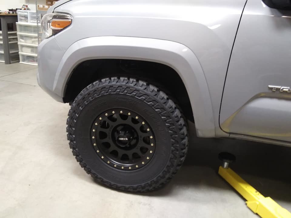

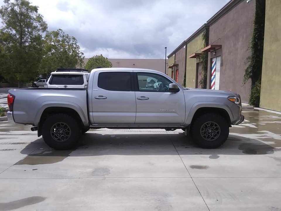

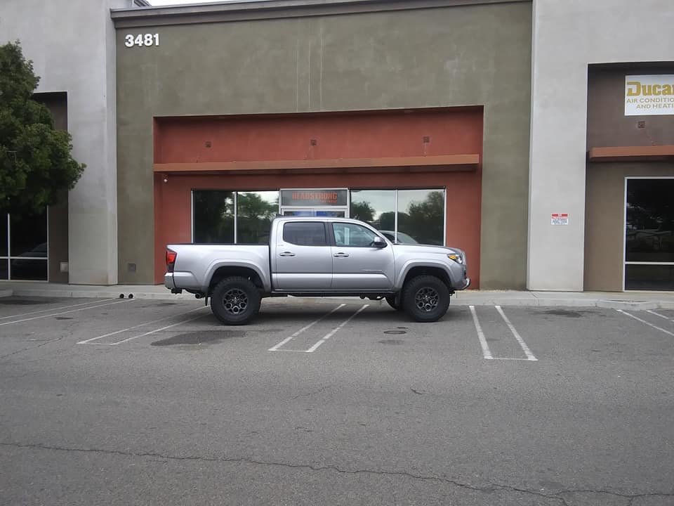

    Eibach Pro Kit 1.5" rear blocks 285/70R17 Ridge Grapplers
    Not the best pics with the weather but here are a couple after the lift. Bottom notch, HS 1/4' spacer, 1.5" blocks in rear. I wanted to keep some rake. For whatever reason the rake looks more pronounced in pictures than in person.
    Big thanks to HS off-road, definitely worth the money to have the struts assembled!

    Kings 2.5” front and rears from Accutune / ICON RXT LEAF PACK black badges doors and tailgate / method 315 / 255/85/16 Yokohama G003 / magnaflow exhaust , axle dump / meso int delete kit / meso led map lights / dome lights / wheelers front super bumps / accutune Flip kit with spacer and new bumps / Cali raised fog light pods / Cali raised ditch lights / RCI FULL SKIDS / SLIDERS / RCI rear bumper / rigid backup lights / tuned on 4.88’s
    Looking good. Rake is good it’s a truck
