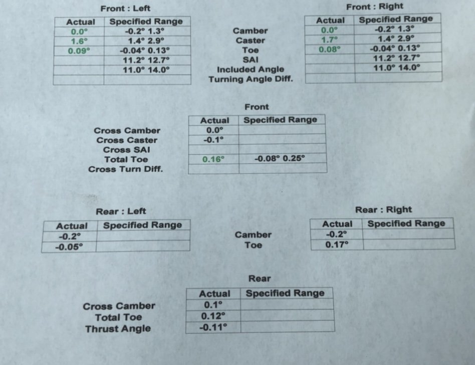

    It is in spec so maybe there is no issue. The steering wheel is slightly off center and, maybe it's just me, but the positive camber look just irks me. I'd really like to get it closer to 0, at least to where it doesn't look angled when it's parked.
    This one that someone posted 15 or so pages back seems like it would be better? I'm no expert on alignments at all though
    Maybe someone else can chime in?

    Pos Camber is better for wear and a better feel while driving. I would keep it where it's at. as far as the steering wheel being off that's a total toe adjustment and if you take it back to the they will readjust it at no charge.

    It bothers me more that the rear toe is so jacked (though you really cant see it) Mine is worse.

    Ok, I didn't know that. So do you think there would be any benefit of aftermarket UCA's and the caster being set closer to 2.5-3? Seems like a there are a lot of people that suggest that.

    Caster gives you steering return and stability on the road and will not cause tire wear, so getting the caster up a little wont hurt, would it be better...??? I guess it would depend on if you have a problem driving it or not.

    I do know on a lifted Wrangler the caster needs to be set high to help with "Death wobble" but I don't think Tacoma's have that problem?

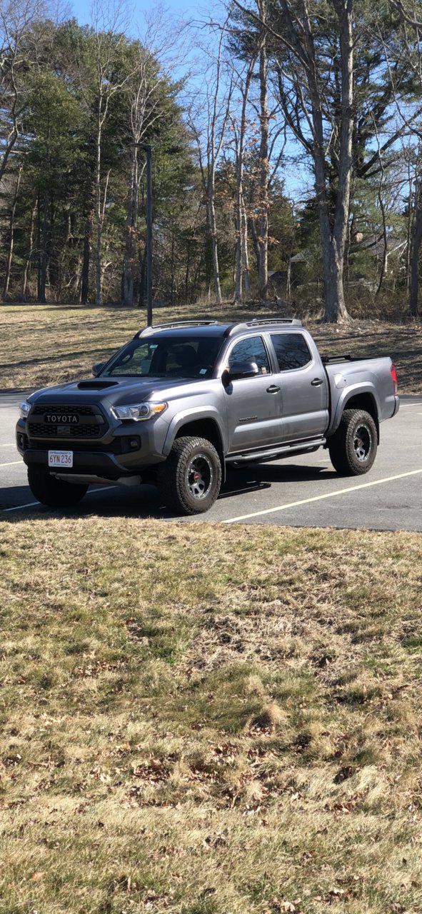

  20. Apr 23, 2020 at 11:50 AM
    #2140
    tn111
    tn111 Well-Known Member
    Dec 4, 2017
    #237607
    206
    2018 TRD Sport 4x4 MT
    Here’s mine when it had 265/70/16 tires which is stock size for the off road. It didn’t look too disproportionate in my opinion and it was like that for about 5 months and didn’t bother me. This was at the lowest setting with a 1.5” AAL
