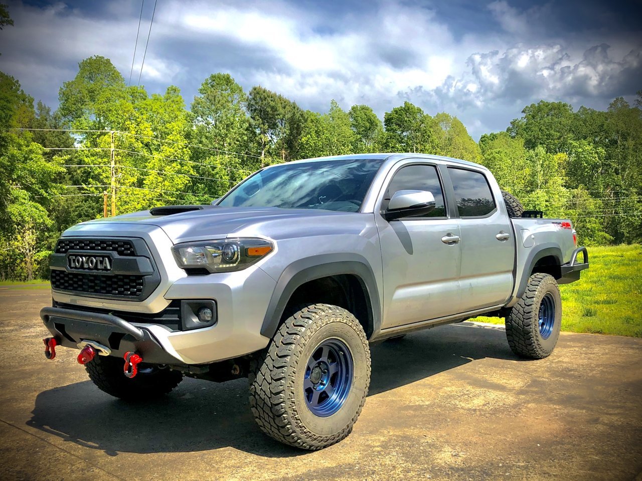

    I ran the 2nd notch with SOS Concepts streamline and Smitty X2O 10k winch :thumbsup:
    rear is 3 leaf AAL with overload left in
    It’s on a bit of an incline, so it looks like it has a bit of a squat, but the truck is level here.

    Looks good! What size are those tire?

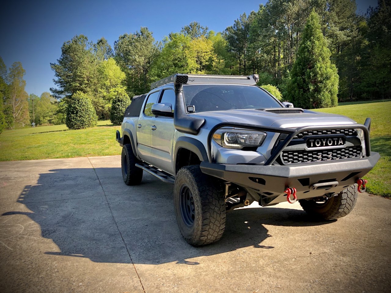

    285/75/16
    Truck looks a bit different now, but still loving the Eibach suspension and still on the 2nd notch up front.. It’s handling the extra weight quite nicely :thumbsup:

    IMO looks much better with a lift in the rear. Otherwise they look nose high.

    Looks good with no lift in the rear

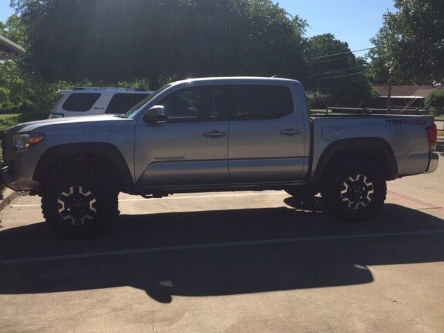

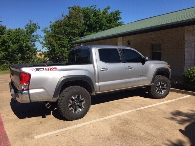

    Eibach's set at the bottom notch with hs 3 aal, overload off. parking lot is not level. 778FFBA8-7E45-48F4-BC08-621A522848A5.jpg

    Perfect! Your truck looks great. What size Falkens are you running? How are you liking them?

    265/75/16

    I have these currently and I've gotten of 60k miles on them. Still have some tread left. I'm gonna replace them in the next couple months but they have been awesome.

    Good looking rig. So you did leave the overload in....how’s the ride been since you left it in? Did it give you the 2” in rear with in or 2.5”? I’m debating on to leave it in or take it out.

    left it in. It gave about 2.25” in the rear before I put on the rear HC with swingout, spare, and jerry can. It’s down to about 1.75” lift now lol
    the overload doesn’t effect the ride quality it simply helps limit the amount of squat in the rear when there is weight in the bed or towing.
    the front hasn’t lost but around 1/4” from the streamline (68lbs) to a full plate front and full skids.

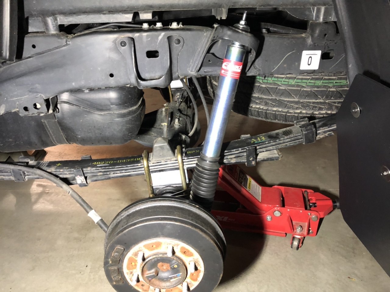

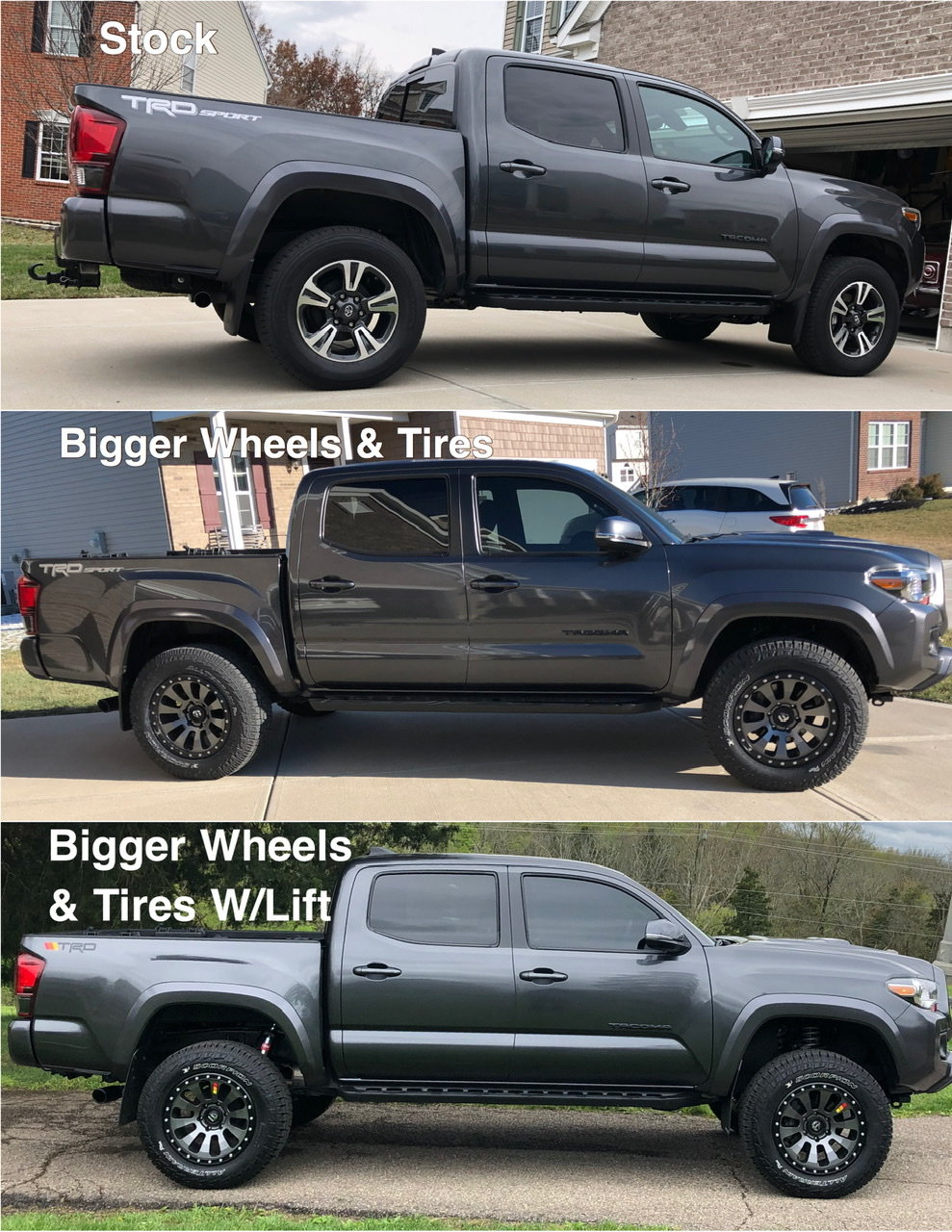

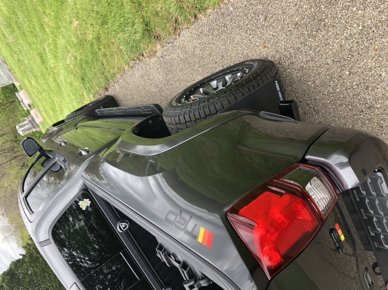

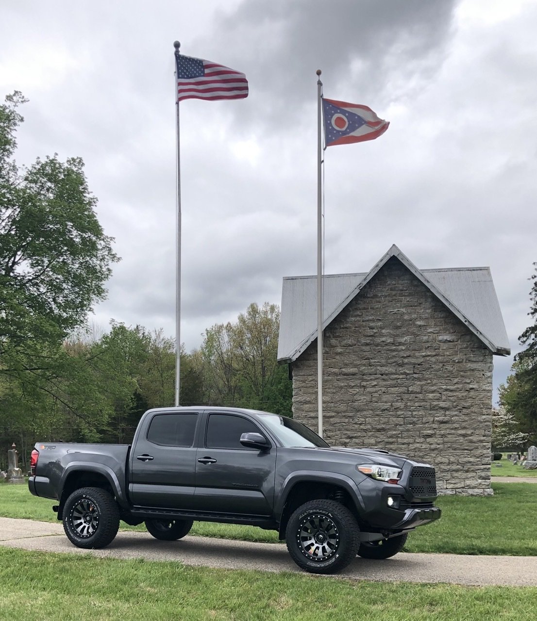

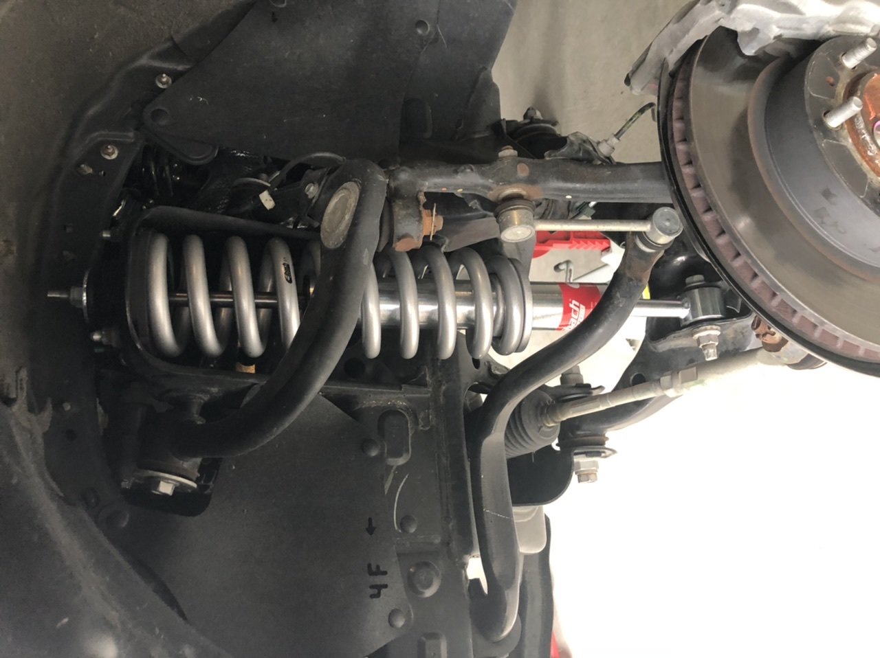

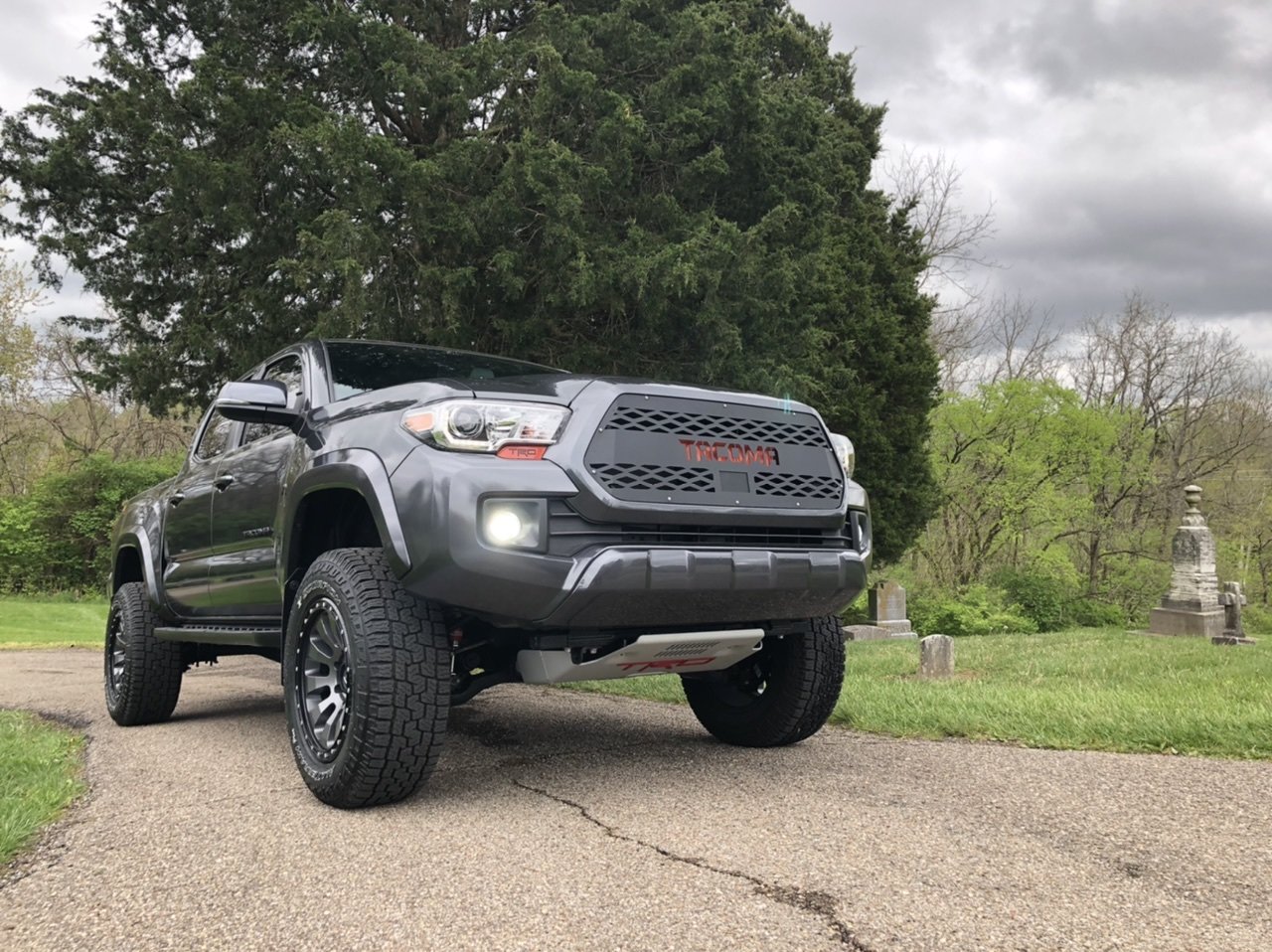

    Eibach Pro-Truck Lift installed and aligned! Bottom perch setting up front and 1.5” block with 3 degree shim in the rear. With the bigger wheels and tires and lift, it sits a little over 3” over stock all the way around. Also added the Rek-Gen mud flaps and a TRD skid plate.

    265/70/17s? or even bigger than that? Just curious, looks good mate.
