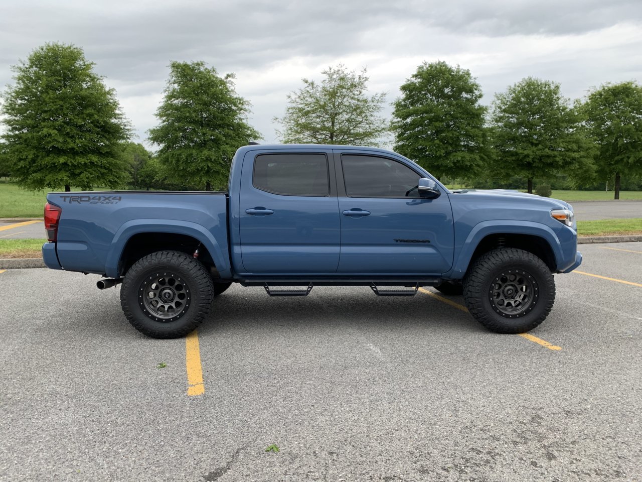

    Just curious, did the 3 degree shims solve the vibes for you? I have the same setup with 1.5” block and have slight vibes around 55mph. I was looking into getting some shims or swapping to AAL if people are having good experiences with them as far as not having vibes. Thanks man and your truck looks great!

    Some blocks are already tapered to correct the pinion angle. Have you checked yours to see if they are or not?

    I’ve looked at those also. Mine are not tapered
    There are some on eBay that are tapered for about the same price as shims.
    She’s looking great though!

    I took the advice of Toytec and added them from the start. Went for a quick drive today and didn’t notice any vibes.

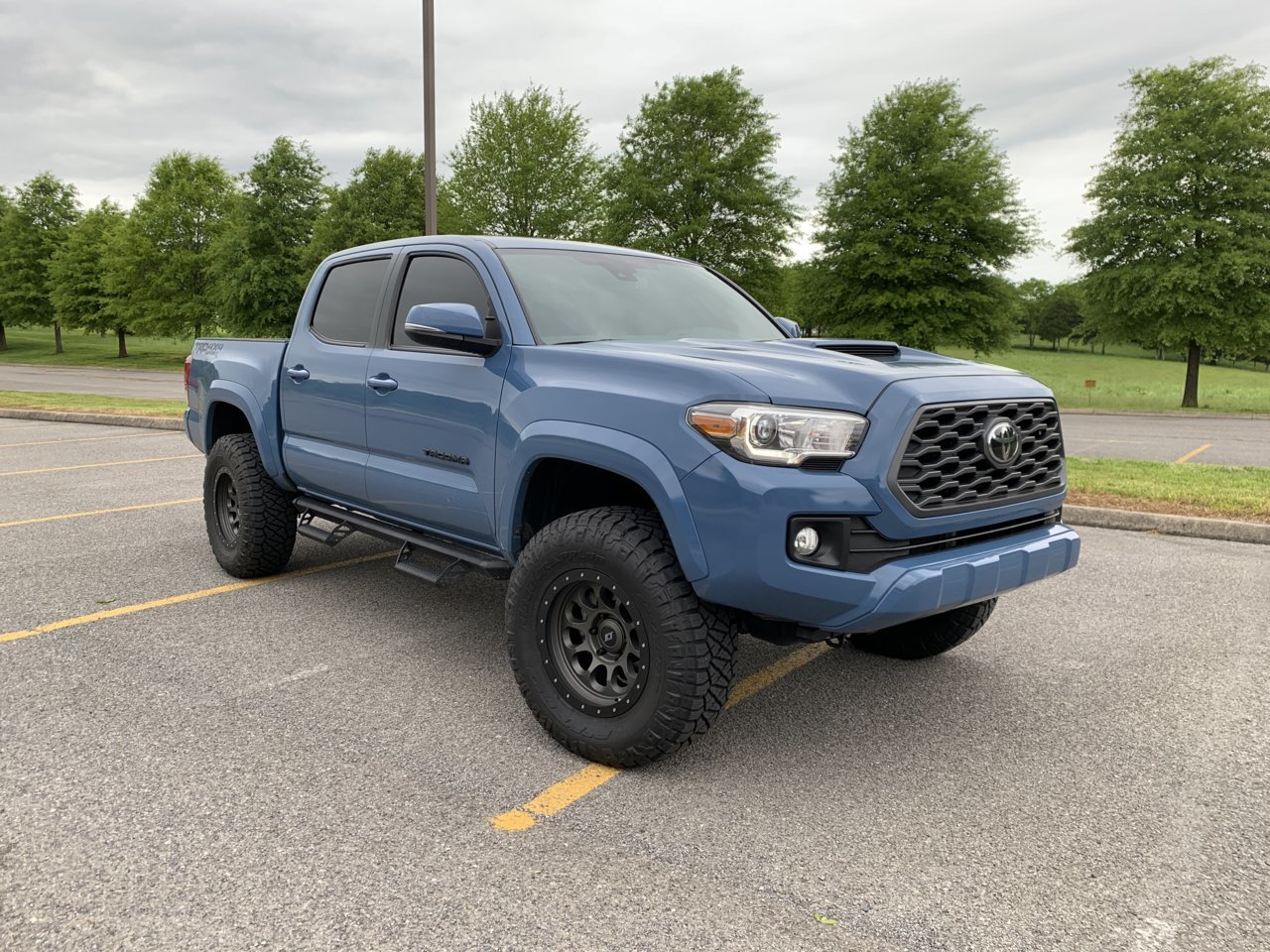

    Awesome! Thanks for the reply back. I ordered the same lift and rear leafs. Just wanted to see how yours was set up. Your truck sits perfect to me! Great job.
