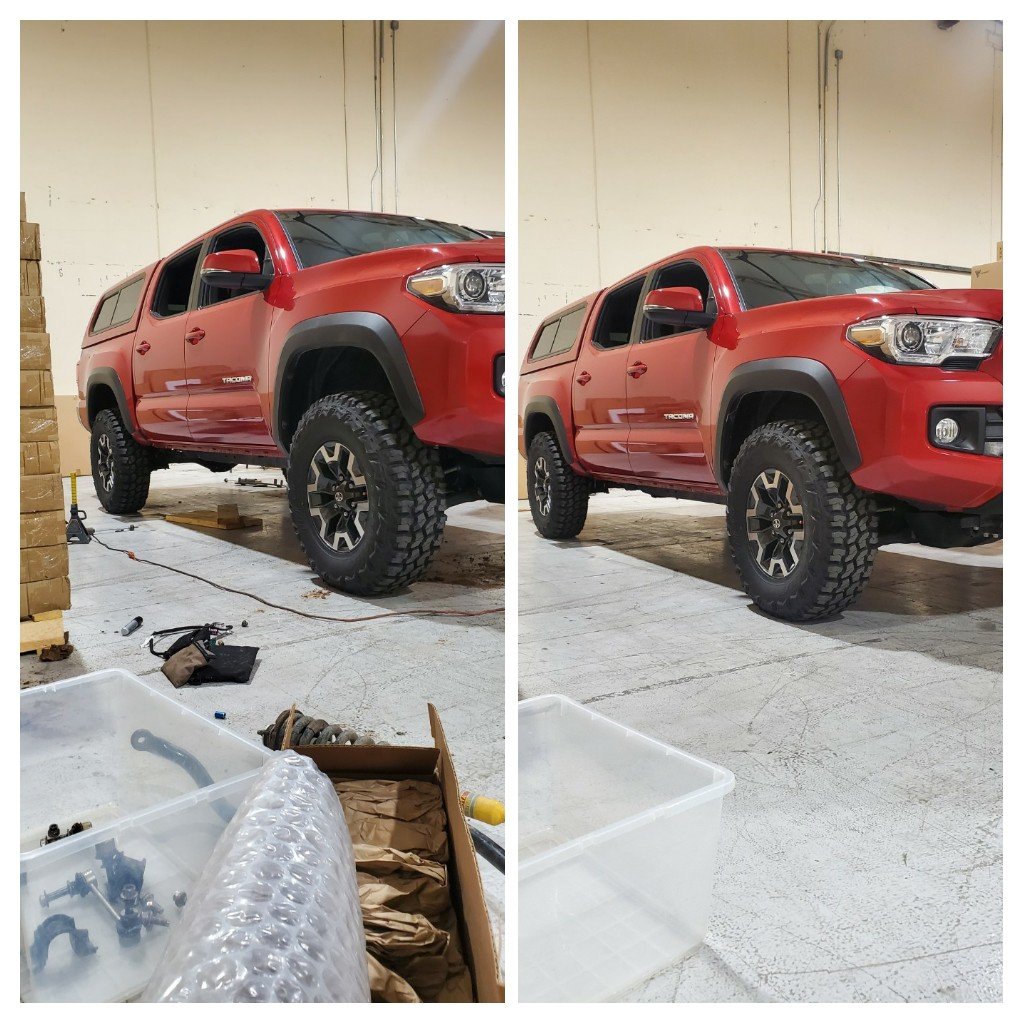

    Installed mine today! 1st notch up front with 1/4" Spacer on drivers side. 1.5" HeadStrong aal in the back (no grinding required except center bolt thanks to new aal design, install was a breeze) . Also did sway bar delete. Absolutely loving it so far. Feels a lot more planted than stock OR suspension and I don't feel tossed/bounced around nearly as much. :bananadance:20200501_183355-COLLAGE.jpg

    Looking good man, it’s crazy what a difference these kits make! Did you end up with 1-1.5” rake with that setup?:thumbsup:

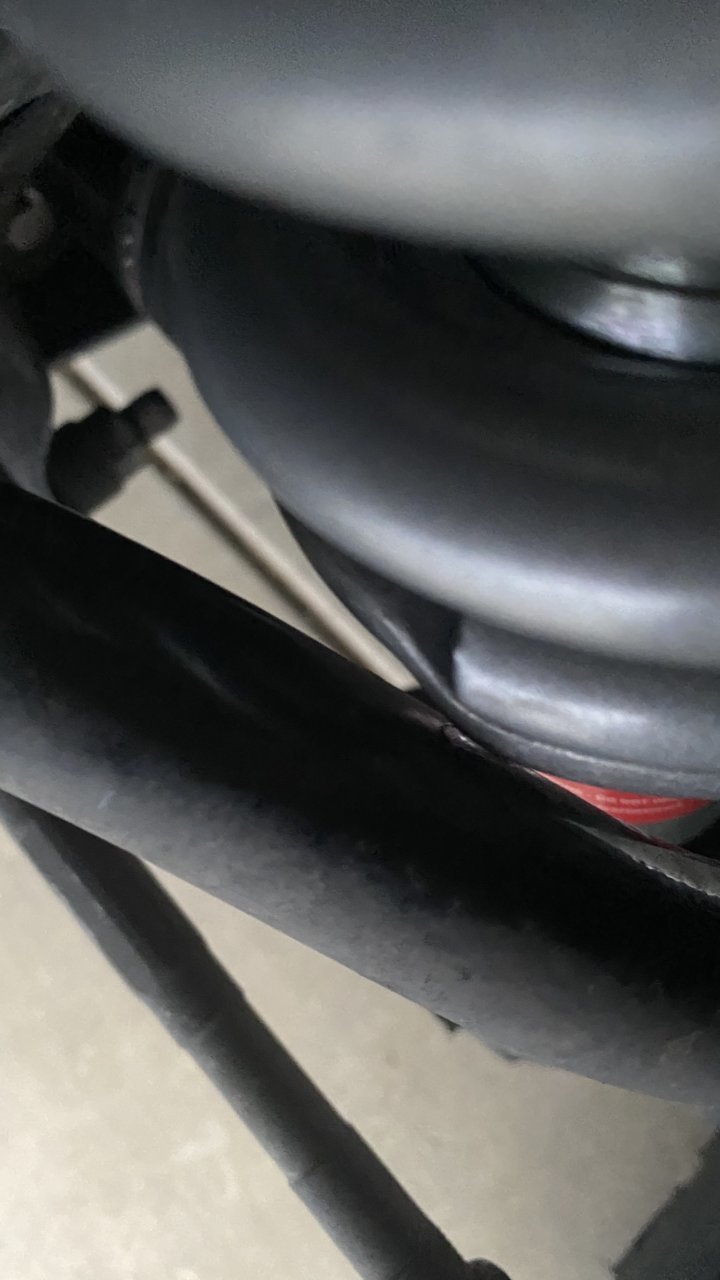

    Go ahead and install them. That will straighten out when the weight of the vehicle is on them. It is just the coil spring putting pressure on the rubber bushing. The Tacoma's use a coil spring that is not completely square so it will force the bushing into a weird shape until weight is on them.

    what’s wrong with them? I see the bushing squished. Is that what you’re referring to? Have you reached out to HS before posting?

    Yeah I get your point, However I have contacted them by phone and on this forum with no response. I’m a big boy and if I’m wrong I’ll say I’m wrong and everyone else who may have the same scenario as me will see. Yes I am frustrated, not just with this but I decided to do the ECGS install at the same time and nothing has gone according to plan. All those videos I’ve watched where no one has a problem is like salt in the wound. I’ve been fighting for over an hour just trying to get my cv axle back it. It’s gonna be a long day.

    About 3/4" of rake currently (measured by fender gap). Looks almost perfectly level. I will get full detailed measurements Monday after it has time and miles to settle a bit.

    Ok so the front is done including the ecgs bushing. It does appear at this point that I was wrong about the shocks being uneven. It’s very strange that not one video pointed that out and I’ve seen a few. They do straighten out. So far so good.

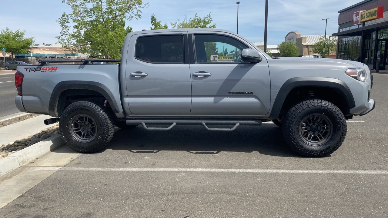

    Lol. I thought this was my Taco. Same wheels, tires, lift and truck rack. You have good taste.
