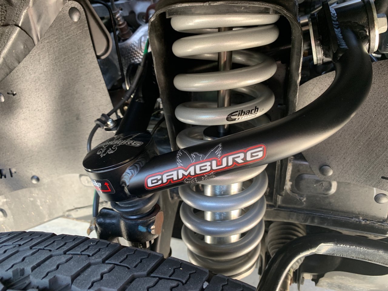

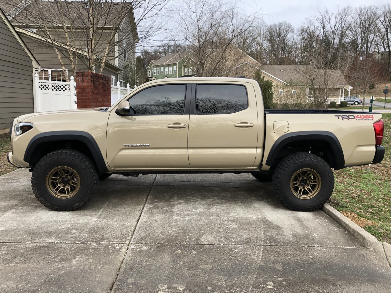

    I just were just changed the springs on the shocks to the top ring on the driver side and the middle ring on the passenger side. The truck is now is now sitting at about 38 ¼” all the way around, it is extremely stable even when going over large bumps or through dips. The truck again rides and handles extremely nice. I do feel the road just a bit more than I used to.I’d recommend that if you know you will soon be adding a front bumper with winch and other armor, then start your Stage 1 lift on the middle ring. That would have saved me the cost, time, and aggravation of having to make the changes.
    I initially added my Eibach Pro Stage 1 lift and Icon Progressive AAL with 285/70-17 tires & wheels last year before adding much else. The springs were installed on the bottom ring of the shocks and I did nothing about the Taco Lean. Those changes made my 2019 TRD OR Taco handle like I expected it should have from the factory
    Since then: Victory 4x4; Strike Rock Sliders, Blitz Front Winch Bumper, and Roof Rack + Toyota bed mat, Diamondback Tonneau cover, and Smittybilt winch and tent and heaver skid plate installed. The Tacoma’s ride was really changing back to what it was when stock with the front end dipping when breaking and truck floating after speed bumps, and the front left set about ¾” lower than the rest. I'm happy again. Just a lesson learned being passed on.

    Eibach Pro Truck Lift HS AAL Camburg UCA’s
    Thank you HeadStrong
    Just installed Eibach Pro Truck lift and Camburg UCA’s along with the HeadStrong 3 leaf AAL (overload leaf removed). I ordered the kit pre assembled with new top hats and 1/4” spacer for the driver’s side.
    The install went as planned with no surprises and the ride quality has improved greatly. The ride is comfortable, stable, and has the right amount of firmness.
    The struts are set on the 2nd notch and I ended up with 2-1/2” lift in the front and 1-5/8” in the rear. I had close to 2” rake before the lift so the truck looks level with slight rake to the front. 285’s are next and going on tomorrow.
    Thank you TW for all the input on this laboring decision and huge thanks to Marie at HeadStrong.
