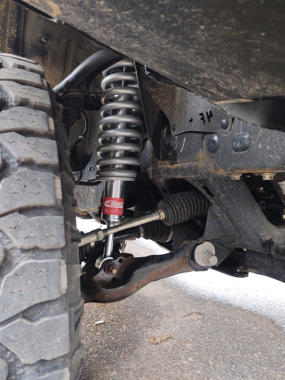

    What notch is the front at ? And what tire size ?

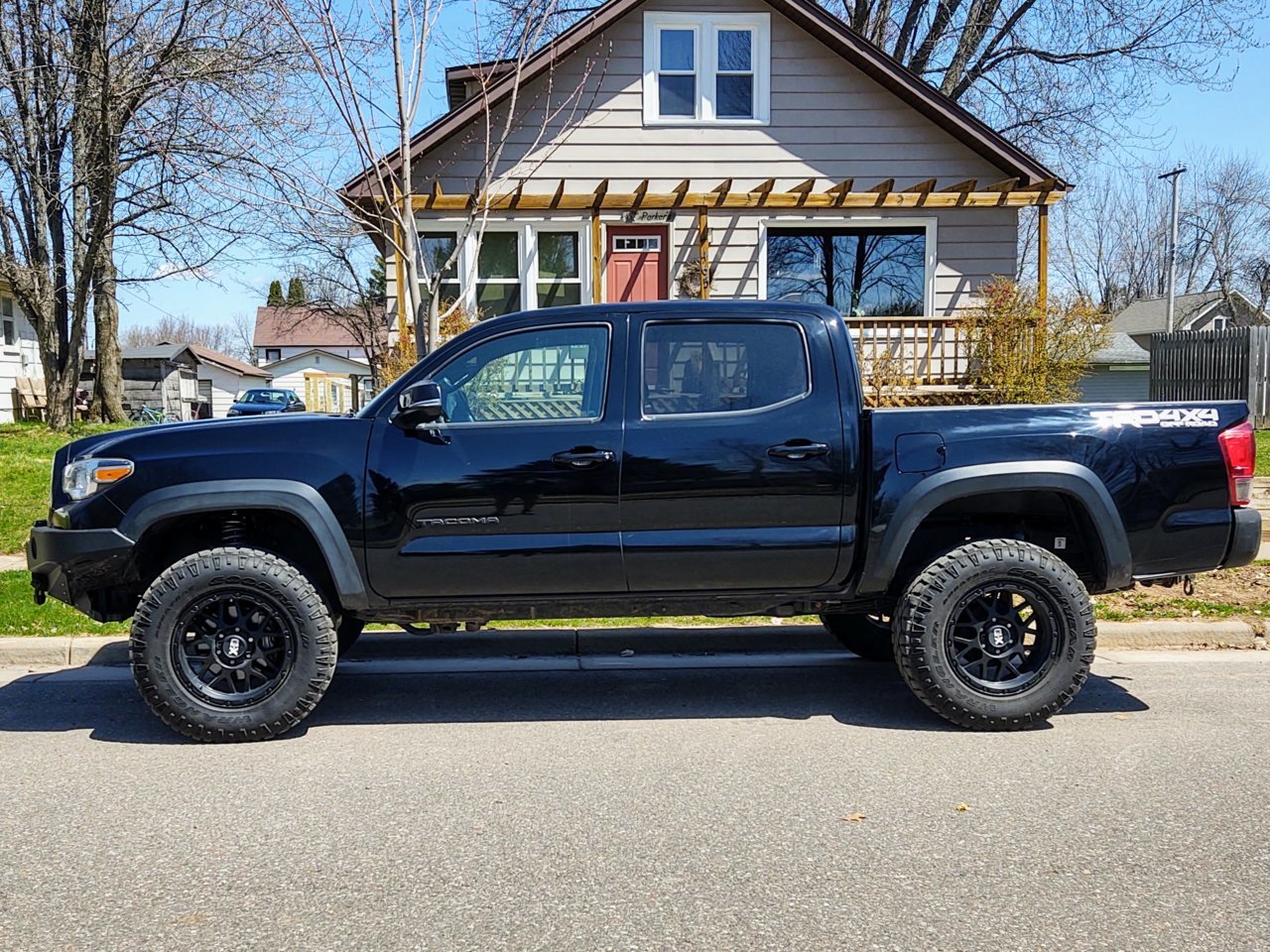

    Bottom notch. 2" lift springs and 1/2" top spacer. 3" total lift. 2.5" remaining down travel. 275/70/18 (33*11)

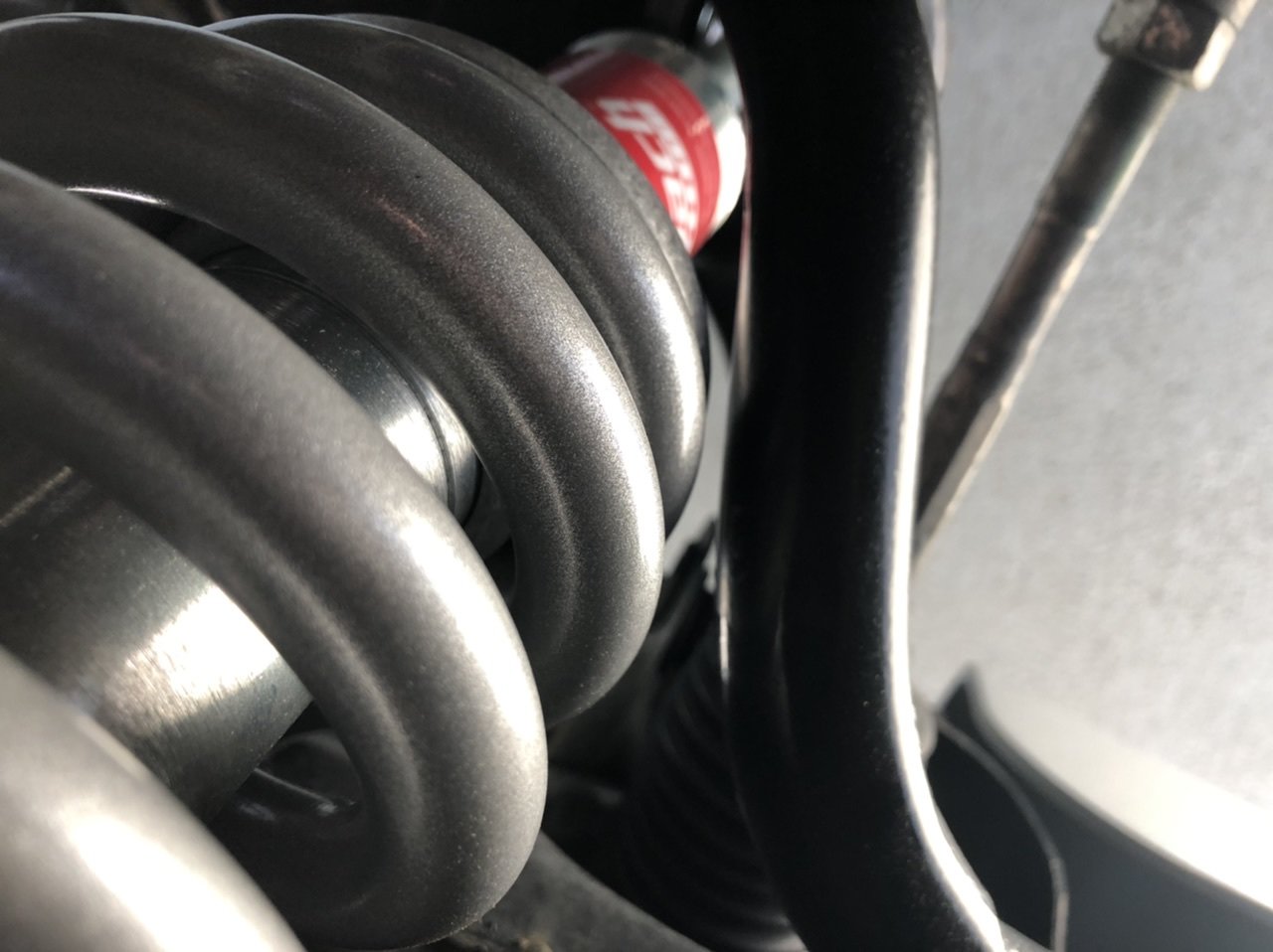

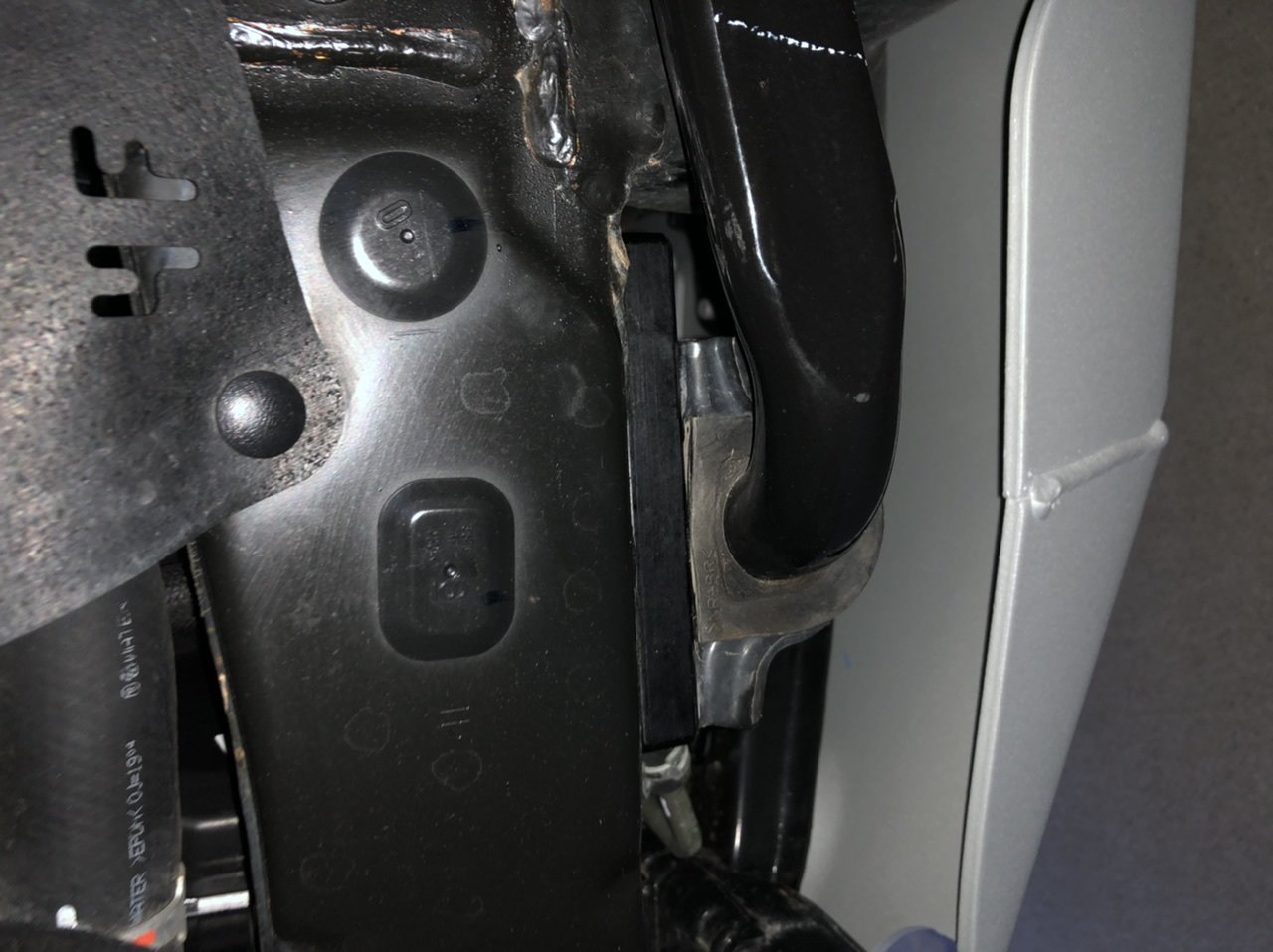

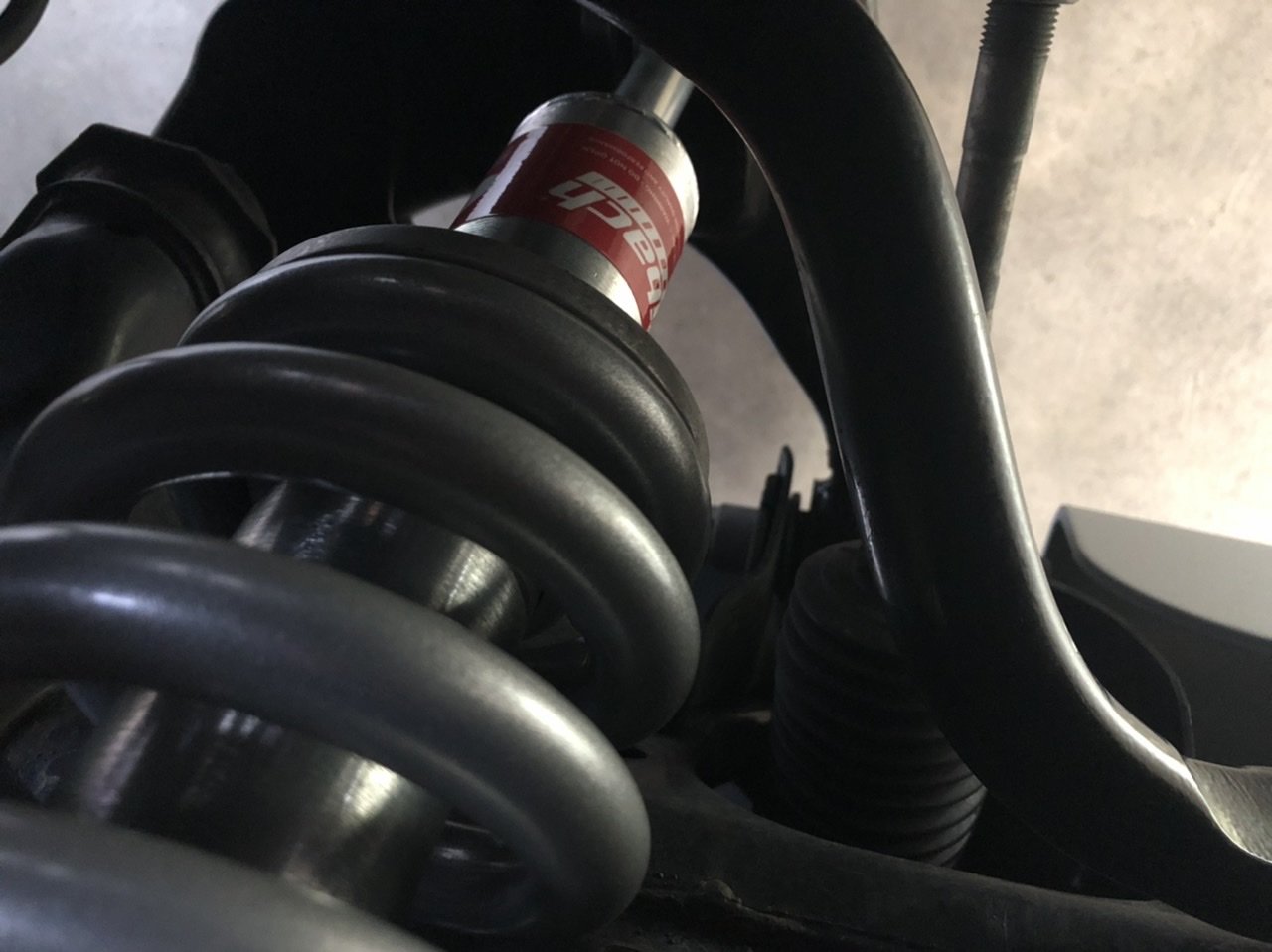

    Just installed a set of Icon sway bar blocks. Toytec advised that I didn’t need them with this lift kit. I probably would have been okay most of the time, but the sway bar was less than 1/4” from the spring perch.
    Not sure why, but my photos keep getting randomly rotated when I upload them...
    Before
    After

    Something doesn’t look right. Is that with your tires on and the truck sitting on the ground? I didn’t use any sway bar blocks.

    yes, but it looks weird because when I upload pictures on here it randomly rotates them.
    like I said, I probably didn’t need them because it technically wasn’t touching, but it was very close and I had already ordered them, so I put them on. Now there is plenty of clearance.
