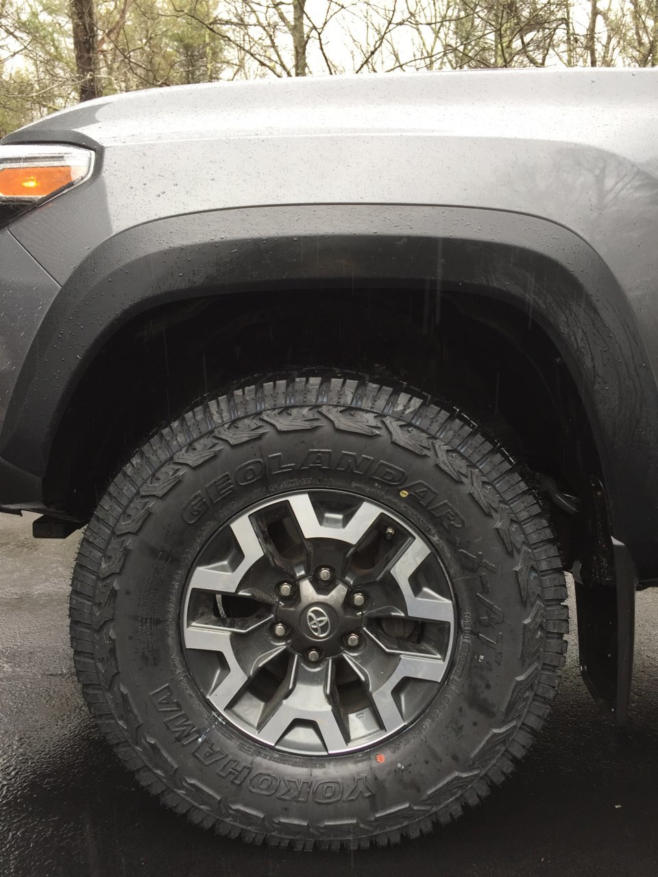

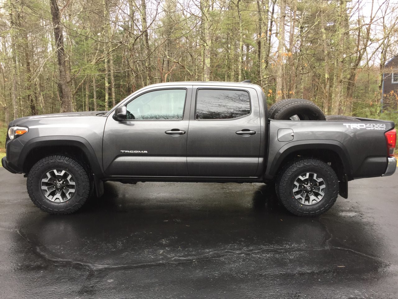

    I have been reading this thread since the Eibach kit looks like a great option - I would like to hear more about how it performs off road too.
    I just had the Yokohama X-A/T 265/75r16 put in my stock truck and like them so far. They look good and from what I read should perform well. Not a lot of people have these that I found.
    @71tattooguy what pressures are you running? I’m trying to dial it in so that I don’t kill the tires.835D361B-3C8C-4675-BB70-F2892F2A3B3F.jpg

    Awesome bro. I chose the other side for side wall pattern. Love these tires. I’m running 30 psi seems pretty good

    Thanks for the reply - about 30psi is what my chalk test showed - I didn’t believe it based on everything I have been reading including tire charts. I was expecting 40 or more.
    I think these tires/this size will look good with a 2” lift. I have been liking what I see here with the Eibach kit - keep the info coming! Only can read about it until the budget opens up!

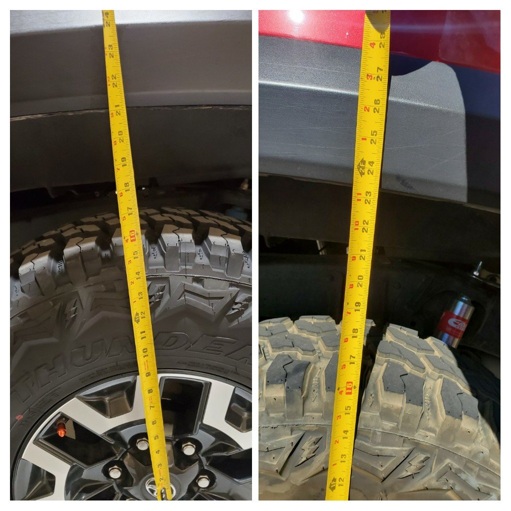

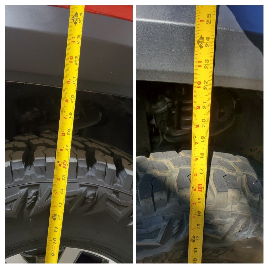

    I got my Eibach kit installed yesterday. I gained about 2.25” lift in the front. Very pleased with everything. I’ve only put a few miles on it, but it rides much better than I expected. Once I get my wheels and tires on and have it aligned, I’ll post some pics.

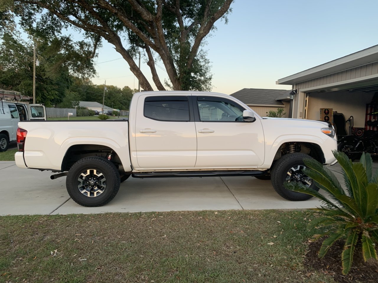

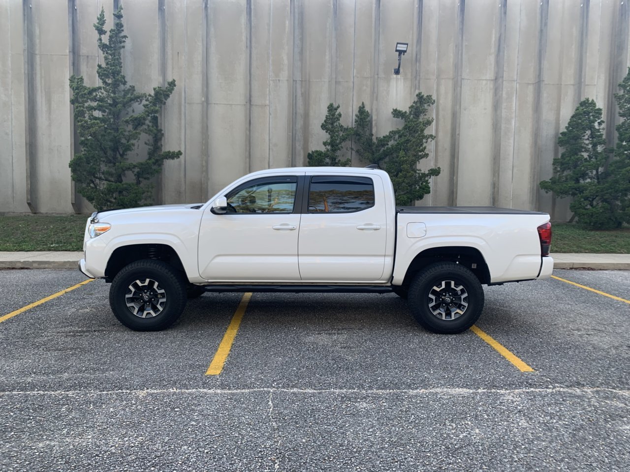

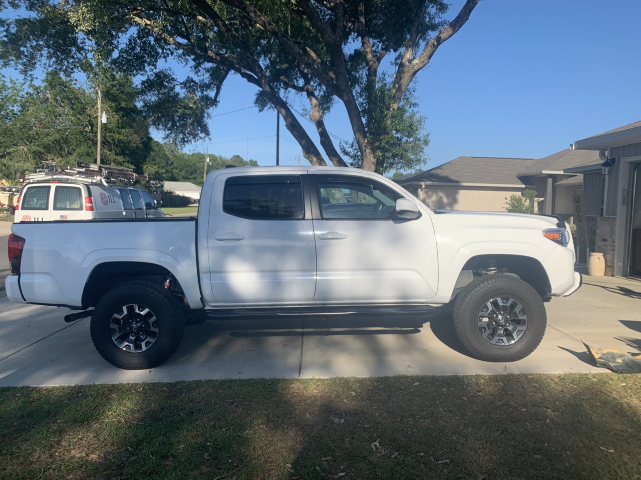

    I installed my lift this past Saturday, went with notch 2 because of my cbi hidden winch mount and Smittybilt winch syrup and HS 3 leaf AAL in the rear. The truck was fairly level but I didn’t like the lack of rake. My theory is that the winch combo setup I have is only about 100lbs so my front was too high. Anyways, I decided to put my over load leaf back in today and it cleared everything up for me. It was well worth it. Kinda hard to tell from the pics but I noticed. The rear measures 38 1/2” now. First pic before, second is after overload back in.

    Another before pic, no after yet. You can see it’s a little nose high.

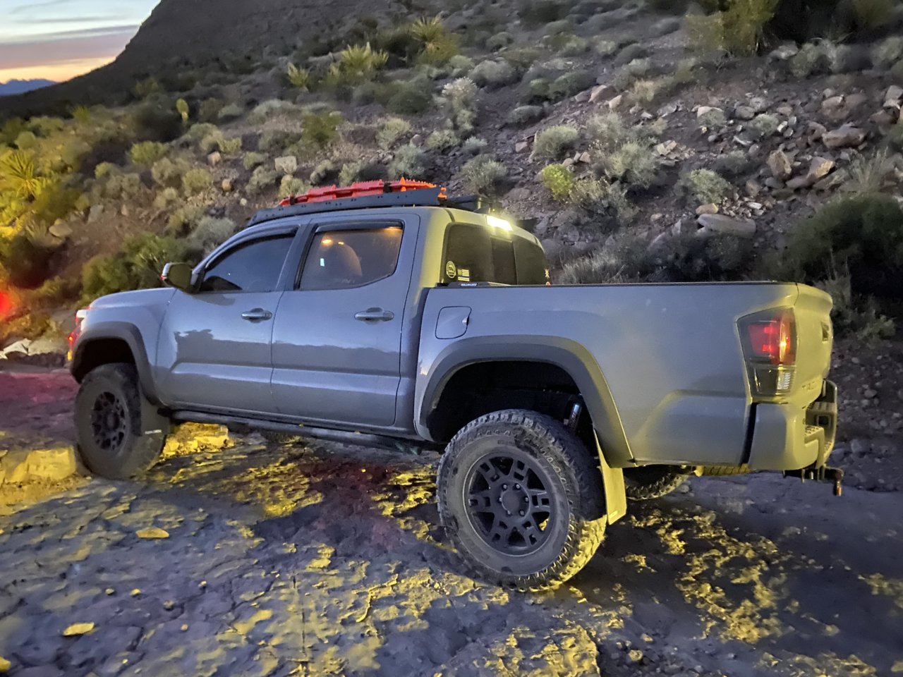

    Made it off the trail tonight without breaking anything. Handled great and was very controllable over the rougher stuff.

    Nice! Which trail?
