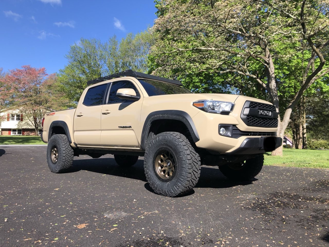

    Eibach pro lift installed. shocks set to middle notch (supposed to be 2.5” of lift) With Headstrong single AAL (supposed to be 1.5-2” of lift)
    Tires: Nitto Ridge Grappler 285 75 16
    Wheels: matte dark bronze scs ray 10 16x8, with spidertrax 1.25 wheel spacers
    Only drove it home from the shop so far but no rubbing at all and very pleased with the ride quality. CMC and plastic trimming we’re necessary especially with the wheel spacers.
    With all The old suspension components, 5 tires, and 4 wheels still in the bed the truck sits perfectly level. Guess it will have a slight rake once the load is removed; which is exactly how I was hoping it would turn out.
    Here is some rainy day pics of the final product!
    Just unloaded the bed and took some measurements
    Rear ground to fender measurement after lift:
    Front ground to fender measurement after lift:
    Couple more pics with better lighting:EA4770B1-861B-43CC-8394-4554EDF328B2.jpgB2C114E2-6176-4F1D-9FE8-3EEFB3ED715C.jpg
